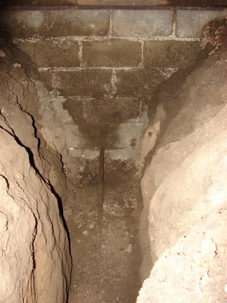

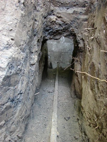

    I'm finally started on my first of many plumbing projects (replacing the water main). Just finished digging out the line under my porch, that was interesting......

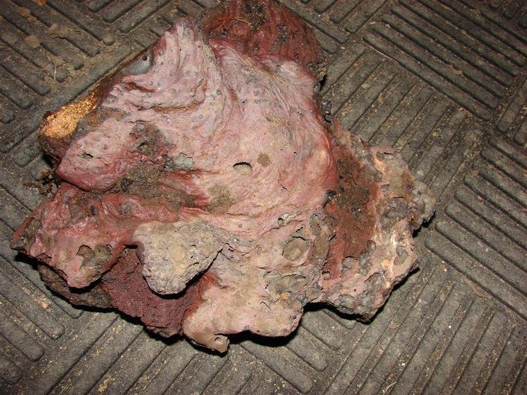

    No such luck, but I'll let you know when I find that treasure chest....About 4' down I did find evidence of an old lave tube...Check out this photo.

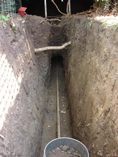

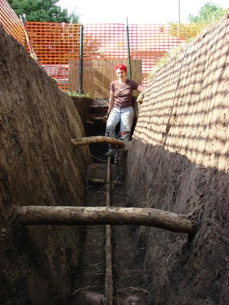

    We just finished up the excavation, wow that was fun......Tomorrow we run the new copper!

  13. May 13, 2012 at 9:15 PM
    #333
    acdronin
    acdronin Well-Known Member
    Dec 2, 2010
    #47036
    19,635
    That's a good lookin trench man

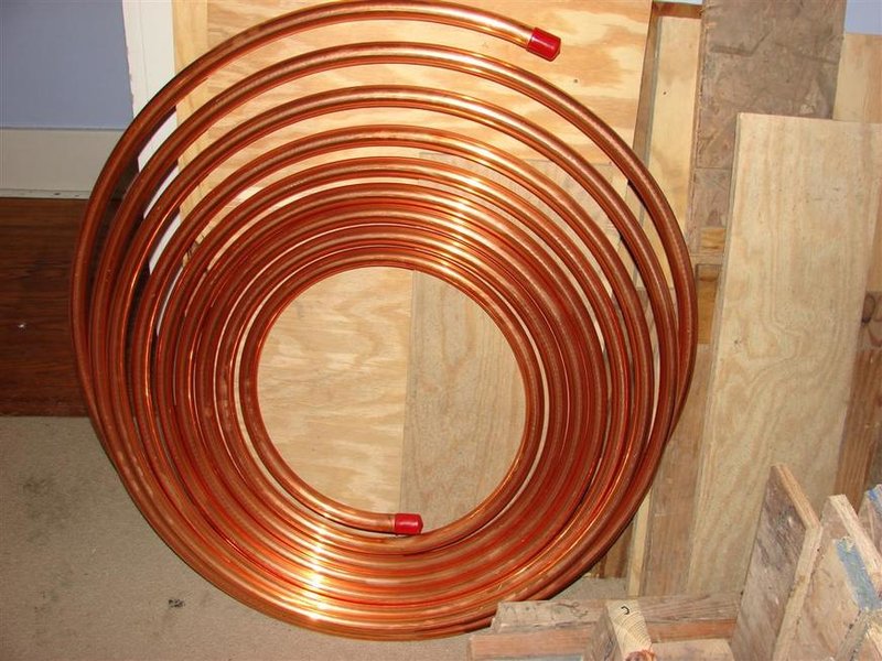

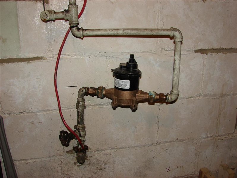

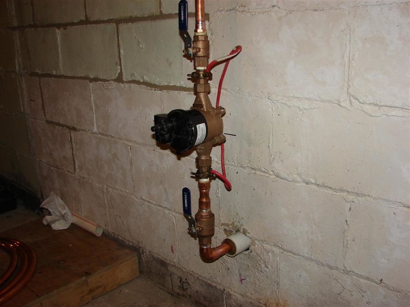

    Thanks, for all the good advice. And check it out, we be in business :)

  15. May 14, 2012 at 9:31 AM
    #335
    xJuice
    xJuice My spoon is too Big!
    Oct 24, 2007
    #3208
    9,904
    Josh
    N. Texas
    19 Tundra MGM
    TRD Front & Rear Sway Bar, TRD Pro LED Headlights, Undercover SE, Rear diff. Relocate, console organizer, debadged, color matched handles, mirror caps, and grill
    Looks much better. good job
  16. May 14, 2012 at 9:39 AM
    #336
    acdronin
    Dec 2, 2010
    #47036
    19,635
    That is exactly the way that I would have mounted and plumbed that, good work!
