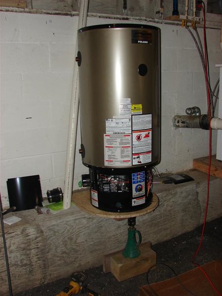

    Awesome, you guys are so incredibly helpful! I've attached a photo of my new water heater. The plywood that is supporting the heater is temporary, and will be replaced with concrete once I'm sure of the location ( I won't be able to move it obviously once I pour the concrete). So I'm trying to get the rough in finished first.
    Thoughts and comments always appreciated.

    LOOKS LIKE A NICE UNIT..
    WHATA U GOT GOING ON TO THE RIGHT OF IT...WITH THE FERNCO AND 2" GAL CAP?

    It's a Polaris 97% high efficiency, 34 gallon, 100,000 btu model. I've heard a lot of good things about it. I'll be using it for dhw and radiant heat via a heat exchanger. The galvi you see is my sewer drain, the 2" part used to go to a sink, which filled up occasionally when it rained a lot. Glad to have it out ;).
    At some point I'm going to excavate down on the outside around the pipe, cutoff off the pipe a few feet, install an exterior clean out and run new pvc pipe in.

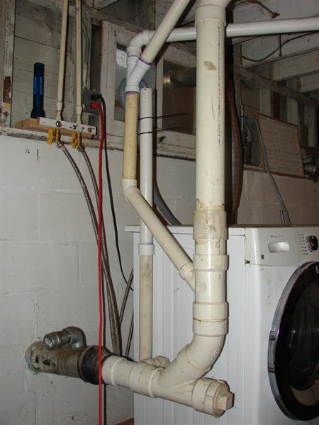

    Here we go, sorry for the confusion. My terminology/communication is not so great. I like to say that English is my second language, and I don't know what my first is.....;)
    The clean out is on the end of the horizontal pvc. The plumbing is hacked together from 100 year of mods. I plan to rip it all out as soon as I get my basement floor poured.

    The 4" pvc is the drain for the bathroom and is also tied to the main/only vent stack.
