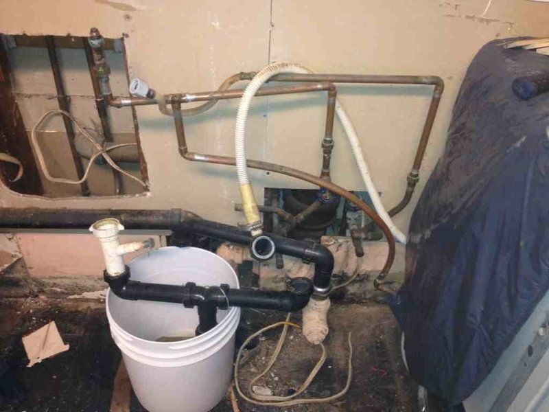

    What should i do with this....
    Just kidding, i had to install base cabinets around this! Shitty stupid insurance jobs, plumbing wasnt in the scope of work so we pretty much couldnt touch it. Just cut the whole back and part of the bottom of the cabinet out :hackjob: had to take a picture for my buddy who is a plumer to show off this fine craftsmanship. Oh and it started leaking just from looking at it, so we did hafta call a plumber, the solder was the worse i have ever seen
