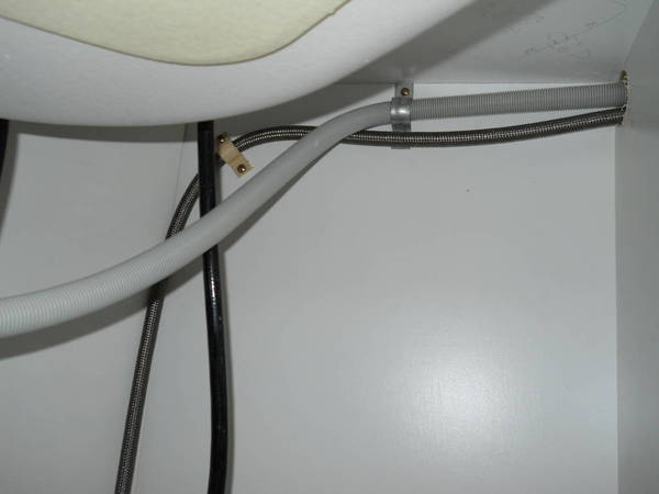

    So its not actually connected before a trap? Can ya post a pic?

    The drain hose from the dishwasher either needs to connect to an airgap on top of the sink, which then connects to either the garbage disposal, or a fitting where the GD would be mounted if there was one, OR the drain hose needs to come up to the very top of the cabinets, just beneath the top of the sink flange, and then go down and connect to the GD or fitting. The key is that the nasty water from the sink drain or GD would have to travel uphill to get into your DSW. Take away the airgap, or "high loop", and you have a stinky dsw.

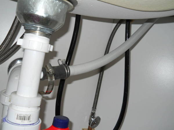

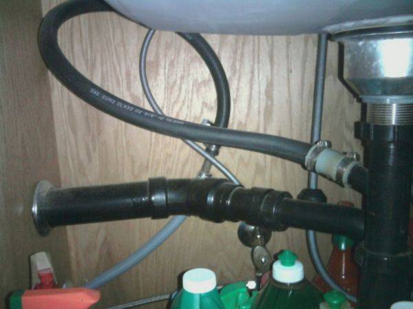

    Here's what I've got:
    Any comments / help would be greatly appreciated. My wife is constantly yelling about this'll

    Thanks! I thought maybe it was just cause we weren't running it that much since it's only the two of us. I've been running it more often but it doesn't seem to have solved it. I guess if worse comes to worse, I could replace it, but it's a Bosch and seems like a good one so I'm reluctant to do it.

    It's plumbed right. Just run an empty load with a bunch of vinegar.

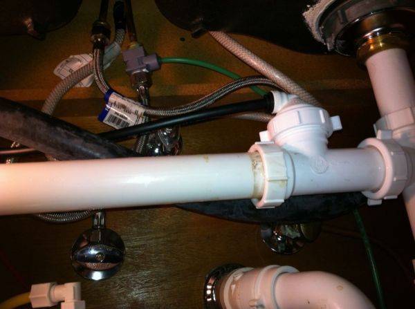

    Hi guys, I have a quick question. I was installing an Ro setup under my kitchen sink yesterday, and I noticed I have 3 shutoff valves under there. One for hot, one for cold, and one that doesn't have any hoses attached to it. What's the third one for?

  7. Nov 26, 2012 at 9:16 AM
    #467
    acdronin
    acdronin Well-Known Member
    Dec 2, 2010
    #47036
    19,635
    That would be my guess if it's a cold water line

    Depends if its on the hot or cold line. Cold would be for the ice maker. If its on the hot line it would be for a dishwasher.

    Hard to say. The valve on my fridge is in the wall behind the fridge. Pics? Could it be for your dishwasher? Is that near by?
    May even be there for the purpose of hooking up an ro system. :notsure:

    How can i tell which line its hooked to? Close either the hot or cold and see if water comes out when I open the third valve?
    There is also a shutoff valve behind the fridge.
    The dishwasher is indeed nearby.

    Here's the shot of the extra shutoff valve:

    Hard to tell since all 3 are spread apart. I mean usually you have 2 on hot side,one above the other.
    You could run the hot in sink until its hot,then check the extra angle stop. Open it with a rag over it into a bucket. It won't take long if its a hot pipe.
    I've plumbed houses with hard and soft water at kitchen sink.
