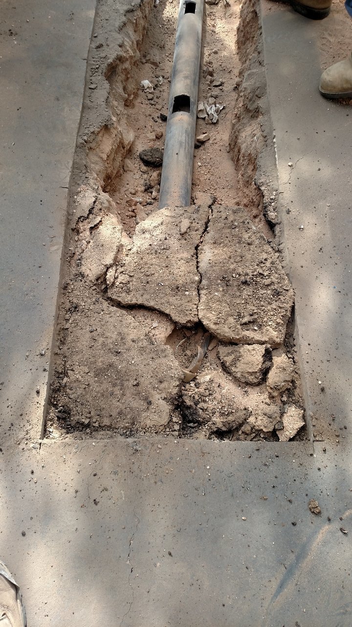

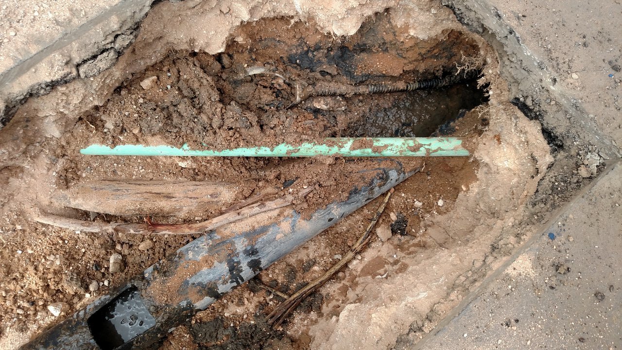

    Here's a good one of what happened when a snake exits a broken sewer line. This line was thinwall abs that had been broken by an olive tree root.IMG_20170912_153618862.jpg IMG_20170912_160616260.jpg

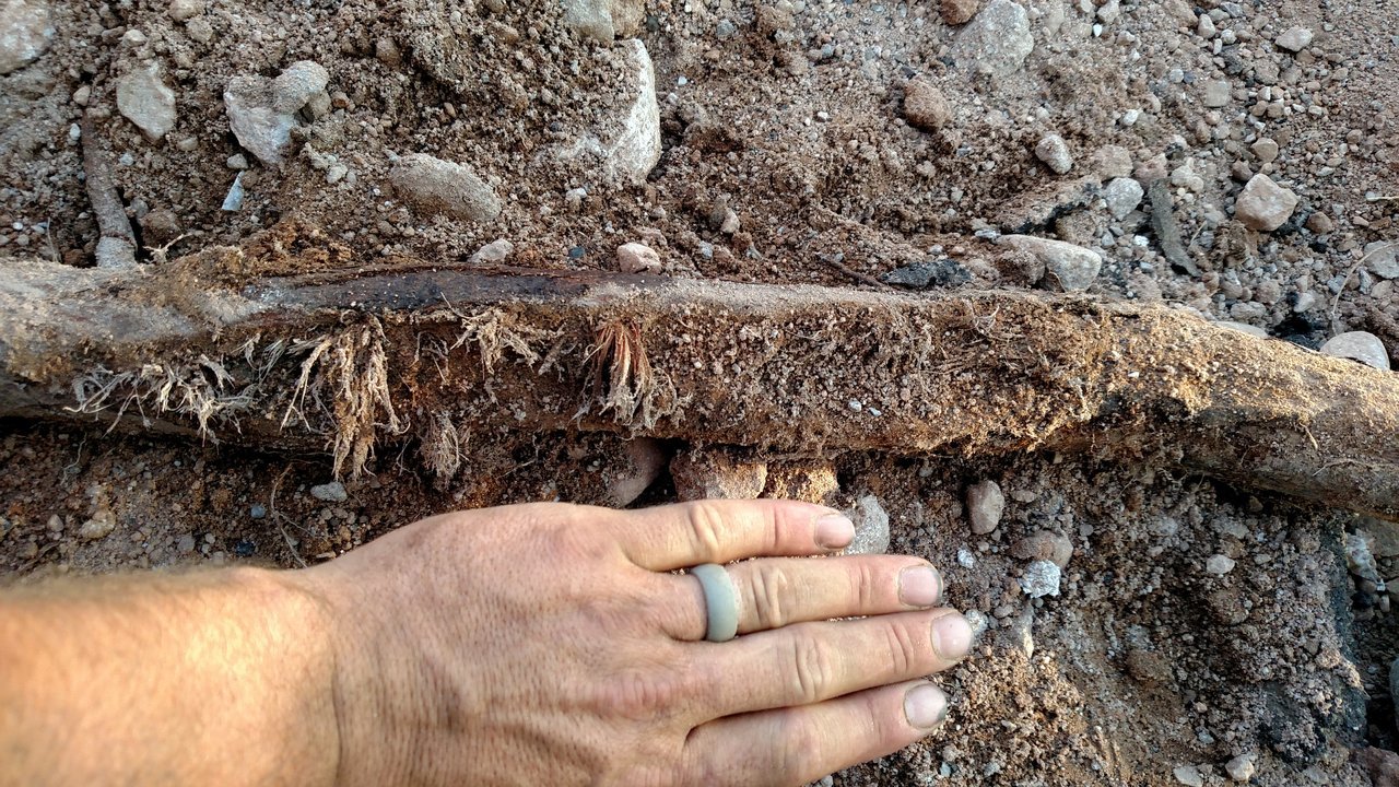

    Here's the root. You can see where the snake chewed it up along the top.IMG_20170912_173332069.jpg
    Most of my pics are after I've made the repairs. I don't take many of the mess I find when I show up.

    I don’t come across thin wall abs often,just out in country and it’s usually crushed

    Yea, it's was legal for a short period of time here in AZ so there's thinwall pvc and abs scattered around the city. Thankfully they got smart after a few years and quit allowing it. Alot of the lines that have it have become flattened but not broken yet so you can only get a 3" head through a 4" line. Its all junk.

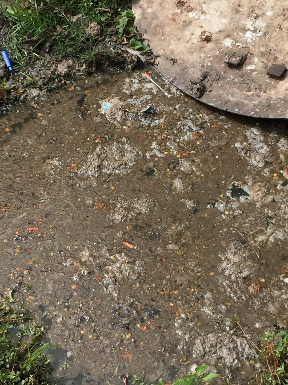

    90616E7A-B5EE-4B22-8CCC-49992D860463.jpg Here’s a lift station where both pumps went out. For all the newbs, enjoy your breakfast :rofl:

    Lmao. Guess so.
