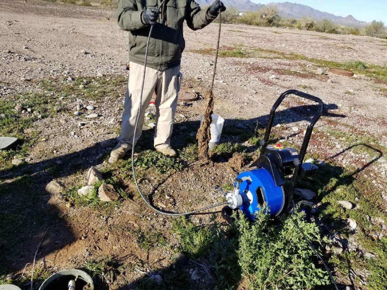

    Where I work we have rv dumps and have had problem in years past with things like this clogging the box trap screens. Our cure was to install catch bars where the rv hose goes in. Now when something large like that is dumped, the bars usually catch it and the person dumping gets wet feet when it backs up. The concrete slabs are tapered to the inlet so the mess stays contained.
    We've found just about anything you can imagine in the box traps from rocks to silverware to adult diapers to clothes...even the "slinky" hoses they use to transfer their tank contents.

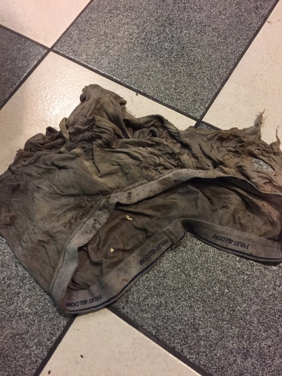

    708F19DA-C816-4889-8A3C-1F40B0E4AE09.jpg Pulled this out of movie theater
    Had to pull toilet,bust wall and cut into vent

    Wet wipes (baby wipes). There's another little pile next to it. All told there was about 2-3 gallons of them we pulled out of a screen box and what found their way through the screen to the Y pipe between the screen box and the 2 septic tanks. They totally choked the pipe. Even found an electric hair trimmer in the screen box which is totally appropriate since we also pulled out a ball of hair about the size of a softball. This is all stuff people dump out of their rv tanks.

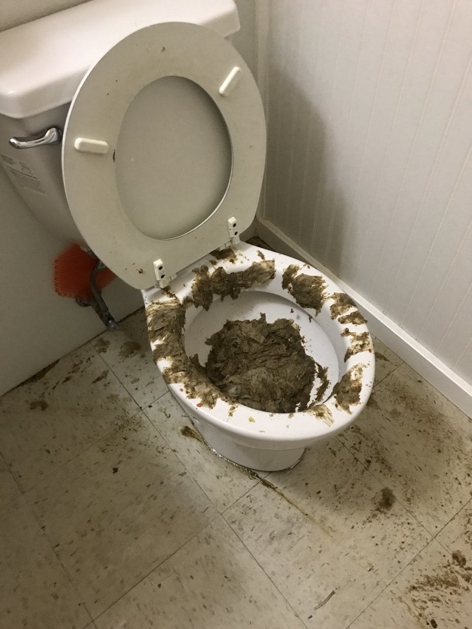

    If the second pic is after you were done, then......
    Good job :thumbsup: :rofl:

    Looks like a 1/4 turn valve? Much better than the alternative.
