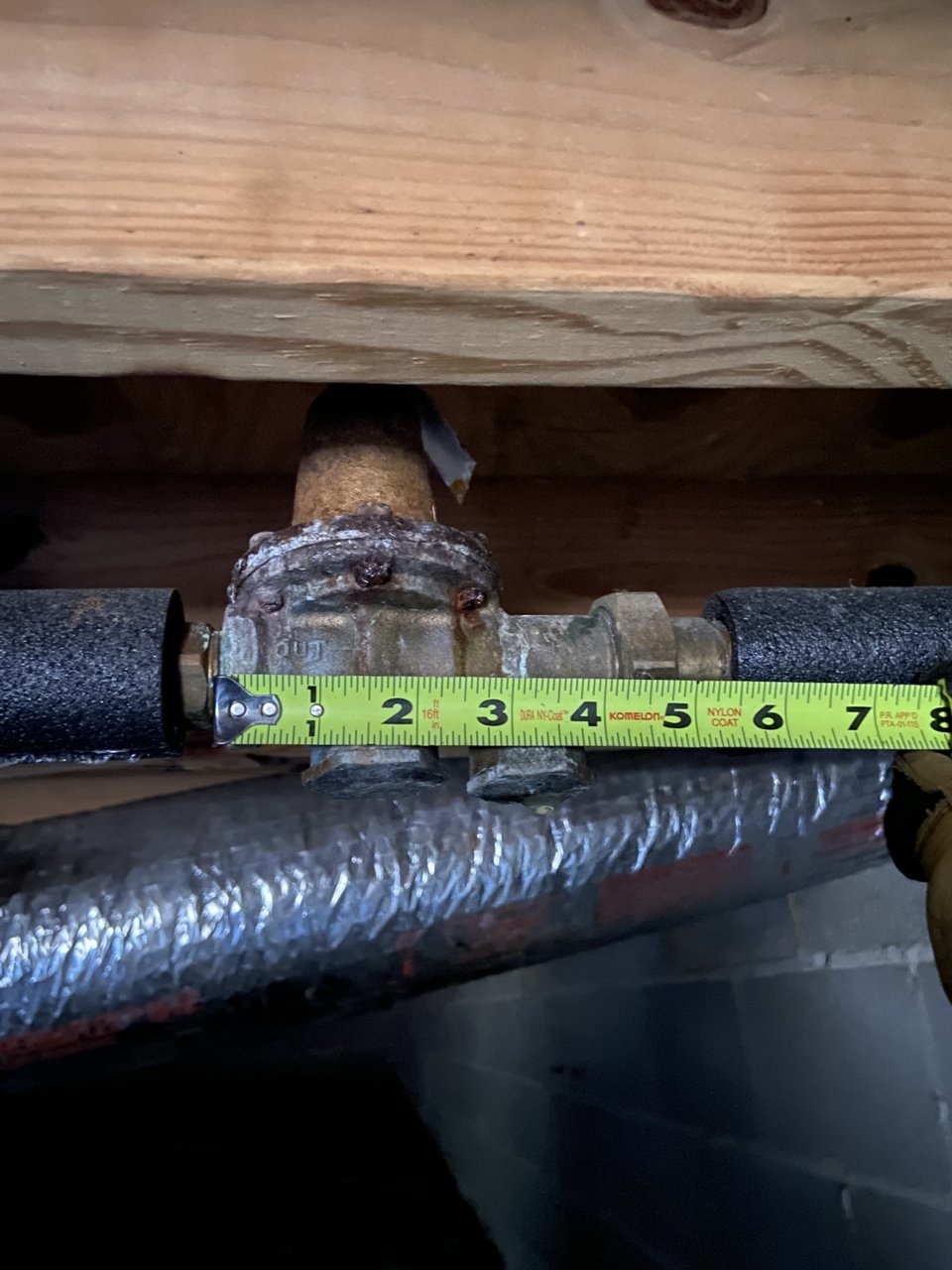

    Just bought a house and this thingy is leaky (pressure regulator?). Is this something I can fix myself fairly easy? Tips?

    can you solder?
    Need to just replace it.
