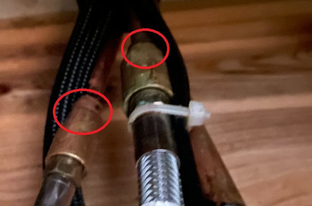

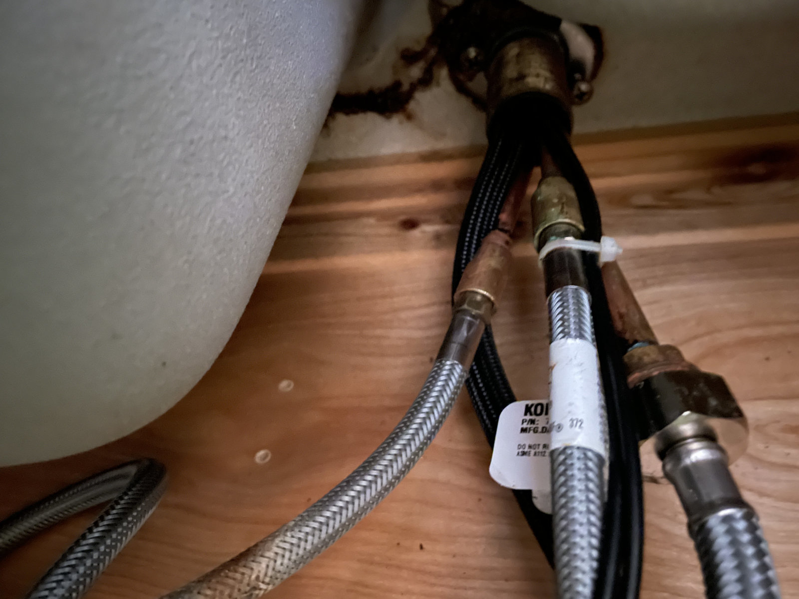

    Its been a while since the last post buuuuuut someone might know the answer... Insurance did an inspection and said that we needed to replace the supply lines to our kitchen sink otherwise they were going to cancel our policy... I went to replace them, found a fitting that I hadn't seen before on my other sinks and she didn't want to turn very easily. I took a picture and sent it to a HVAC tech that does some plumbing on the side and he said that these were pressed together so in order to replace the lines, I need to replace the faucet. is that a thing that we're doing now? to sell more faucets? I'll attach a picture. it looks like I "should" be able to thread it off but I didn't want to put too much pressure on the copper lines unless I was sure. I'm referring to the female copper fittings onto the male braided lines. Thanks in advance.

    the far right one? You can unthread that one, just need to put a backup wrench so you wont twist off the male and break the copper line above it

    As far as the silver lines go it’s the center and left one. The female threaded line on the right apparently is fine…

    Those are two separate lines, correct? - not a loop line?

    there's also a reverse osmosis water system under this sink which is why there's a bunch of extra lines all over.

    Feel around these female fittings - are they perfectly round? or do you have flat sides to allow a pair of pliers or croissant wrench to grab for backup?

    I don't think these were pushed in - they MUST'VE been threaded in.

    they have flat sides. all of my common senses say that they can and should unthread, but that one plumber saying that Kohler presses fittings on these has me not wanting to put too much pressure.
    We haven't moved into this house yet. its still being rented out and I don't want to leave them without water in the kitchen while piecing things together at the store, in case I can't find everything id need.
