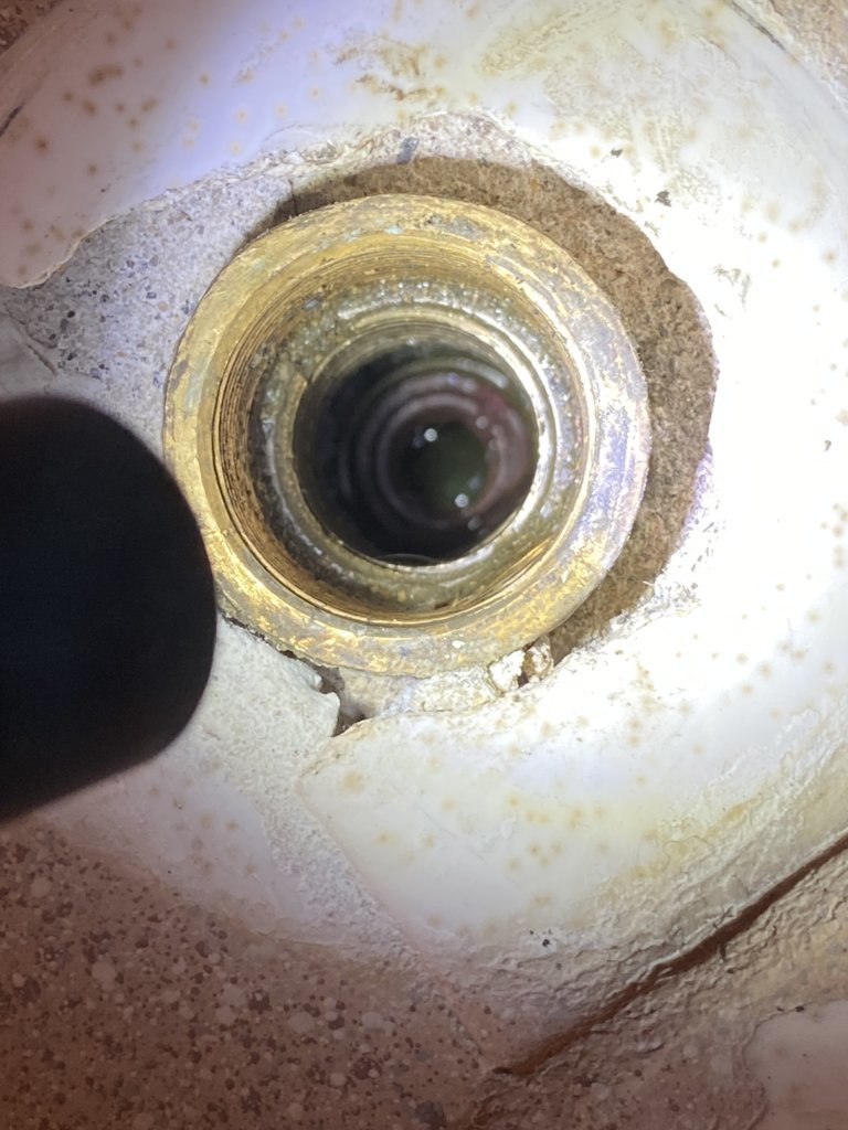

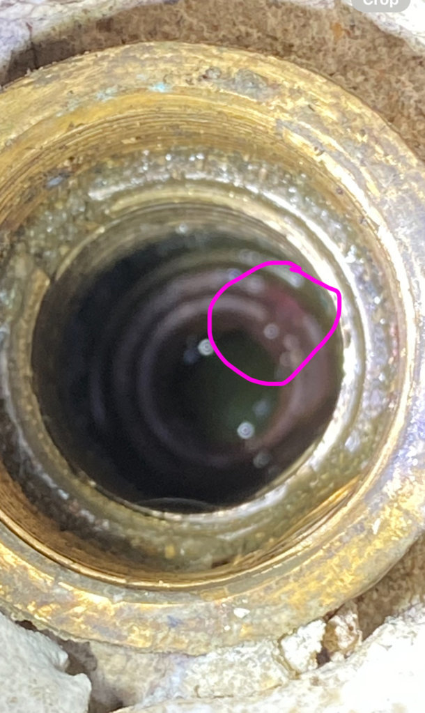

    Hopefully I name the parts correctly, the issue I’m have is in my shower hot water handle, I’ve had to replace the flat washer probably 6 times in the last 14 years but now it looks like the valve seat is damaged, I’ve tried to remove it but not applying a crazy amount of force, it looks brass and I’m thinking I’m in big trouble if I strip this or it cracks. Any suggestions on how to get this thing out??? I believe it’s original from the mid 50’s but this seems to be the only issue

    Somewhere, I have a set of valve seat wrenches. The hole in the middle of them is usually square and the wrench fits in there to remove it. Good like finding a new one.
    Come to think of it... I think it's a single wrench that's stepped.
    https://www.amazon.com/PP24005-FAUCET-WRENCH-6-STEP-DESIGN/dp/B000VYH9WW
