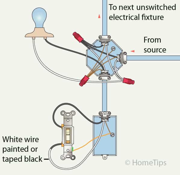

    I’ll start by saying that although I am fairly handy in most cases, I do suck at electricity…
    - So I need a power outlet in my basement.
    I have lights, but no outlets. I have access to a few wires, but due to insulation, it is not easy to ID what the wires serve up above so I cannot tap into an outlet above.
    I have a switch by the basement entry. I figure this would be a good source of power, so I put a junction box and tap into the wire about a foot before the switch - I figure that I will alway have power for the outlet.
    I tap into wire at that location, Matching neutral to neutral, ground to ground, live to live with a 3-wire connector each time.
    I make my run, and wire the outlet at the desired location - white wire to silver crews on outlet, black to gold, copper ground to green screw.
    The run is some 25 feet. Looks great. Breaker now back on. I put a plug in and nothing. - Lights (LED bulbs) do work fine as before.
    The outlet does not power something plugged into it…
    With multimeter, I see I have 120v between neutral (white) & ground which seems odd… No voltage between white & black.
    I read that reversed wires will cause this. But I don’t see my wires reversed…
    I don’t know what I’m doing wrong. - but I suspect it is something stupid.
    I disconnected the outlet and taped off the wires.
    I’d appreciate any insight. Thanks!

    If there is only one cable going to the switch then you are mostly likely dealing with what is called a switch leg. You wouldn't have a neutral at this location. Normally in this case the 120v is coming into the switch on the white conductor, this is a constant feed. The black is the 120v load side of the switch, feeding the lights.
    If you can find the junction box where the switch leg originates, there will be a neutral in there. That would be the place to tap this circuit to add a plug. A good place to look would be in the box feeding the nearest light fixture. You can easily identify the switch leg by looking for a black wire(s) spliced with a white. Any neutrals in the box would be white conductors in a separate splice.
    If you have older bx(steel) cables in your basement I would not recommend doing any of this yourself.

    Also, if they followed code, you’ll notice black electrical tape on the white conductor in the switch box.

    Agree, wiring probably looks similar to the image below although the source doesn't have to come in at the same box the lamp is located.
    A better job and maybe easier is to run a new circuit with a dedicated breaker.
    Make sure to get the correct breaker for your panel, the same brand and the following the type information found on the decal on the panel door. Stated another way, just because an Eaton breaker "fits" in a Murray panel doesn't make it correct.
