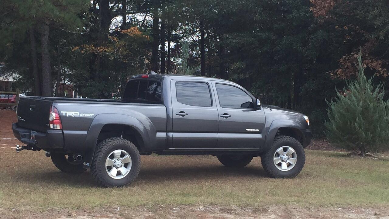

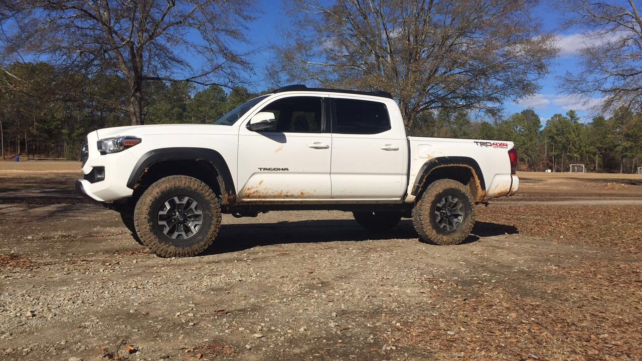

    9E0529AC-E08E-4693-84BD-856945239CDC.jpgNew 17 how it currently sits 891D27D3-D26C-45D3-9CD1-A0039E51FF01.jpg Old 15’
