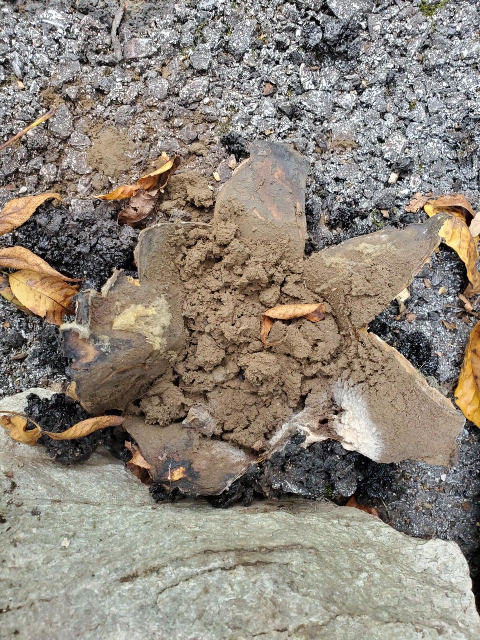

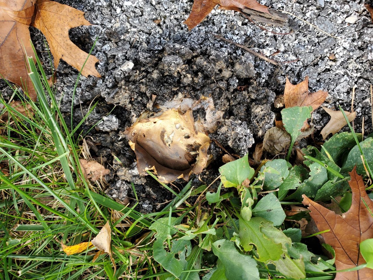

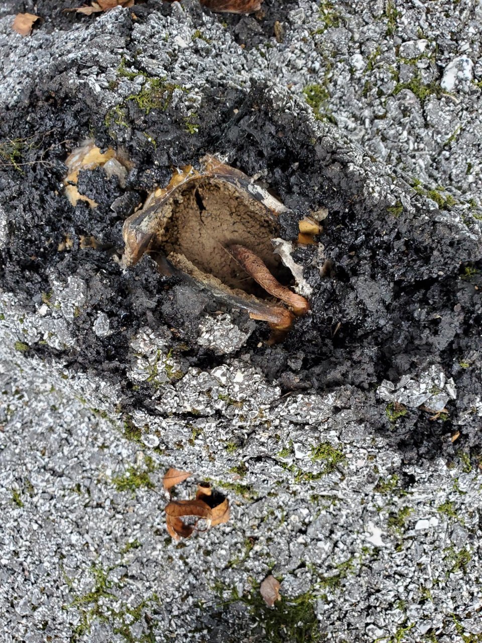

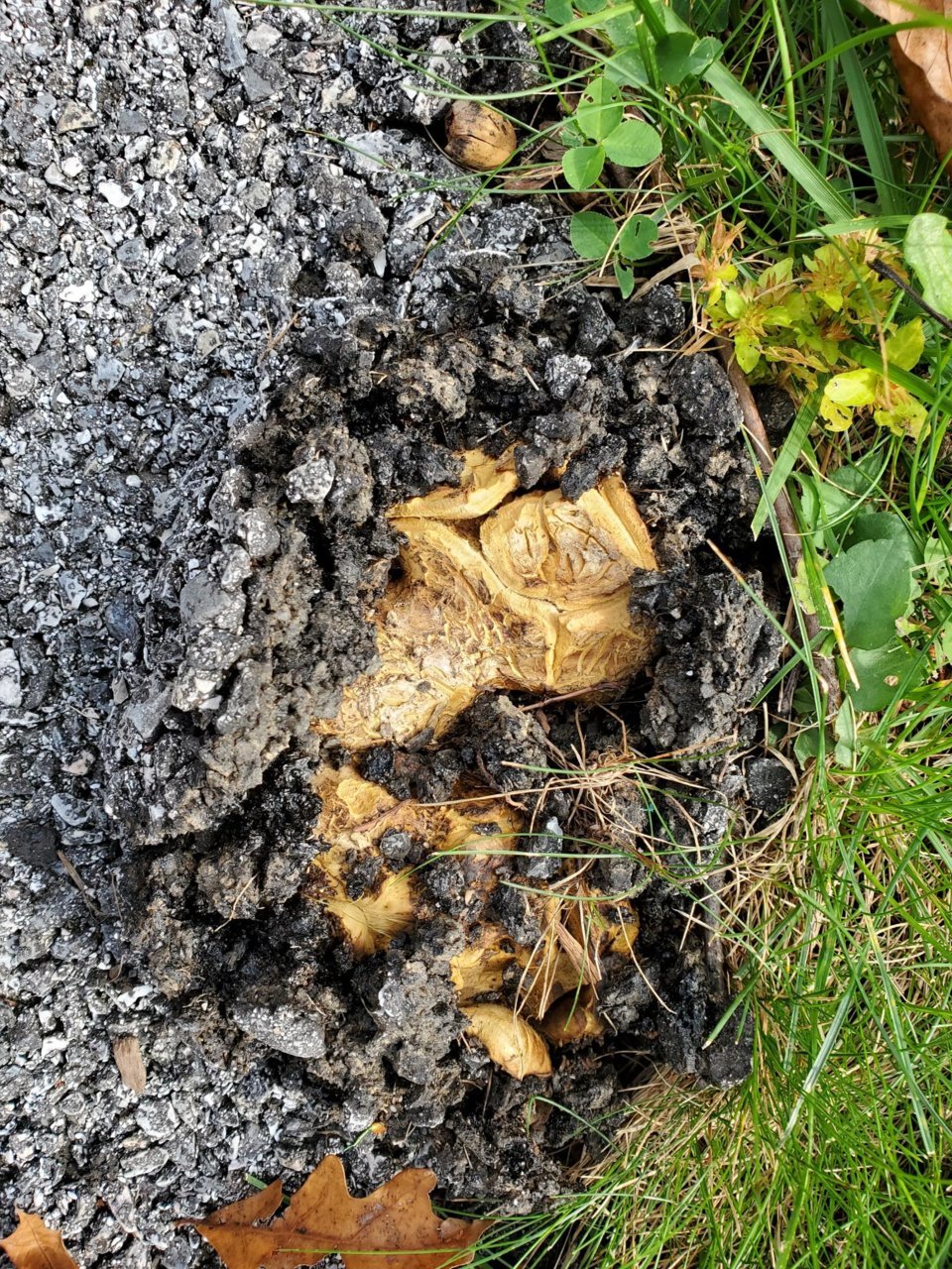

    Had my driveway paved about 5 years ago. About 2 or 3 years ago I started getting these little bubbles in it. They grow over about 2 months and will then eventually burst. They look to maybe be some sort of seed pod, but I'm not sure. Anybody ever seen this before? I'm in south central PA if that helps. Just hate to dump another couple thousand dollars to have the driveway torn up and redone if I don't know what's causing the issue.

    It’s a mushroom, google earth star

    Now to research the heck out of them and see if I can figure out how to keep it from happening more. Thanks man.
