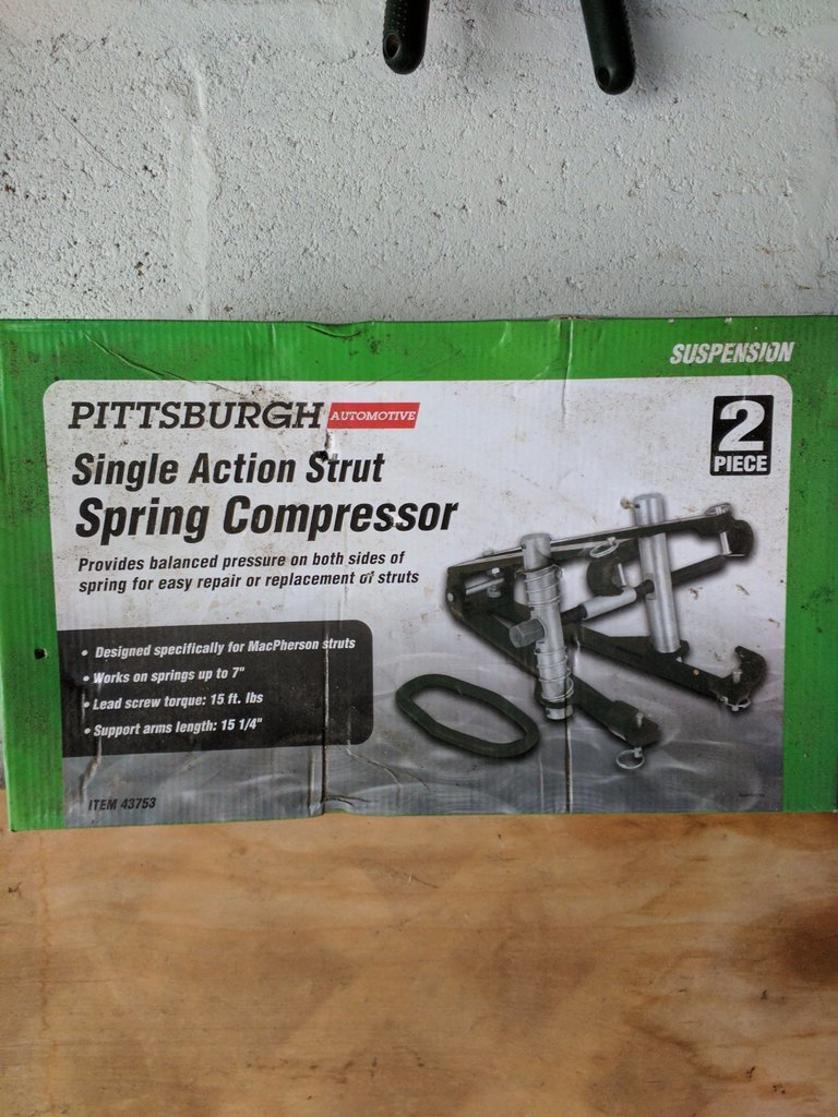

    If you already have a spring compressor, why not save the $$…? I had the 2 piece compressor and was always leary of it so I bought this from harbor freight when I replaced my struts. It works like a dream.
