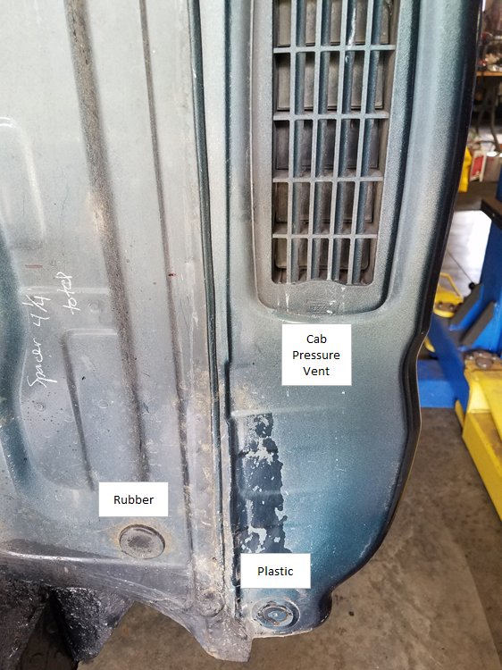

    Appears to be hard rubber. Not sure if all the Tacoma's have them or just the dbl cabs. The one I replaced was near the bottom on the passengers side, so it took more a beating from the elements. The remaining ones are fine.

    thanks,
    i have been chasing some weird cabin vibes that MAY be due to pressure issues
    open the door & something random pops somewhere, maybe these are whats causing that gremlin

    The plugs aren't for cabin pressure. The vent above is the vent when the doors are closed with windows up. It has flapper type hanging rubber vents that release the pressure.
    The other two are just hole plugs, one rubber and one plastic.

    The purpose for these two holes, like almost all of the ones in the body, are for use during manufacturing. The serve one of several purposes: either to fill, then drain, ED coating (think primer) when the body is dunked into and then lifted from the ED tank; or, they are holes used by equipment to align or lift the parts, like welding robots, datum pins to align the parts for welding, hoists to move the parts, etc. After the truck is painted, they get some form of hole plug to keep water, dust, heat/cold, and noise out.
    Here is an example. This vehicle is being lifted from the ED tank.

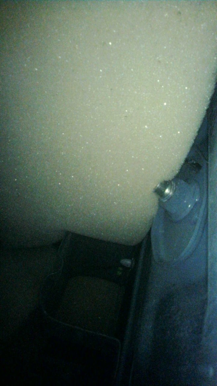

    my plug on the passenger side down there to access the interior rear rockers is NOT plastic, its rubber! removed it yesterday to spray corrosion-free stuff inside the rockers in the rear and watch it oozie on out the drains
    this is what it looks like inside with some foamy stuff on the interior
    but the driver side is a round plastic brittle plug, not a rubber one like the passenger side :notsure: and i did not pry at it with fingers until a replacement is in hand
