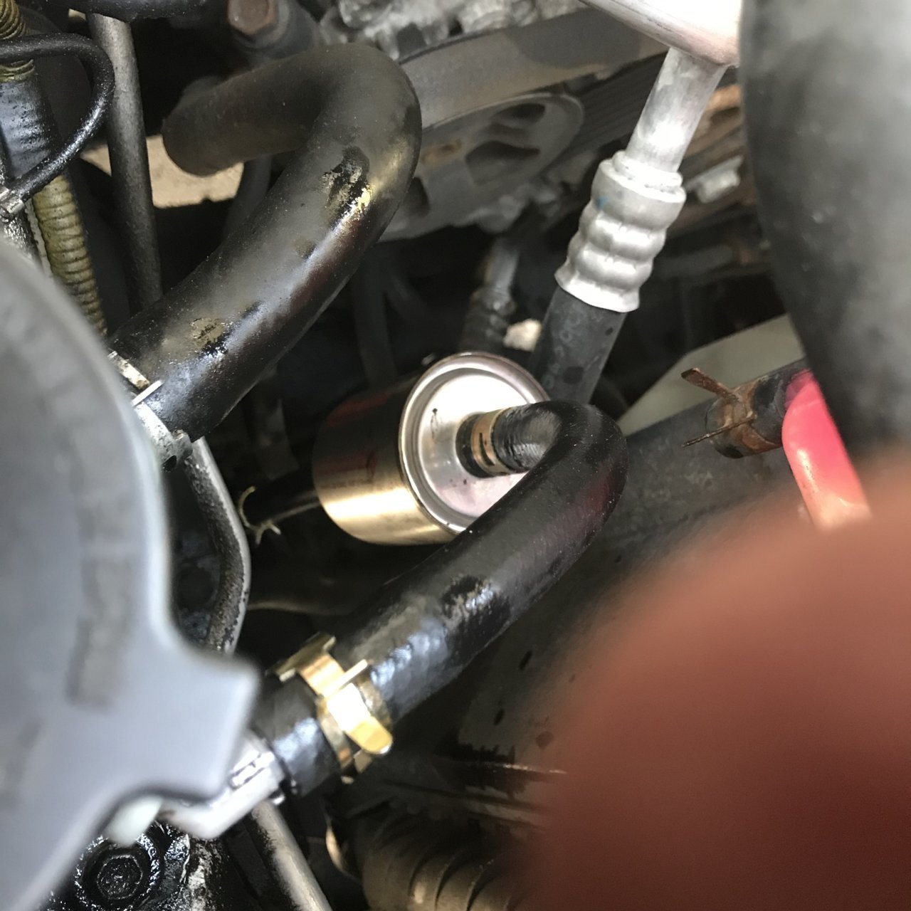

    I did all new lines when I replaced the rack, I used 3/8 hose (ditched the hard sections, fewer connections = fewer chances for leaks and hose doesn't rust) with all stainless clamps. I didn't want to buy an Oetiker tool so I sourced some all stainless hose clamps. Regarding stainless hose clamps, an awful lot of them have a plain screw and just a stainless strap!

    I have a magnefine for both my PS and ATF fluids. Its a low pressure line and never a leak with the OEM style band clamps. And I have 4 clamps in the PS line and at least 10 in the add on ATF cooler, thermostat and magnefine in the PS lines. 10 years and not a single leak. Think these operate at only about 8 PSI
    Super easy to install on the PS return line. Filter $30 , PS rack >$1000
    Read this by engineers John Eleftherakis and Ibrahim Khalil
    https://www.motortrend.com/how-to/129-1002-automatic-transmission-and-power-steering-filters/
    "You can use the Magnefine on power steering systems as well. Installing it on the return hose can significantly increase power steering life. According to Boss Products, it has been especially beneficial to reducing leakage in rack and pinion steering systems.
    We also installed a Magnefine into the return line of the rack and pinion steering and ran it for 552 miles before resampling the oil. The ISO code dropped from a dirty 20/17/12 to a clean 17/15/12. Similarly, when installed into the long-overdue-for-an-oil-change power steering of our '86 test rig, it dropped the code from a filthy 21/18/14 to 18/16/13 in just 289 miles."
    There has to be material to filter out or the number wouldn't drop.
