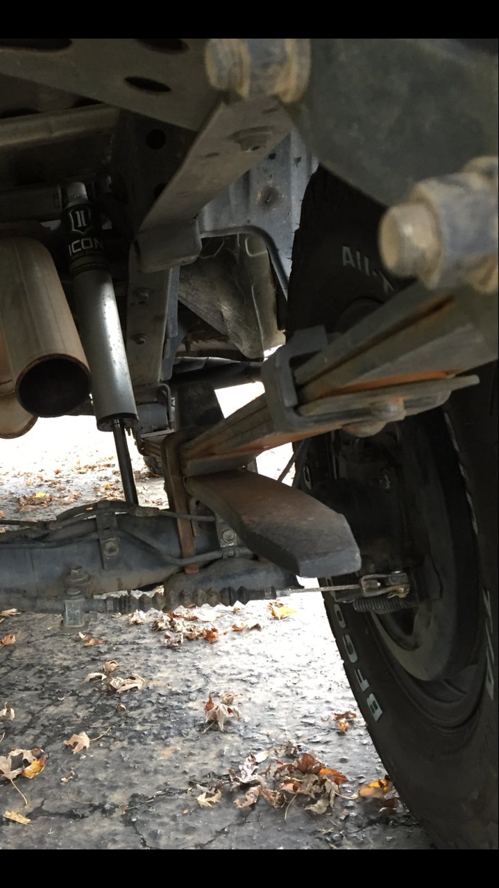

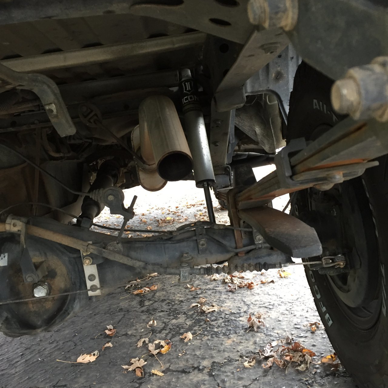

    I had a 1.5” AAL from Toytec that looked like this.
    As you can see the overload faces down while the rest are up
    The AAL is even a little offset lol. Oops
    GQ7227 and jammer[OP] like this.

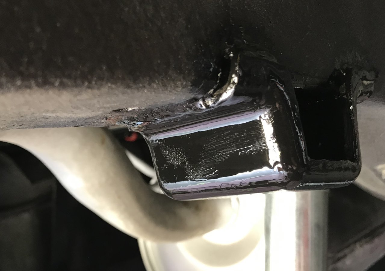

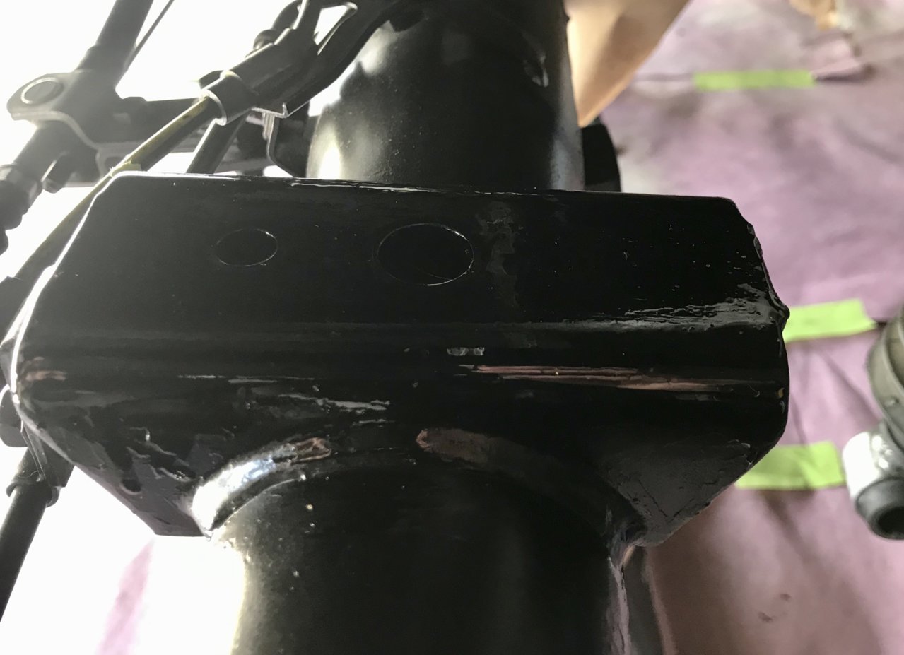

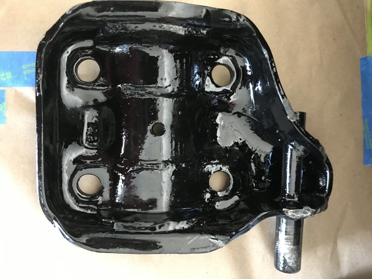

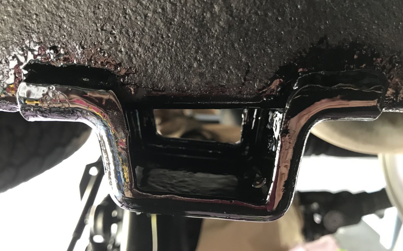

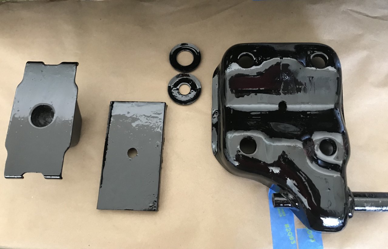

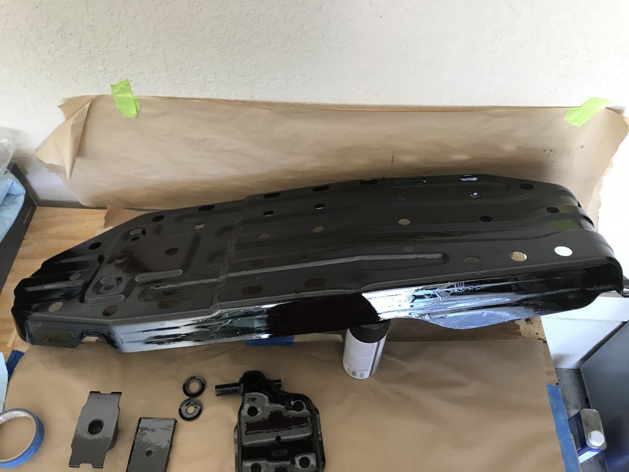

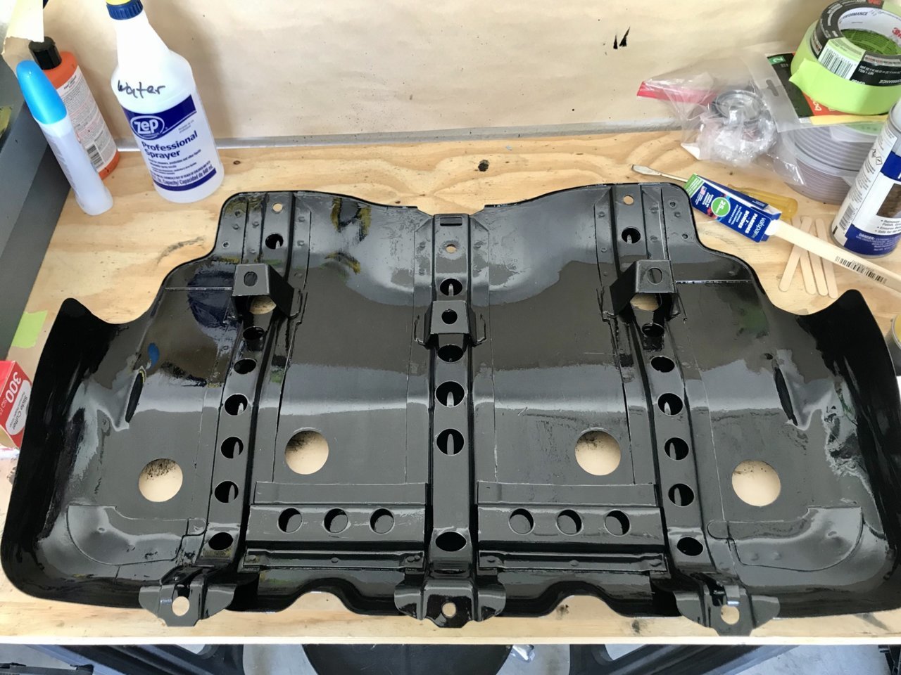

    Some pics of some of the items I used the POR-15 on.
    StevenP likes this.

    Those por-15’d items look great, a helluva lot better than mine haha.. what was your process on them? Did you grind them down to shiny or anything special?
    jammer[OP] likes this.
  14. Jun 4, 2020 at 1:51 PM
    #34
    jammer
    jammer [OP] 2003 Toyota PreRunner 3.4L
    Jan 23, 2014
    #121272
    1,281
    Ben
    Bentonville, AR
    2003 Lunar Mist Tacoma PreRunner 3.4l
    OME Coils/Bilstein 5100's front / 5125's rear 105 Amp Denso Alternator
    Hey Steven, I appreciate it. I stripped them down to bare metal. I've noticed that the small items always come out the best when using Por-15. Even better when using it on something like the hanger because of the roughness of the metal (underside) and rust.
    I know what you mean though, it's difficult to get a smooth finish at times. I've especially noticed this when trying to do a big item like the fuel tank protector. If I were doing it again or doing something like the frame, I'd use a spray gun.
    What has worked best for me...
    • Directions say to put on light coats, but on long items (again the fuel tank), I've had better luck applying as thick a coat as possible the first go around. When I've applied a light coat and then go back to apply another, that's when I get streaks (no matter foam or brush).
    • The rougher an item the better. The more light rust the better.
    • I've always had better luck using a foam brush instead of a paint brush.
    StevenP[QUOTED] likes this.
