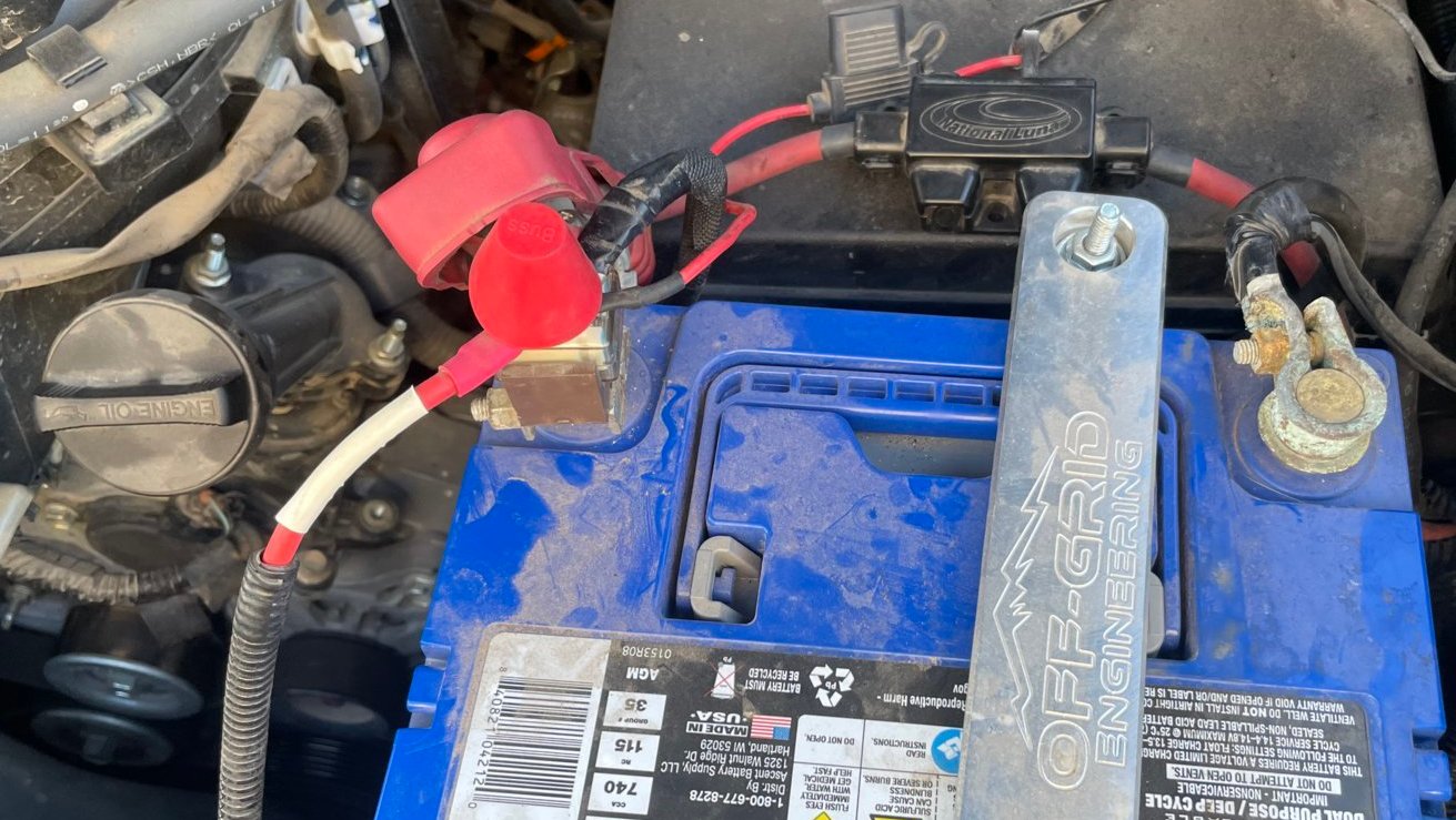

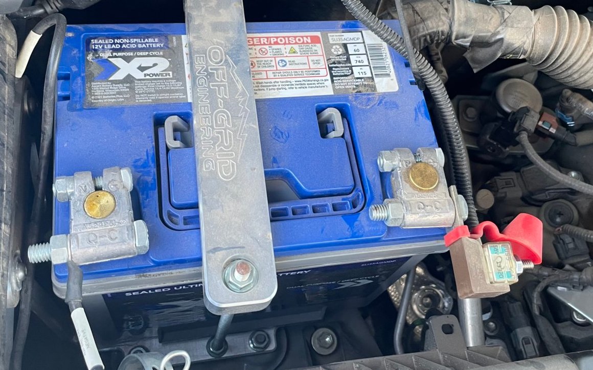

    Here is the starter battery:
    Here is the accessory battery:IMG_6209.jpgIMG_6211.jpg

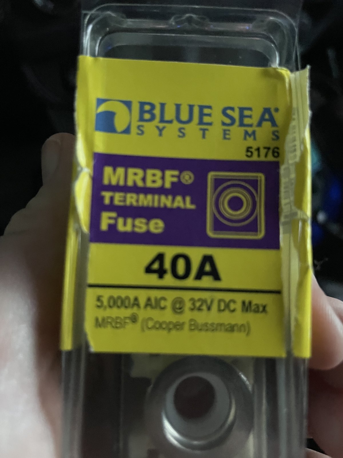

    here is the fuse type:

    3) Local Napa stores are open and appear to have that 40A MRBF available for pickup today
    https://www.napaonline.com/en/ca/corona/store/26157?sdref=header
    https://www.napaonline.com/en/p/BK_CBBF40

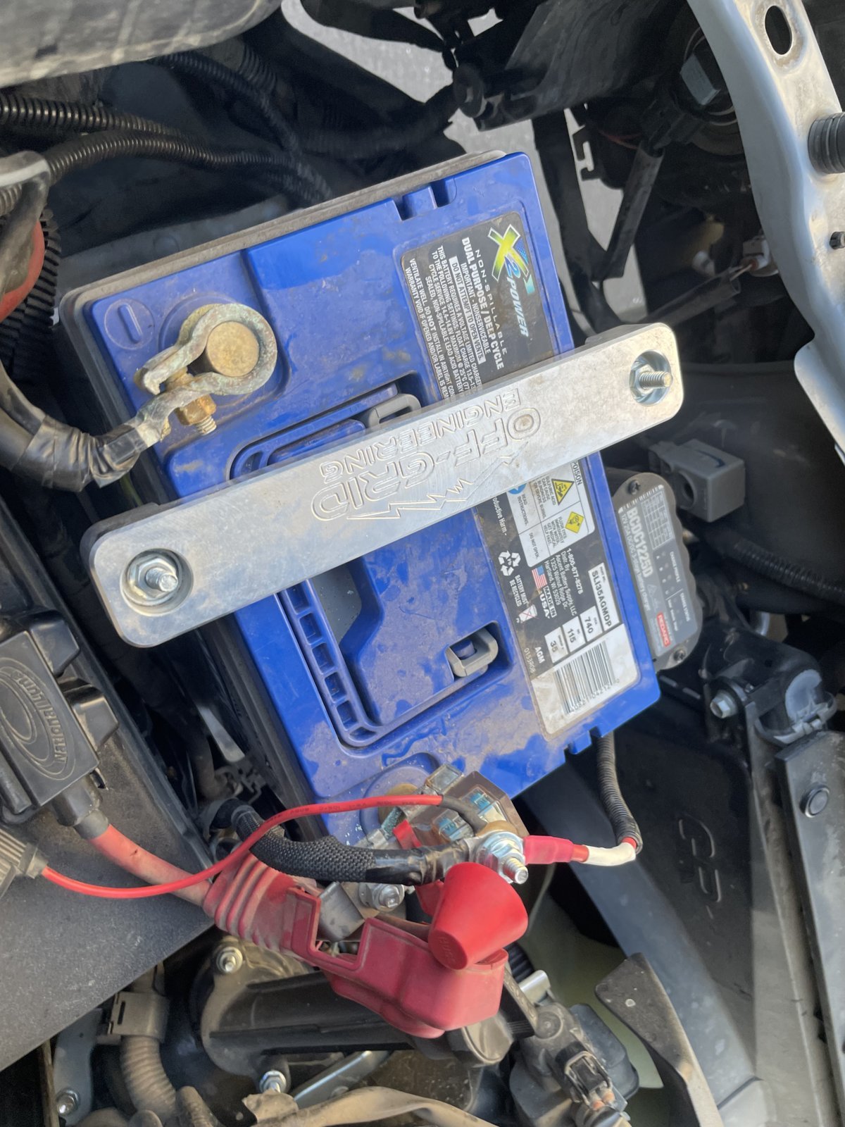

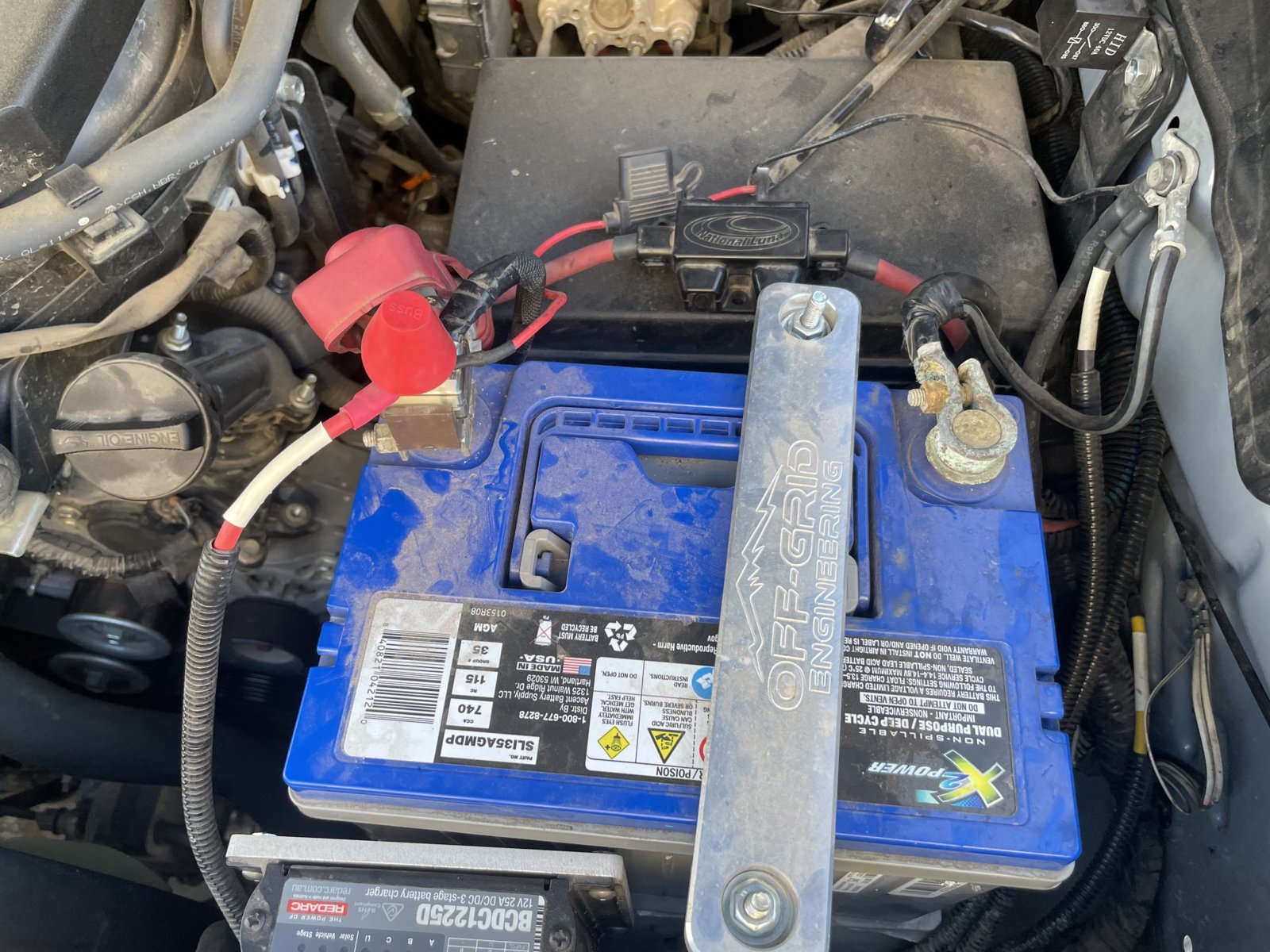

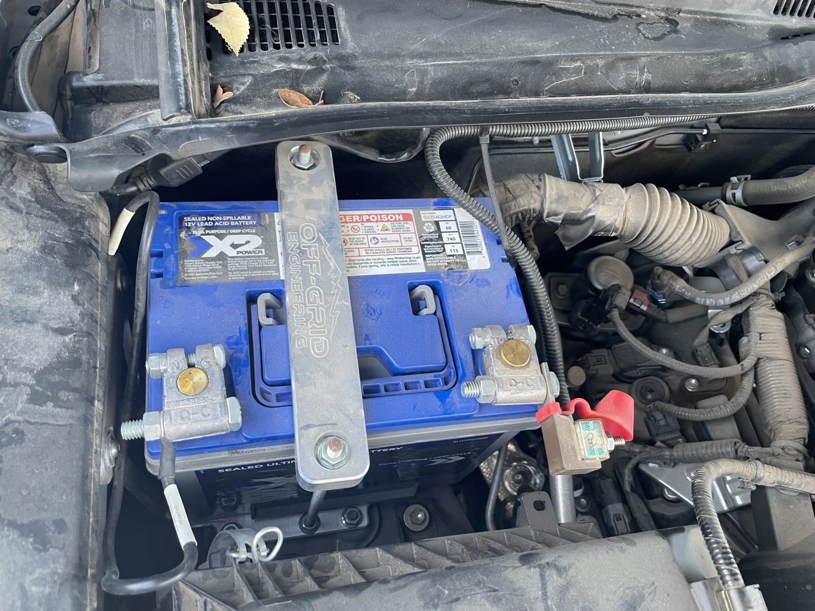

    4) Can you take a few more pictures of the Pos terminal and all those hot wires on drivers side? What is the National Luna thing?

    Thats what I thought just wanted to confirm. Depending on how all those accessories are wired, it might be a simple overload of that 40A. Hard to tell without more pics.

    I still cant tell how everything is wired without more pics, but none of the factory truck wiring should run through that 40A fuse as far as I know. You should be able to fully isolate everything related to the dual batteries / OGE system. Just put the stock wires back on the battery terminal as they were before the OGE system to get you home
