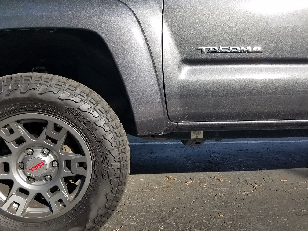

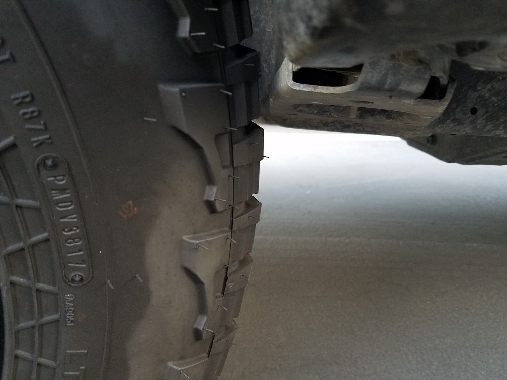

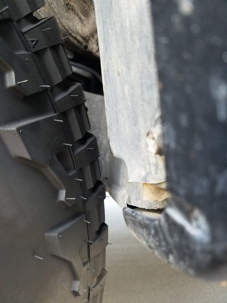

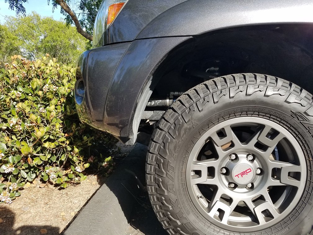

    Hey guys, hoping someone can lend me some insight as to what I am looking at.
    A while ago I got a set of TRD SEMA wheels and followed-up with some Falken Wildpeaks. Was all good at the time. More recently, I did a full suspension upgrade and noticed that my front tires were coming real close to the cab-side, sometimes rubbing when turning or at full lock (backing up and such). Originally, I wanted to keep my mudflaps on, but I ended up taking them off as they were rubbing too much.
    I haven't seen other people have this issue (though I am certain I am not the only one) so I was seeking some assistance in if there is anything I can do to remedy the situation. Pictures are attached as where the truck currently stands today.

    Painfully common. Cut the cab mount (search for cmc or cab mount chop) few vendors even offer laser cut plates to scribe and reweld in place to give you the clearance needed

    How much lift did you end up with? The lower the lift the more the aftermarket castor correcting uca's move the tire towards the rear. In the end you may have not needed the additional castor.

    Theoretically your caster should be closer to 3*, but more positive caster should be helping you NOT rub the cab mount, as it is pushing the wheel further forward.
    Kind of odd you're rubbing with that much caster and only 265's. I would think a lot of that is your wheel offset.

    Hey bud, some tires have a larger OD due to the lug design, looks like yours are one of them and its just large as your specs look fine.
    I have done well over 200 cab chops, and some even on "smaller tires" like yours.
    I say do the CMC and then you are good to go, its going to rub super bad when you are in reverse and the wheel is stuffed. I do at least one a week.

    ^ this. Even my stock size 265/70r16's rubbed on my 04 because of the backspacing of the aftermarket wheels I have. Rubbed at full lock on the pinch weld/cab mount like your's are, I had to take an angle grinder to it. Being that your truck is newer you might want someone do a CMC though lol

    Really with aftermarket uca’s you’re gaining castor from the top side of the suspension travel. It isn’t so much pushing the tire forward as it is leaning the spindle back. So more castor doesn’t necessarily guarantee more tire clearence just better tracking.
