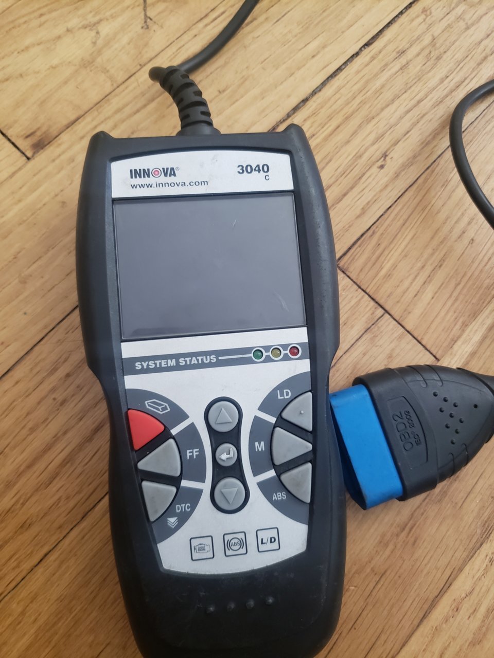

    Just went through this for a TW member. The paperclip method would not work. Ended up using my code reader. Mine has ABS functions.
    Once connected I pressed the ABS button. Immediately showed a code for "zero point calibration."
    Then I pressed the erase button and poof. No more light on the dash.

    OP if you don't want to buy a similar code reader. I can try to clear that light for you. I'm in Lakewood.

    There were error messages for traction control, TSS (radar sensor in the grille). Multiple systems rely on the zero point calibration.
    All lights were cleared after the zero point was performed. Back to normal.
