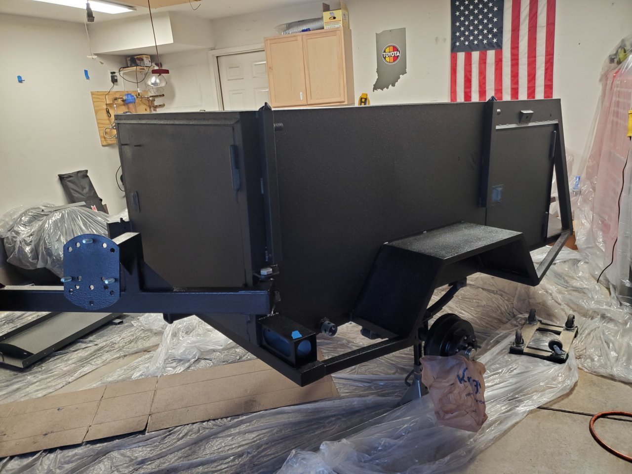

    Sprayed the rest of the raptor liner last night. Immediately spraying the first bottle it dawned on me that charcoal grey and black aren't very far apart. The first bottle was extra dark for some reason and it looked just like black. second and third bottler were lighter so I could see the difference but once I removed the tape and paper I realized I just wasted 2 days taping and being meticulous when I could have just sprayed the whole thing. Only used 3 bottles for 3 coats on the body part. In the light you can tell the difference but in the dim areas of the garage you cant. Found a few spots where I sprayed black that I need to touch up so I bought a couple rattle cans so I dont have to make a huge mess again but the outside coatings are pretty much done.
    Ordered a bunch of 16ga wire last night as well to start on the trailer lights and also a couple more tubes of caulk to finish caulk the inside and seams that aren't welded shut. Need to figure out a way to coat the insides of the unsealed lift tubes with paint so they don't rust out on me.

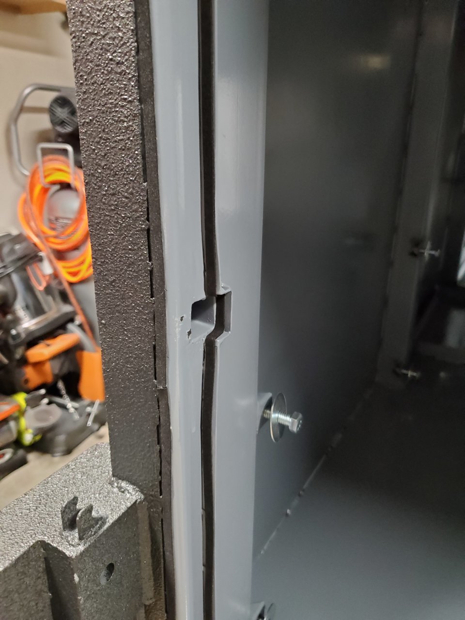

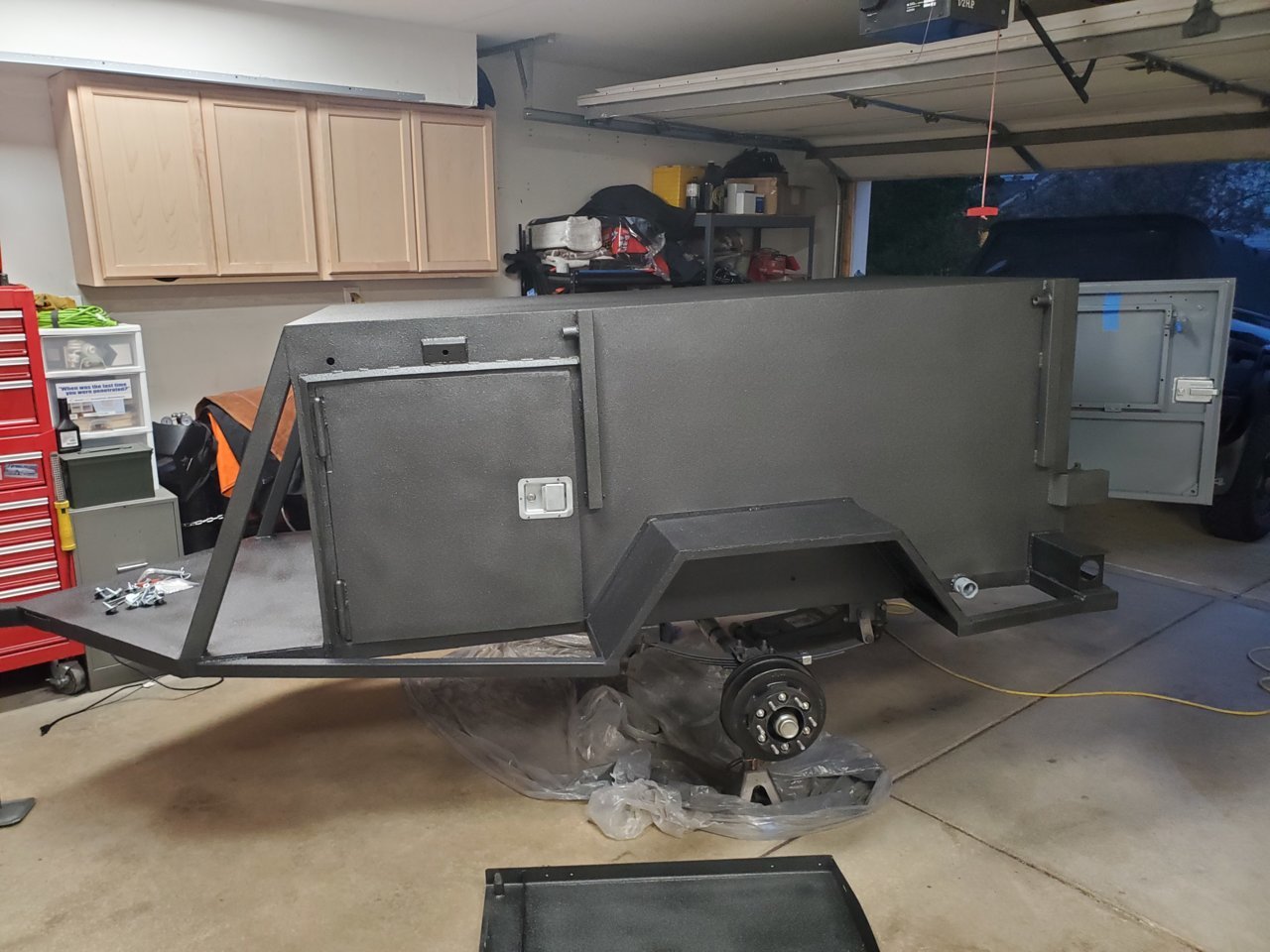

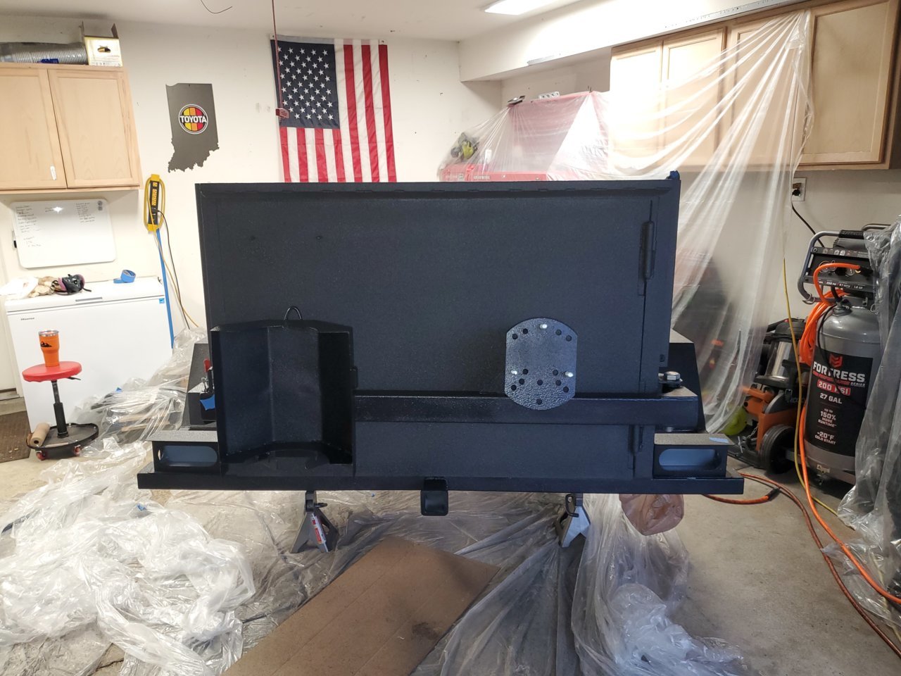

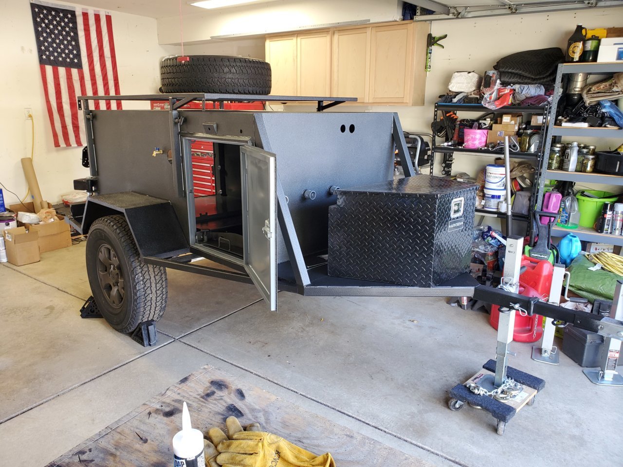

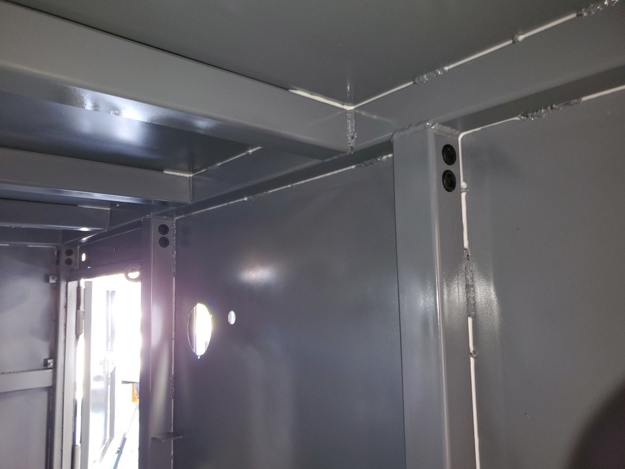

    Trailer is back on its own wheels again. started re constructing everything that was taken off for paint. Got the entire outside and inside silicone caulked to help seal it up from water/dust. Bolted on the tongue box, riveted the vin plate on it, put some rubber grommets in the cabling holes on the inside. Then I put a 1/16" weather seal on the inside of the doors and on the door lip inside. This helps the quiet the closing of the door a little bit as well as hopefully seal the doors up a little more. Cut some rubber for the propane tank mount so the edges aren't as sharp. And finally to round all of that out I mounted the spigot and 90 degree shark bite for the water tank and pump install next spring.

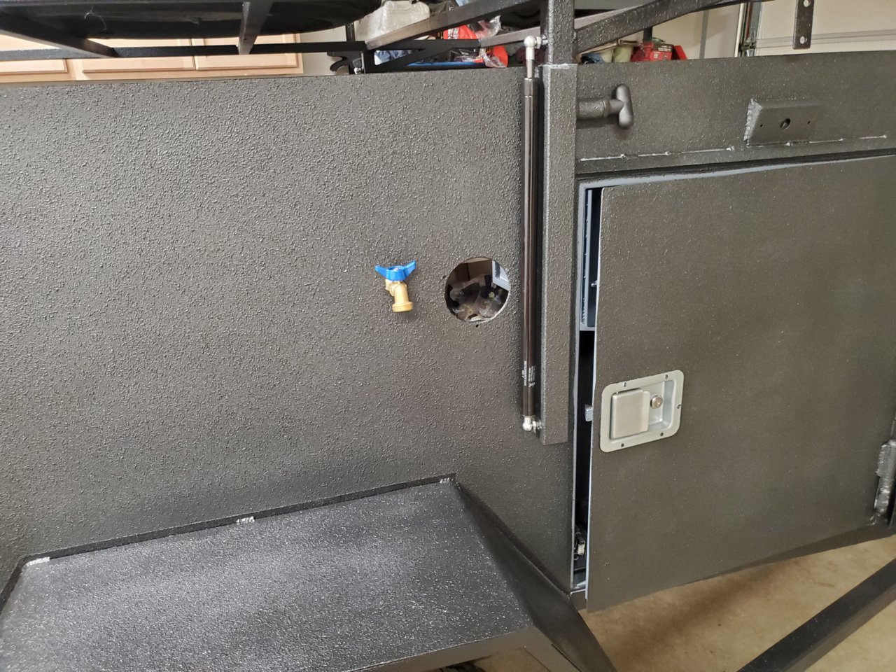

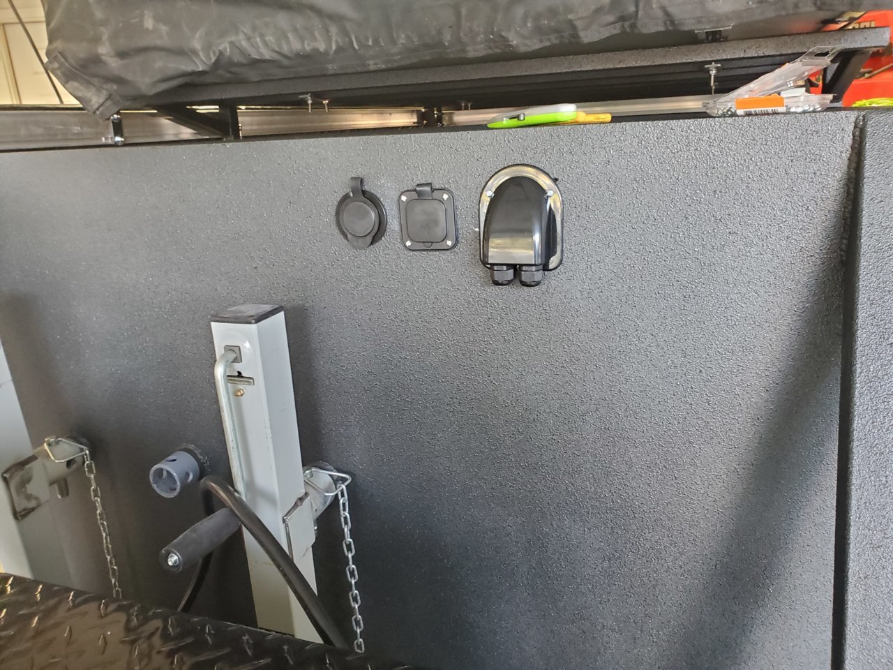

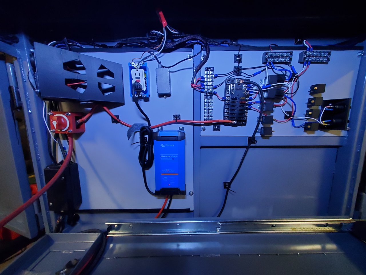

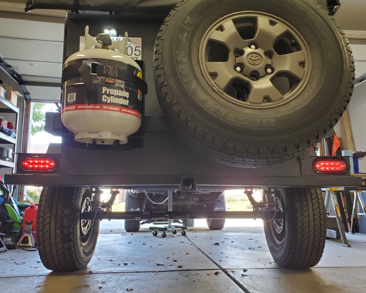

    Wiring has begun, took 2 days but I am trying to make it look as good as possible so I don't need to re-do anything. I am running as many wires as I can into looms to give them some extra protection and also to make them look cleaner.
    List of things completed over the weekend:
    • Main power board set up and mounted
    • Solar in (for future), power in, and power out mounted and wired
    • Tail and running lights wired and mounted
    • License plate light wired
    • Ground bolts drilled and tapped
    • Interior LED light strips mounted and wires run
    • Axle brakes wired
    • 4 gang switch panel wired and mounted
    • Started laying out relay/breaker panel for other side
    • Mounted the tent and the awnings
    • Mounted the propane tank
    • Wired up the cook table on the rear door
    • Mounted and sealed the water in/out

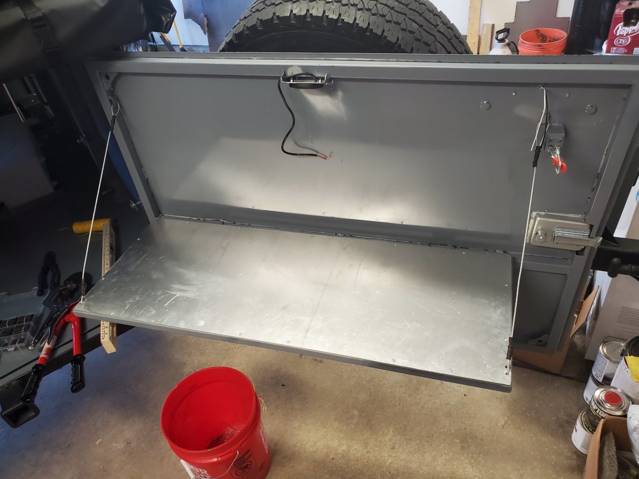

    • Mounted the rock lights on the sides of the doors for fridge slide
    I have a few extra rock lights I was considering running an extra wire down and putting a couple under the trailer but not sure how I would wire the switch just yet. I would love to be able to flip them on from inside the truck but that would require some extensive wiring.

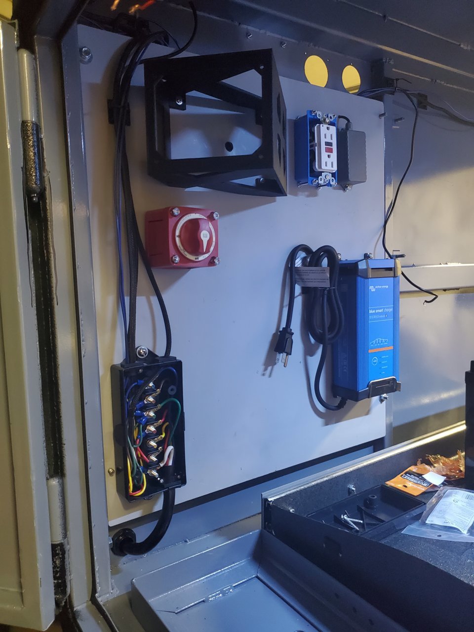

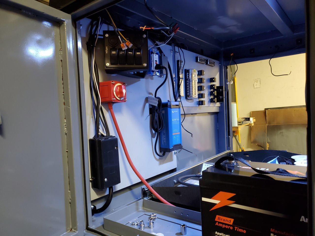

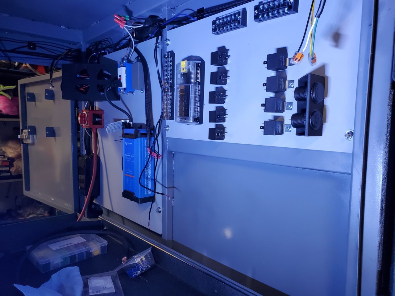

    Got more work done on the on the wire panels. Got the relay/fuse side completed and mounted now just need to start wiring it up.

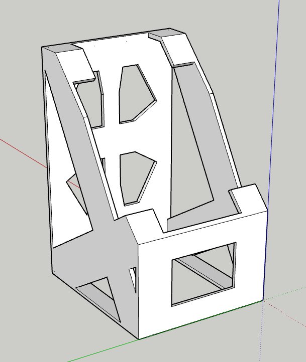

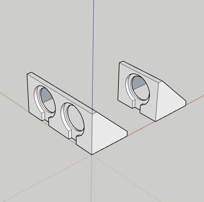

    I love how organized it is!
    Dud you build that switch panel angle mount thing?

    After the rats nest my aux fuse panel has turned into in the engine bay of my truck I wanted to set this up as cleanly as possible from the start so it was less likely to turn into a mess. Yes I made the angled switch panel mount. I bought a 3d printer a few months back and printed a few things to test around with then I drew up the switch panel mount so it pointed at the door without interfering with the first aid kit that will go on that door and the fridge. I also printed the USB/12v plug for the fridge on the right side of the second picture. That one was easier to design than the switch panel stand off.
    dpele[QUOTED] likes this.

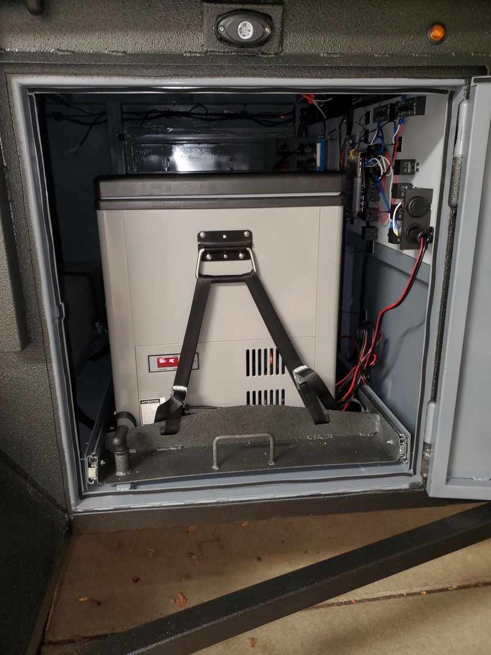

    Finished more of the wiring, I now have shore power, battery charger, interior LED strips, 4 switch panel, 12v charger for the fridge. Decided to remove the fridge cover so it doesnt catch on the electrical panels as its really close but also didn't think the cover helped all that much but we will see how next year goes. Started a list of things I need to finish next spring. Going to be storing it for the winter so I can park my truck inside. That should also give me the space to finally install the 6112's I have had in a box for most of the fall. Also time to replace the stretched ABS wires so I can get ABS back before winter.

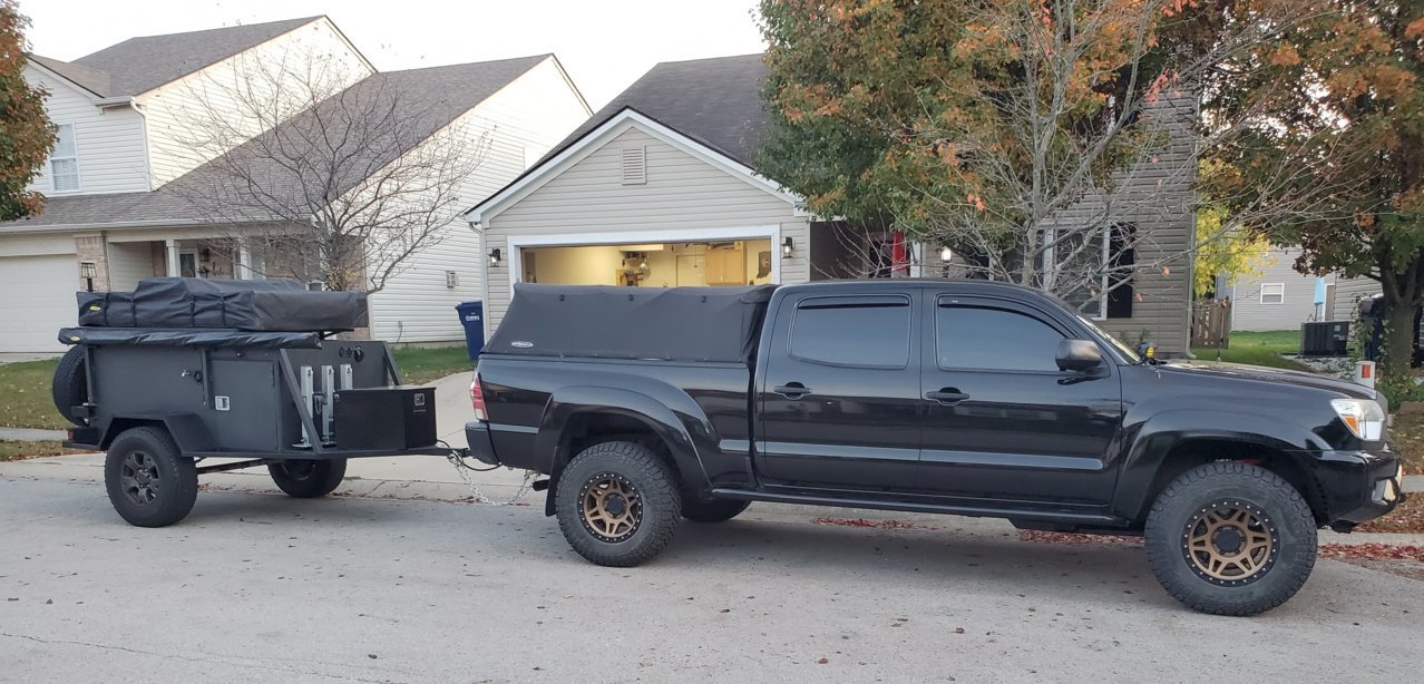

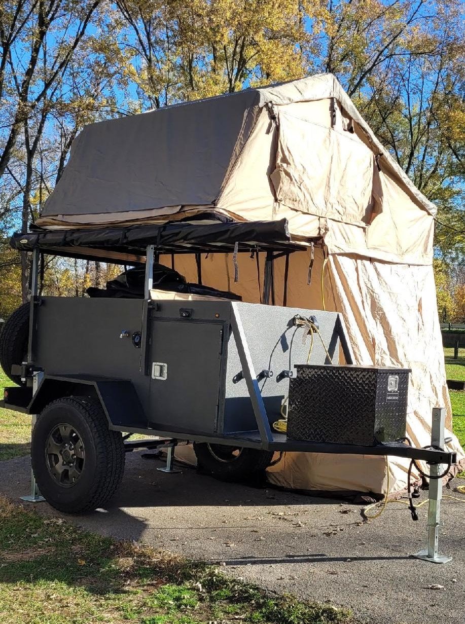

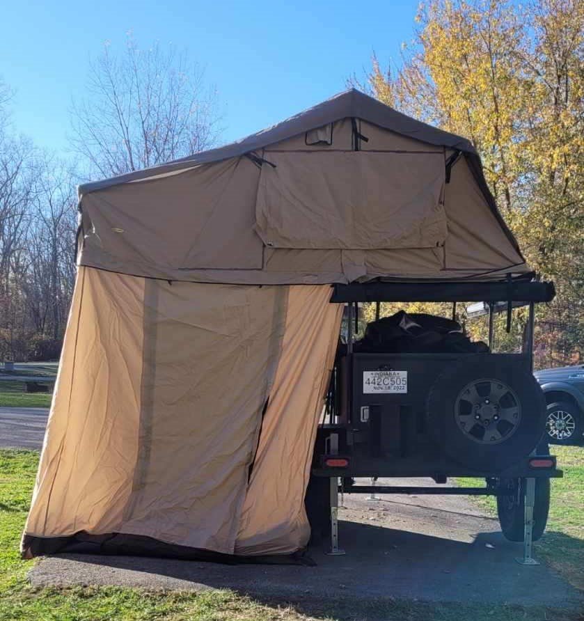

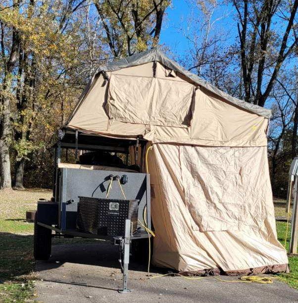

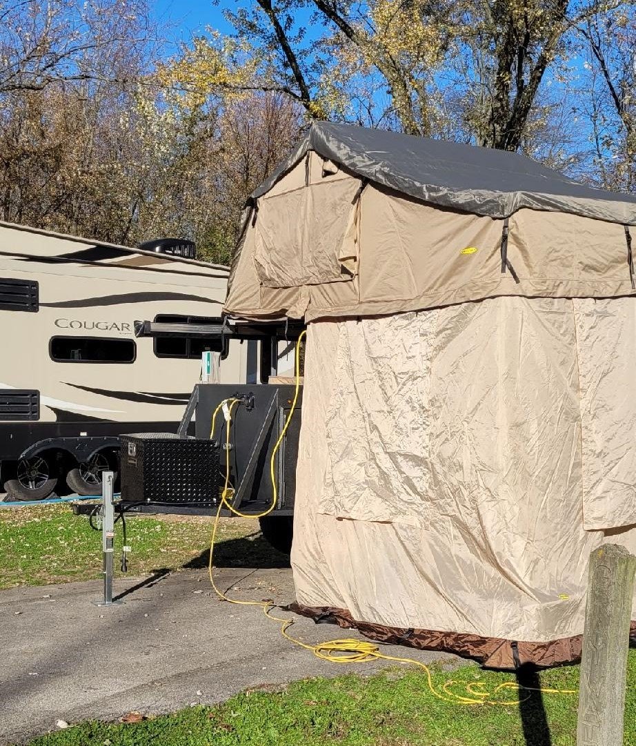

    Finished my trailer enough to take it on its maiden voyage this past weekend, played it safe and took it to a campground with amenities so if something didn't work well we didn't freeze and have a miserable time. Towed it about 3 hours on the highway going anywhere from 50-75mph and it tracked perfectly straight behind us. Since I don't have it fully loaded it was a tad tongue light (sub 200lbs) but didn't pull weird at all. Once fully loaded I can always fill the water tank with some water to bring the tongue weight up a bit. Tent lift needs some grease on the slides, extendable tongue needs cleaned and at least primered so it doesn't rust in the tongue. Need to put a light switch in the rear door for the cabin lights. Next spring will be the finish of the interior with drawers, water system, and finished electrical. Definitely need some rock lights and reverse lights on it too.

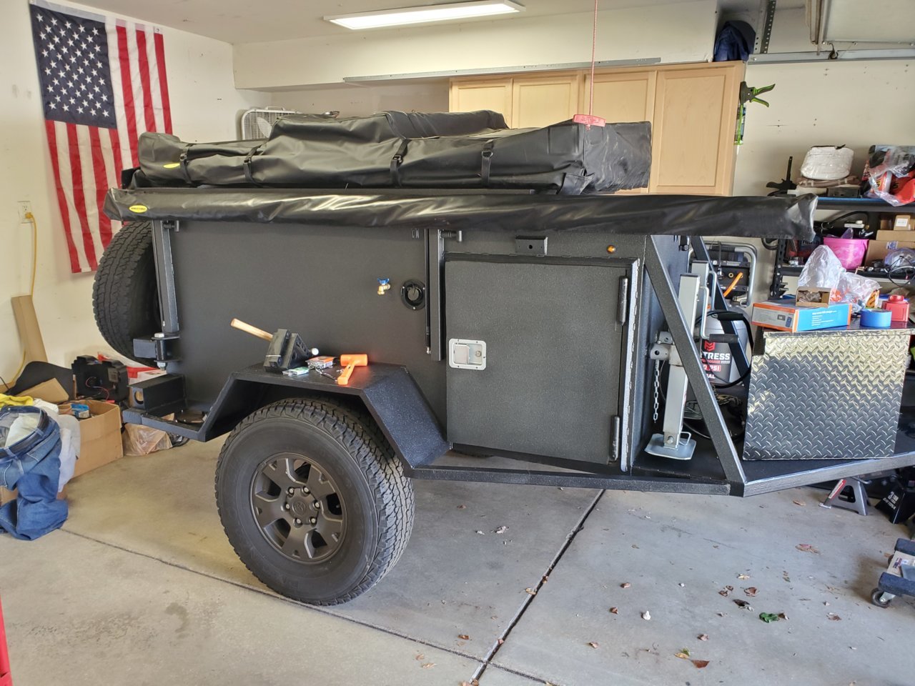

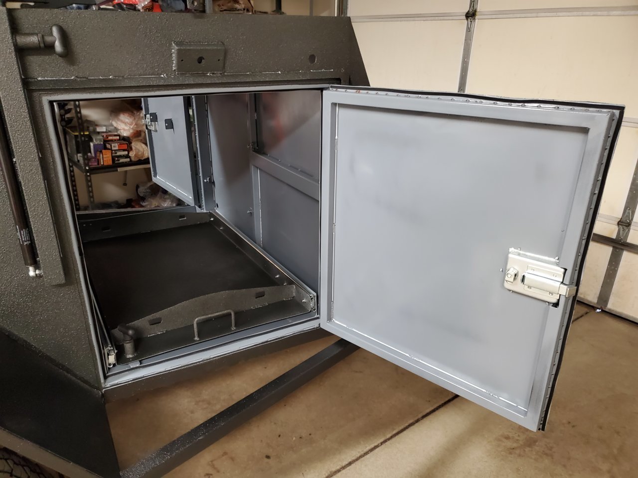

    The plan for next year is to mount a diesel heater in the tongue box and create a false floor for it to sit under then carry a 5gal diesel jerry on the tongue and do exactly that, run a hose to the tent where it folds in half.
    I attached the sketchup file but tacomaworld wouldnt let me upload a skedtchup file. If you download the text file then rename it Trailer_build.skp you should be able to load it into sketchup.
    I essentially made it 4x8 with a 3ish foot tongue. Box is almost 3 foot tall and almost 7 foot long of the 8 foot length. I essentially decided on my my drawer height then made it tall enough above the drawers I will be putting in to get plastic tubs on top of the drawers and not hit the ceiling.

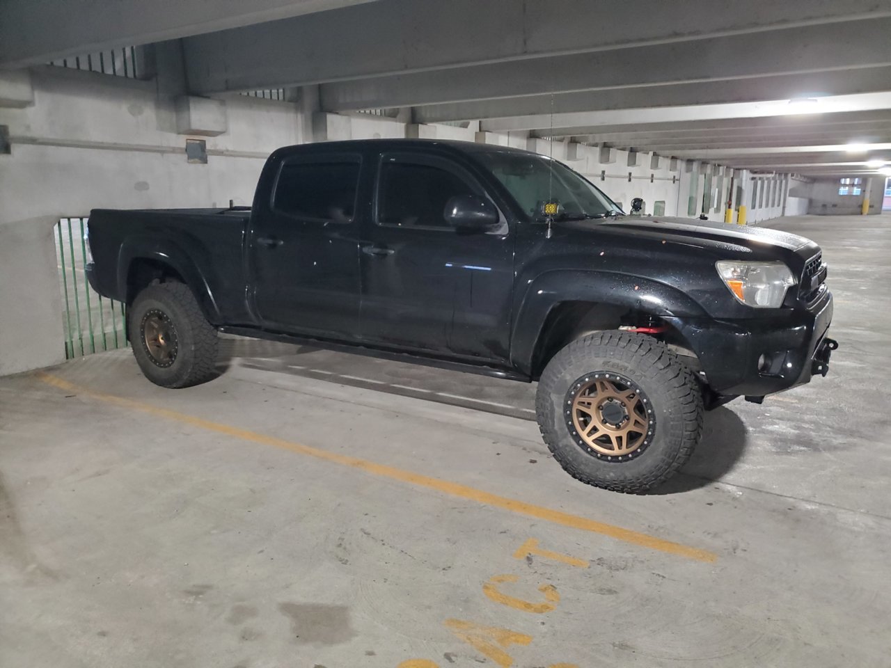

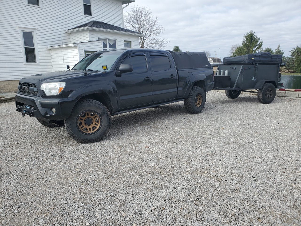

    Haven't dont anything to the truck other than clean the winter grime off of it. 6112s are still sitting in the box at the back of the garage. Been too busy this winter with other things to work on it. Hoping I will get some time end of april/may to get them installed. Went and picked up the trailer from storage and brought it home. Need to finish up some wiring that was left unfinished last fall, build some drawers, and maybe set up the water system.

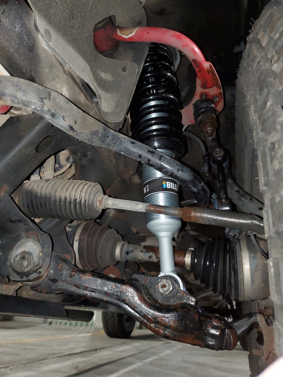

    Over the weekend I finally got around to installing the 6112/650lb front suspension on my truck that has been sitting in its box for a long time. Used the truck weight method to compress the springs to attach to the top hat. Getting the passenger side to seat in the lower control arm was the biggest pain in the ass. Replaced the 5100/887 setup that was sagging due to more weight than I ever intended to have when I first lifted my truck. Got about 2 inches back in my lift which was nice but I am anticipating it settling a bit. Rides real nice, much firmer and less nose dive now with the added weight. Finally back to level instead of having some rake and the 650s hold up the armor and winch a whole lot better.
