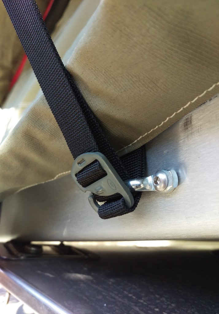

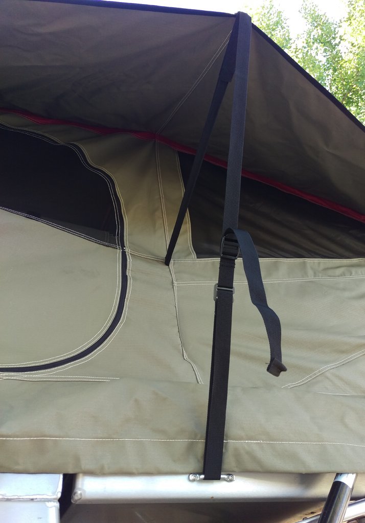

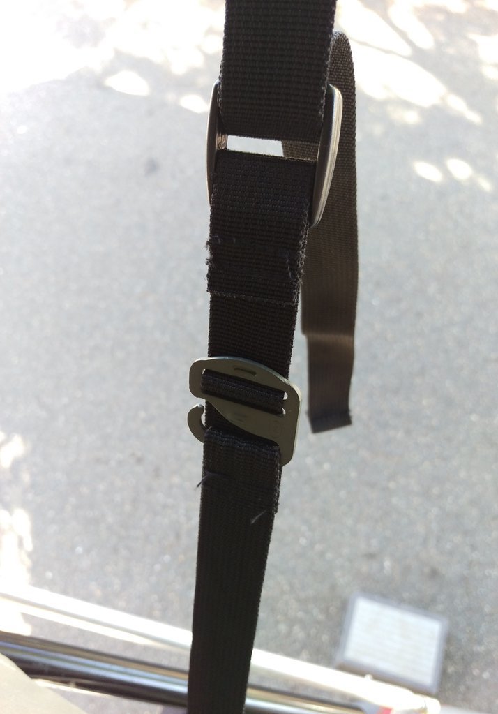

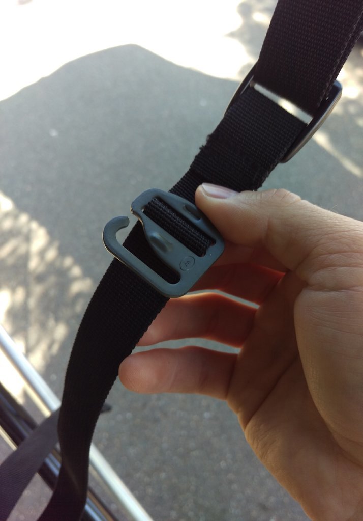

    The night I stayed in Death Valley there was such high winds that one of the plastic c-hooks that holds the side brows open broke off. Since then I've been improvising with loops of Paracord, and I tried to look for replacement plastic c-hooks but could not find the same thing. Instead I found a substitute that I think is a huge improvement.
    ITW G-Hook flat
    http://milspecmonkey.com/store/hardware-diy/369-itw-g-hook-flat.html
    I ordered a pack of 10 of these and they work great to hook the strap looped around the anchor. By using two additional ones I can even still secure the loop on the skirt which I didn't feel was important but it's nice to retain that function.

    ..so you are leaving this strap in place?
    ok makes sense now that i did this #mooglemod

    You mean when I close it am I leaving the straps attached to the anchor? No.
    The hooks easily detach but can stay on the strap while it is loose. So they basically function the same way the original plastic c-hooks do, but do it much better.

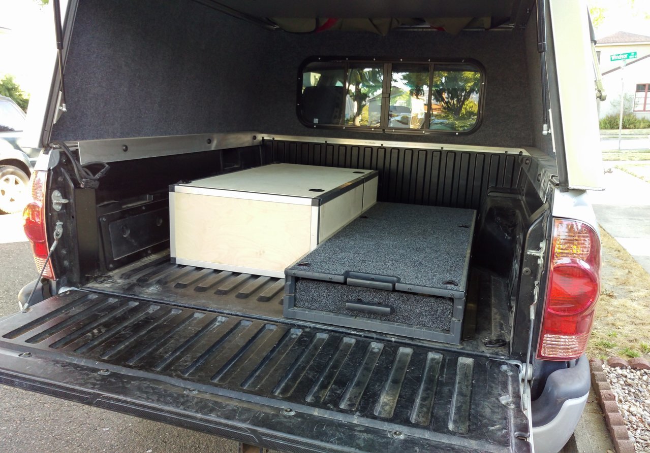

    Finished the cabinet and got it mounted to the bed. I may still try to add carpeting to the top.

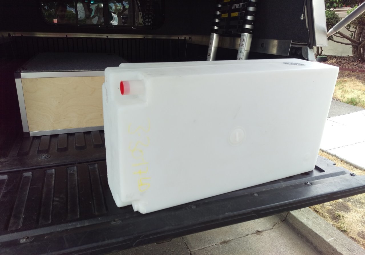

    Starting to dive into OB water. I took a chance on an cheap rotomolded RV tank from Amazon, and it fits absolutely perfectly in the gap behind the slide and cabinet.
    It holds 15 gallons and has 3 1/2" female threaded ports and one 1" unthreaded. Debating if I should bite the bullet and buy a pump for it before my trip in a week, or just wait and use it gravity drain for now. Still trying to plan out the plumbing. Also need to figure out how I'm securing it.

    corprin
    We run a 1" reenforced poly water line into a schedule 40 ball check valve. Line goes from the bladder to the tailgate down the left edge of the wheel well and between the fridge and bed. We then have about 2' extra line coiled at the tail gate. Just hold the line below the water level on the tank and open. Simple and effective.
    This is going to be changed to a low pressure water pump through some filter elements. We filled the tank at a friend's in Phoenix before we set off, and found their tap water to taste like crap. Decided a pass through britta was needed if we wanted to supply he tank.
    As for securing it...We run a 24gal bladder in a plywood box, so can't help you much here. That said, I've been mounting aircraft track to my bed for mounting everything under the sun. I found some cheap track at Northern Tool. I chuck it into my bench vise, then chamfer the bottom corners a bit. This lends them to drop right between the bed ribs.
