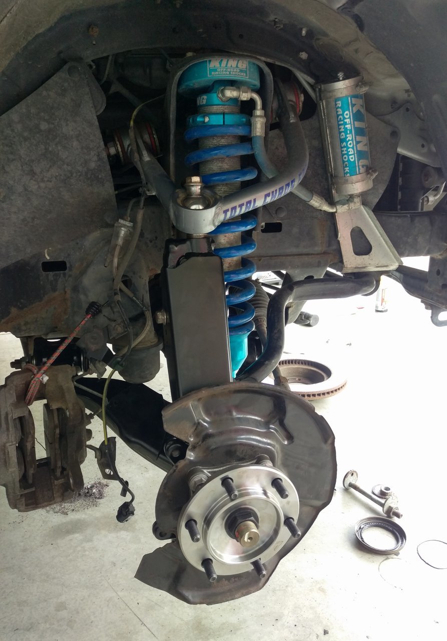

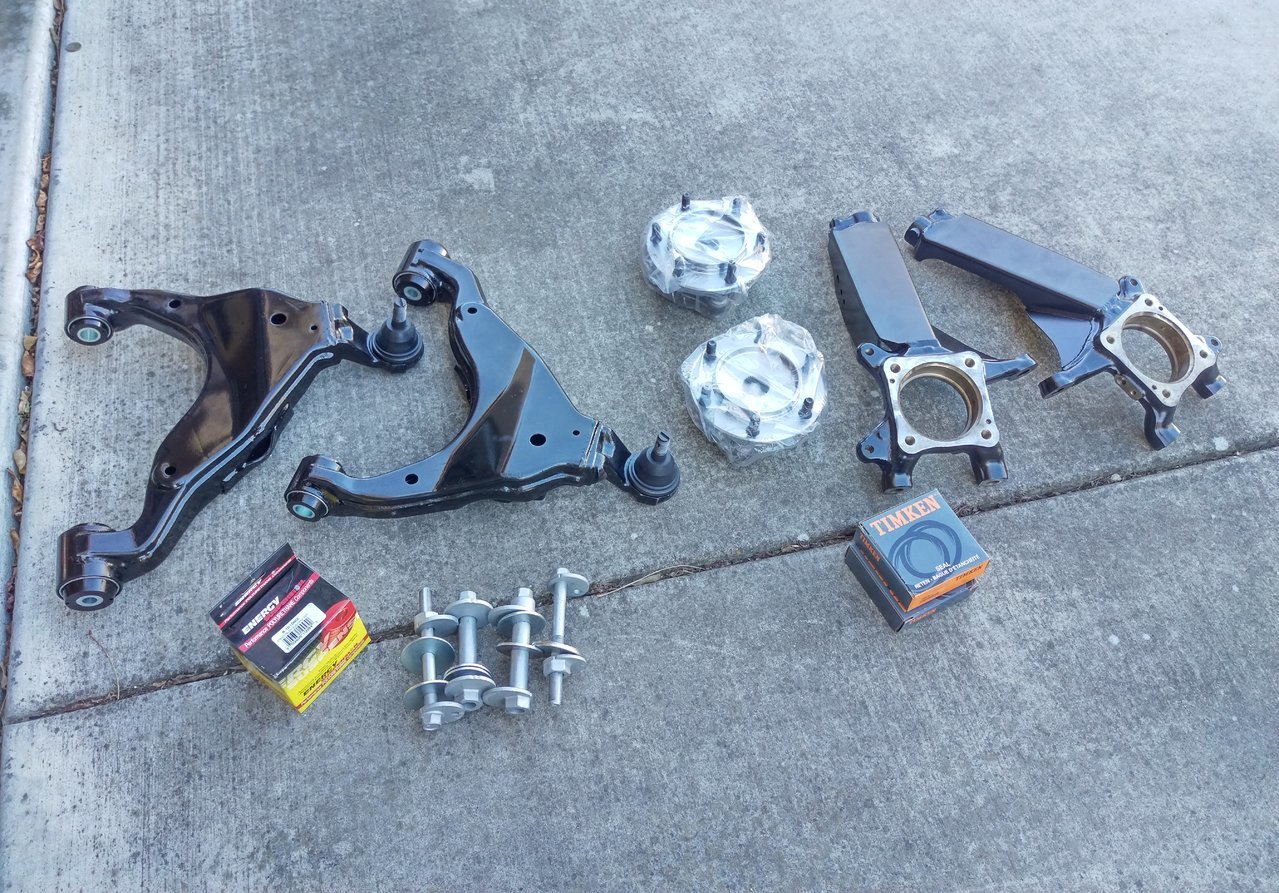

    Spent Saturday and Sunday replacing LCAs, TC gusseted spindels, and wheel hubs.
    LCAs are OEM but in better shape than my old ones. I touched up the paint on them, replaced the ball joints with proforged, and replaced the bushings with Whiteline poly.
    I was also going to try to replace my steering rack bushings but ran out of time. I'm convinced it's not possible without pulling the rack out.

    I found it pretty easy to remove the OEM bushings using the bottle jack and torch method, and I replaced them with Whiteline poly bushings that have their own sleeves so they just press right into the LCA, unlike the Energy Suspension bushings which reuse the OEM sleeve :facepalm:
    I used this tool to press in the WL bushings. Not as as easy as a shop press, but it's cheaper and worked really well, and it comes with the right sized adapters for the WL bushings.
    https://www.amazon.com/gp/product/B073WQXMH1/ref=oh_aui_detailpage_o00_s00?ie=UTF8&psc=1
    Also, these are the Whiteline bushings for anyone looking:
    https://www.amazon.com/gp/product/B0070I9I12/ref=oh_aui_detailpage_o00_s01?ie=UTF8&psc=1
    Maybe the next time I replace my LCA bushings, I'll just buy TC lowers instead. Then again, I do have a spare set of WL bushings now...
