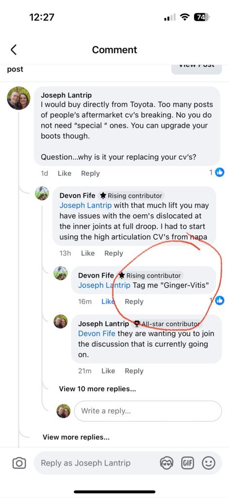

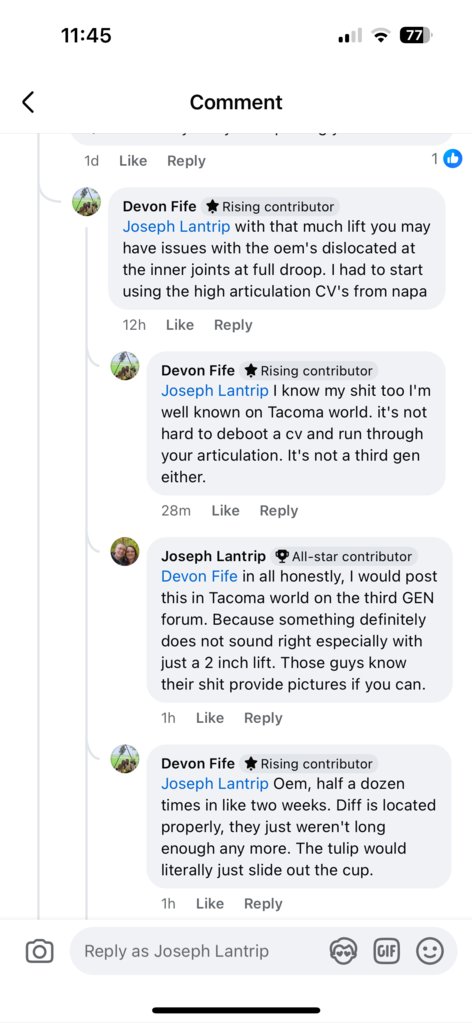

    Here’s more of the conversation. He’s went silent for now after I posted a screenshot from TW of your guys‘s responsesIMG_2437.png

  13. Apr 12, 2025 at 9:29 AM

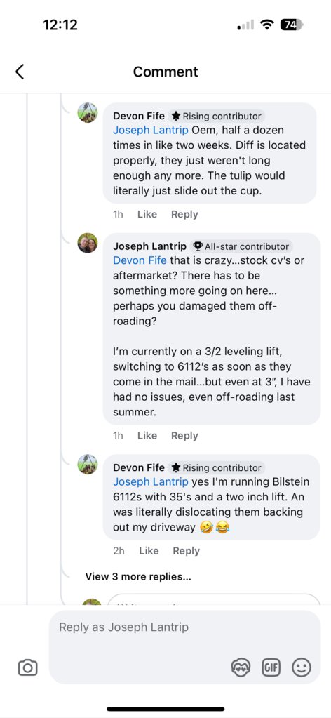

    Hey guys. I drive a second gen. And was quite thorough in my diagnosis. Of this issue. After switching from Bilstein 5100's with a 3/4" spacer to 6112's my suspension should have enough droop to dislocate the tripod bearing on the inner CV. I have checked that the diff is centered properly. But the only option I've found to work are the high articulation CV's offered by napa
