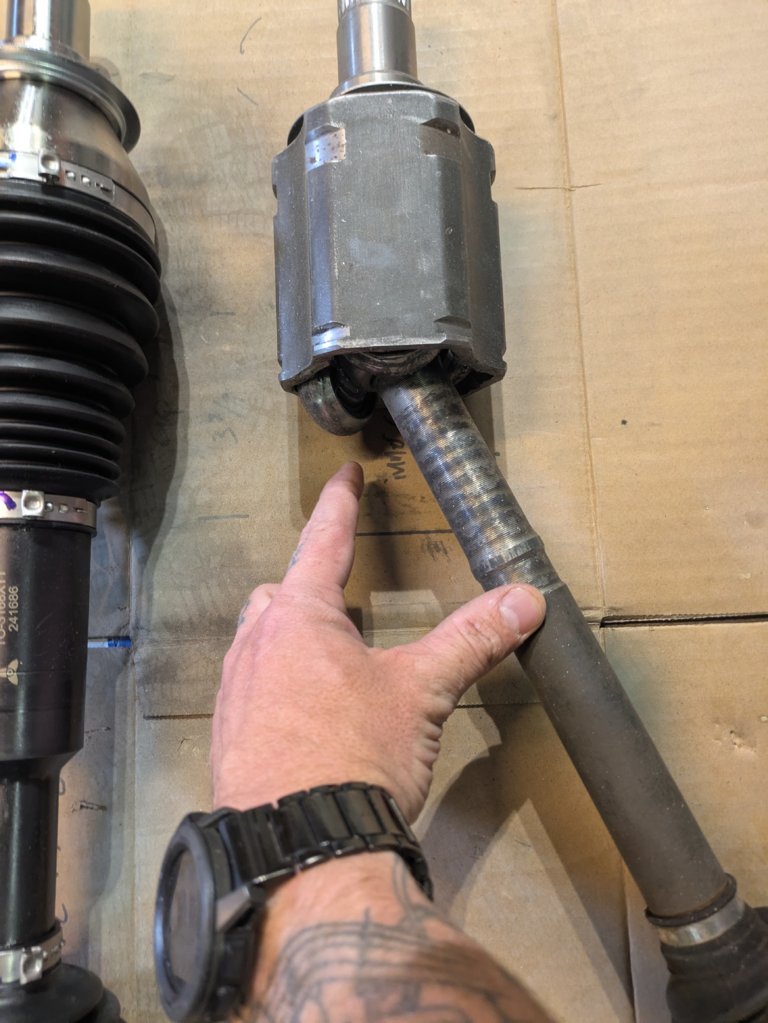

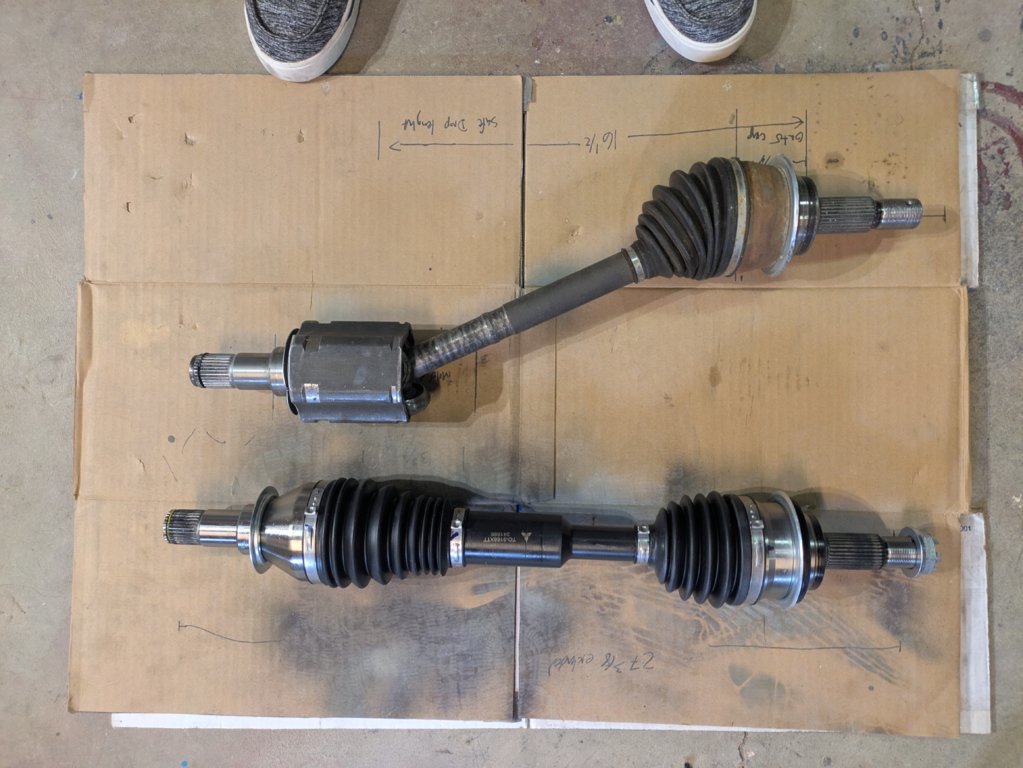

    Sorry TrakMotivePXL_20250412_170804822.jpg PXL_20250412_170809411.jpgso at full droop the upper tulit bearing would come out of the up like this. These CV's eliminate the tripod (tulip) bearings and use a slip yoke in the shaft. I haven't had the issue since. These joint do articulate more buy are slightly weaker. But unless Im are using to much gas with my front locker on I don't see me breaking them with 35's

    I agree my case seems to be an abnormally. But I have seen "broken" CV's that are just dislocated and not actually broken. I also believe if I were to put my sway bar back in that may solve the problem.

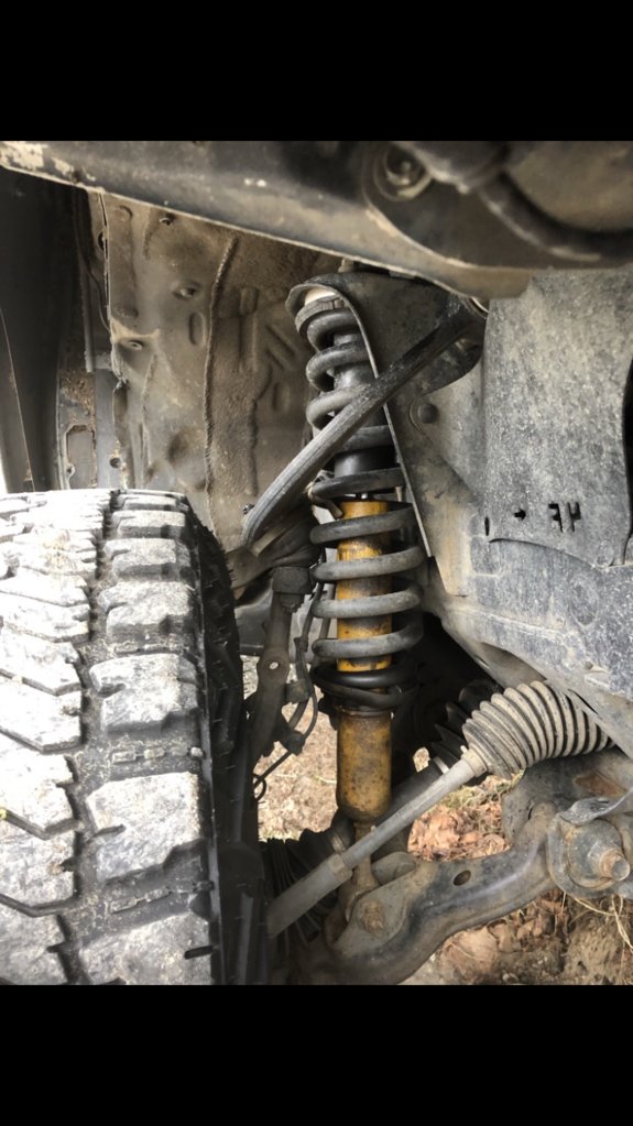

    IMG_9347.png Even with my UCA becoming my limit strap
    I never pulled a CV apart. Not sure how much more droop you can get if the UCA is hitting the spring.

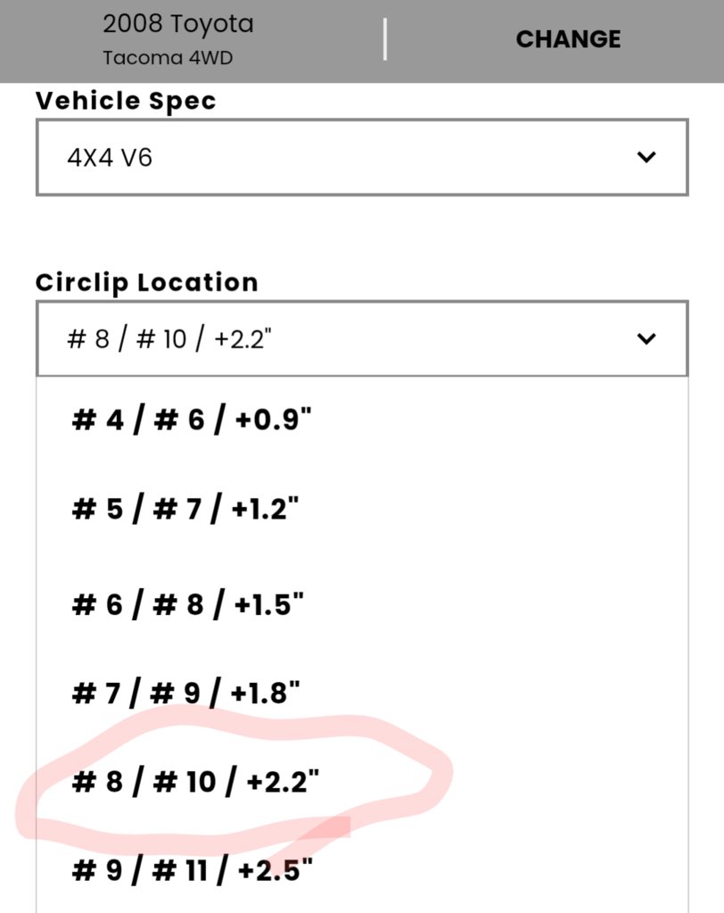

    Screenshot_20250412-113000.png2.2 according to Bilstein.

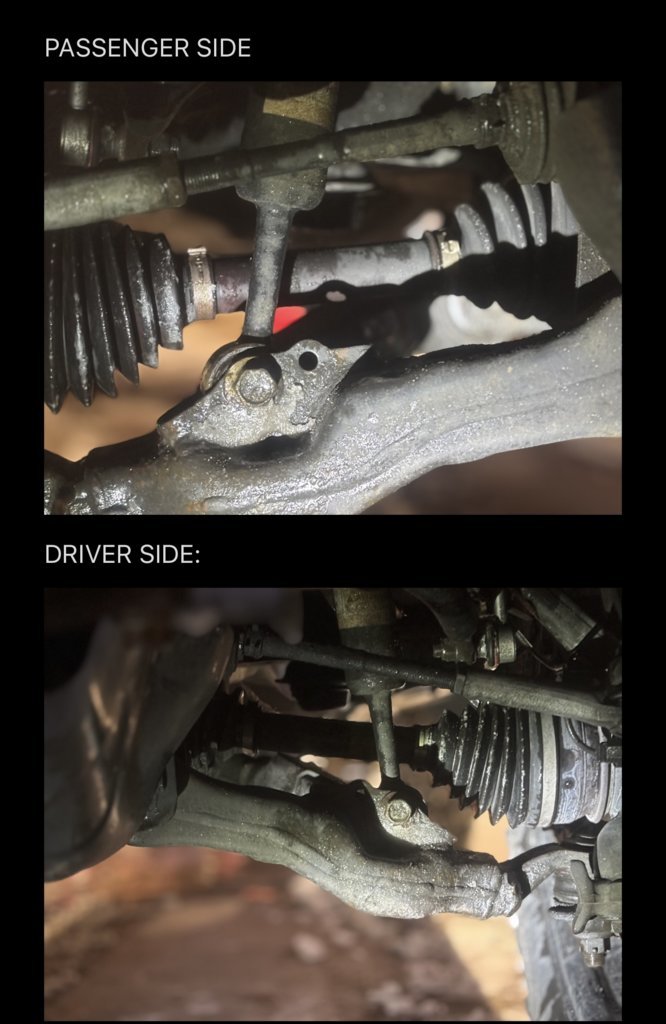

    No, there’s no diff drop here. This TW member Is strictly against them. He sent me this photo in another thread
