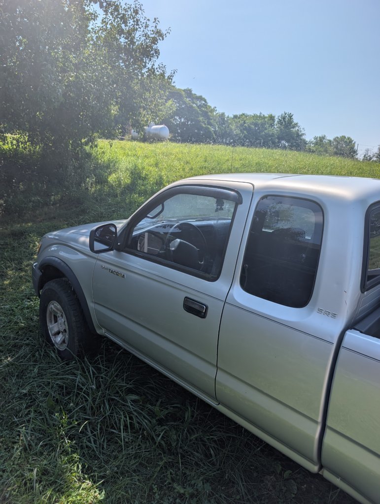

    So here's the back story on my taco. I acquired it when I bought my house last month because it was left on the property to rot when the previous owner moved out. I couldn't let a 2000 yoda with 38000 original miles just go to waste so my wife and I decided to start fixing it up to overland and camping trips. Well we have searched all over the property and we cannot find the keys to the truck and it is in Park. Obviously I need to get an ignition cylinder but I need a way to get the truck into neutral so I can move it to work on it. Any ideas?

    Unbolt the shift linkage (cable) from the side of the transmission and shift it there on the side of the transmission.
    Just be sure to block the wheels. That way the truck doesn't roll over you (if it's on a hill).

    Besides what TN stated
    there is a “clip/cover” on the top of the upper steering column shroud.
    Take small cover out with flat head
    Then stick the same flat head in the hole to defeat the “no shifting without a key”
    U can manually move the tranny into N
    (Wrecker drivers use this all the time)
