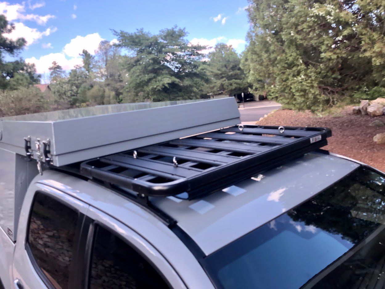

    I had the Eezi-Awn K9 rack installed by ATOverland in Prescott when I got my habitat installed. They didn't need to drill anything. I was told by the installers that it's kind of hit or miss if the holes are provided by Toyota. I think the model and options on the truck can affect that as well.

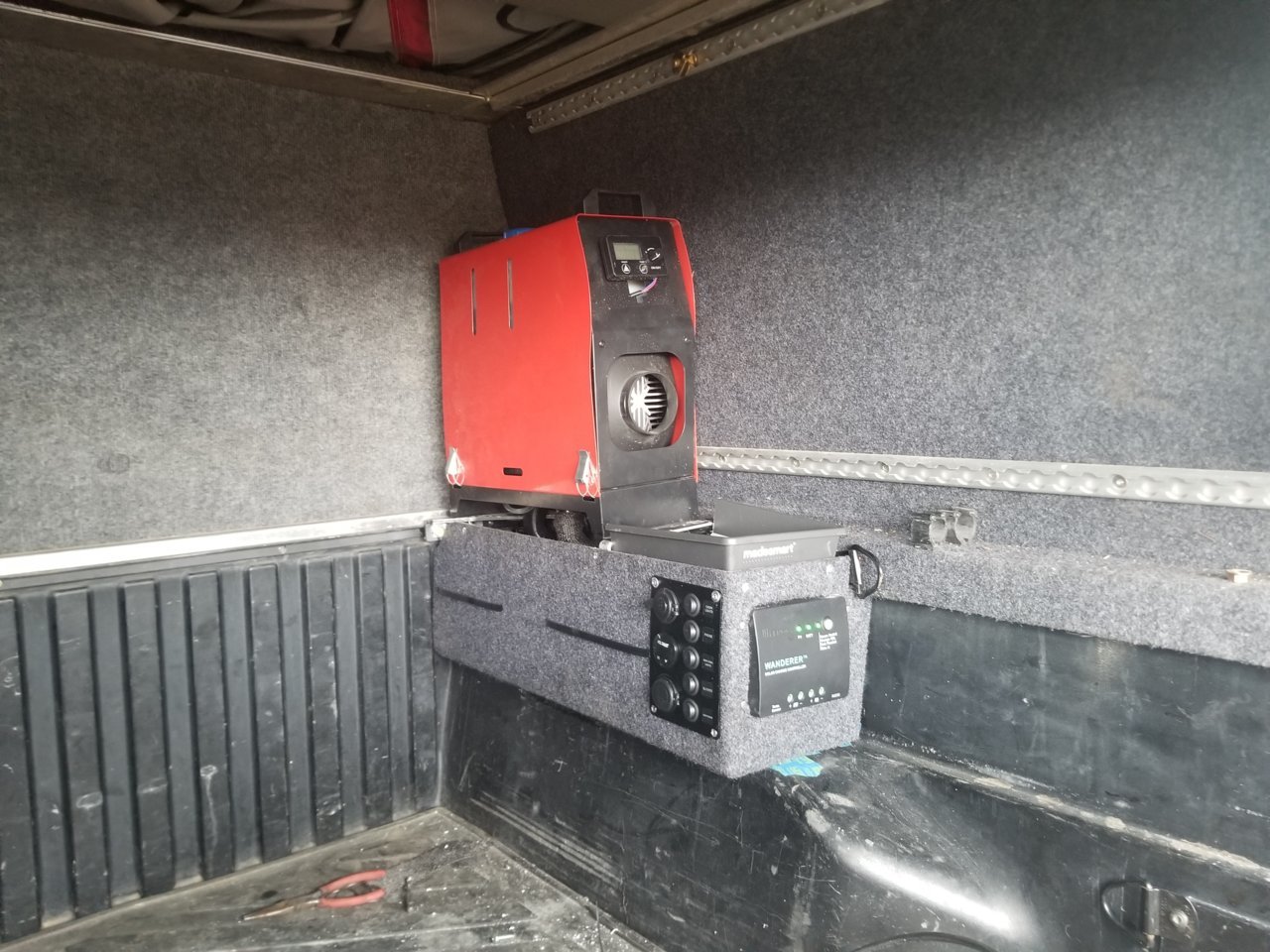

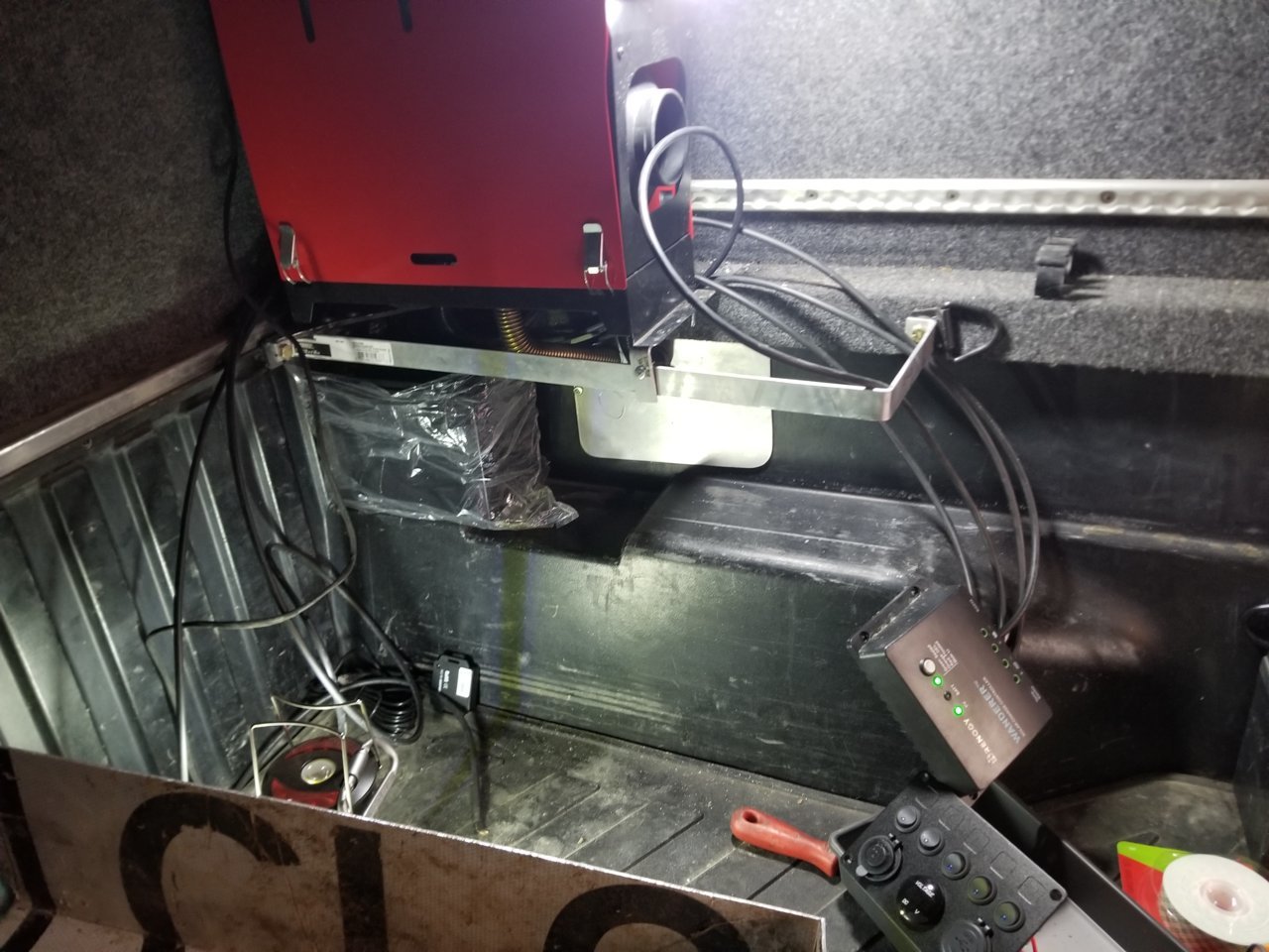

    So bummed out. Was planning a two week trip but with all of the shit going on I really dont feel comfortable being 15hours + from my home.
    Got a few updates to the camper done in any case in prep for the trip.

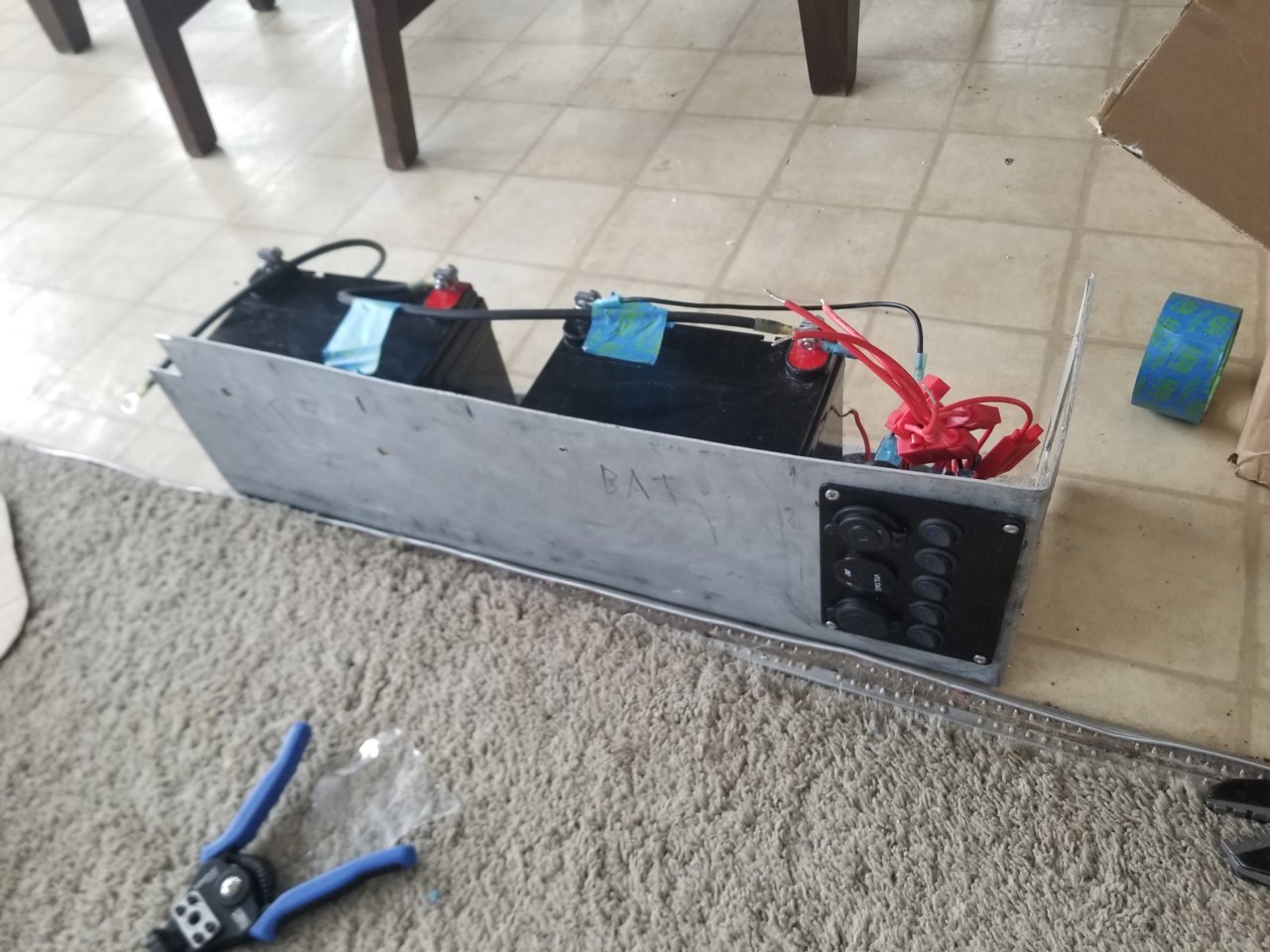

    Box contains 70ah of deep cycle agm batteries, solar charge controller, and six switch/ fuse panel as well as vents for heater
    Before
    During(Please excuse the shitty flooring that is getting replaced asap)
    After

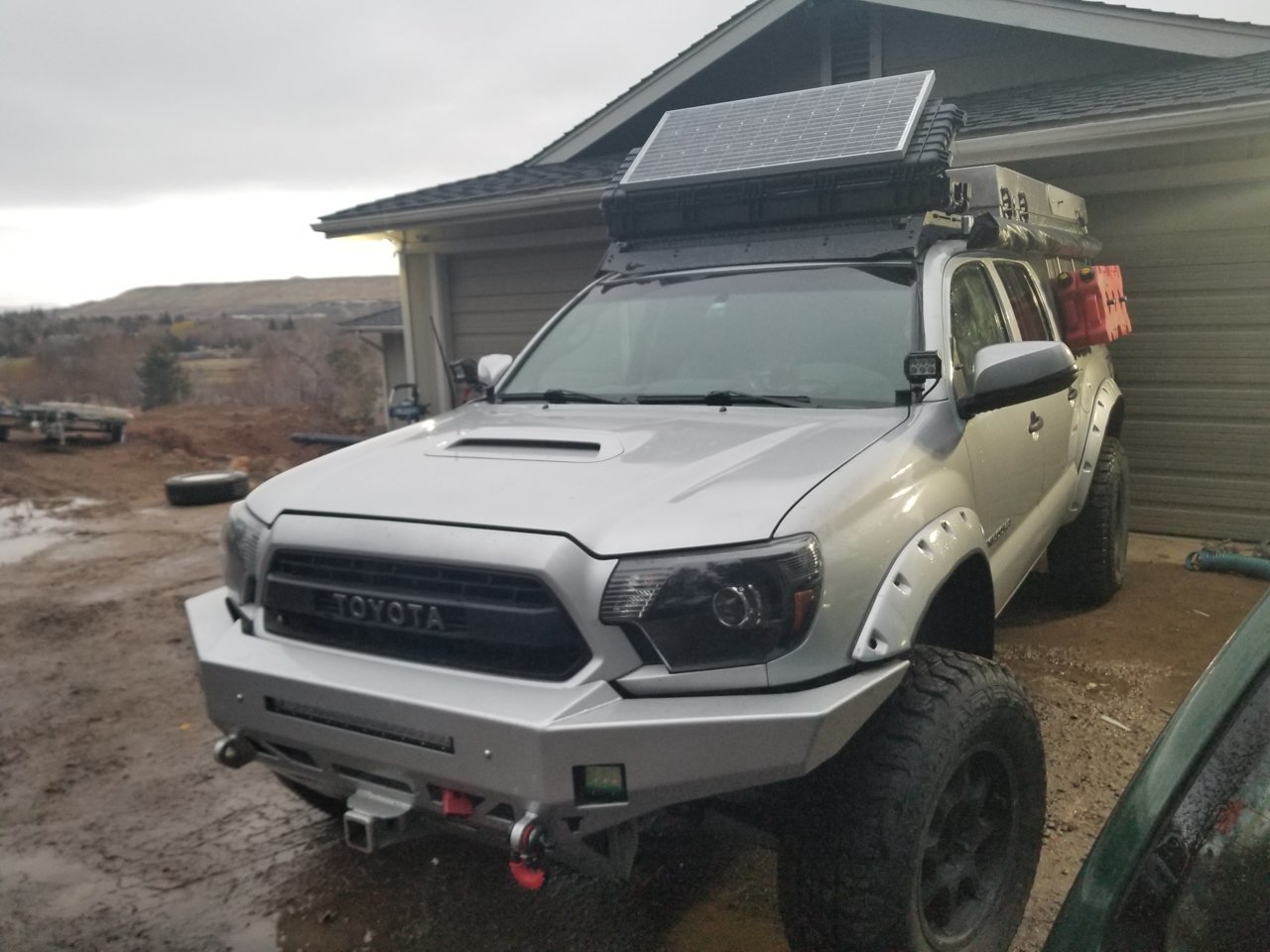

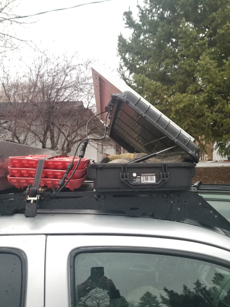

    Put the solar panel on top of my top box to allow me to have it at a 45° angle when situation dictates.

    I made the swing out, here is the original post where I kind of explained the process..... #85 in this thread
    Let me know if you have any questions!
    I do not have any links to anything.. I jut had the idea in my head and made it happen. Bought a Renogy 100w wanderer kit... very easy to install and has everything you need, put four 1/4 x 20 rivnuts in the frame and bolted through the lid of the rifle case. Then put some struts on to hold the lid open. Again if you have any specific questions just let me know!
