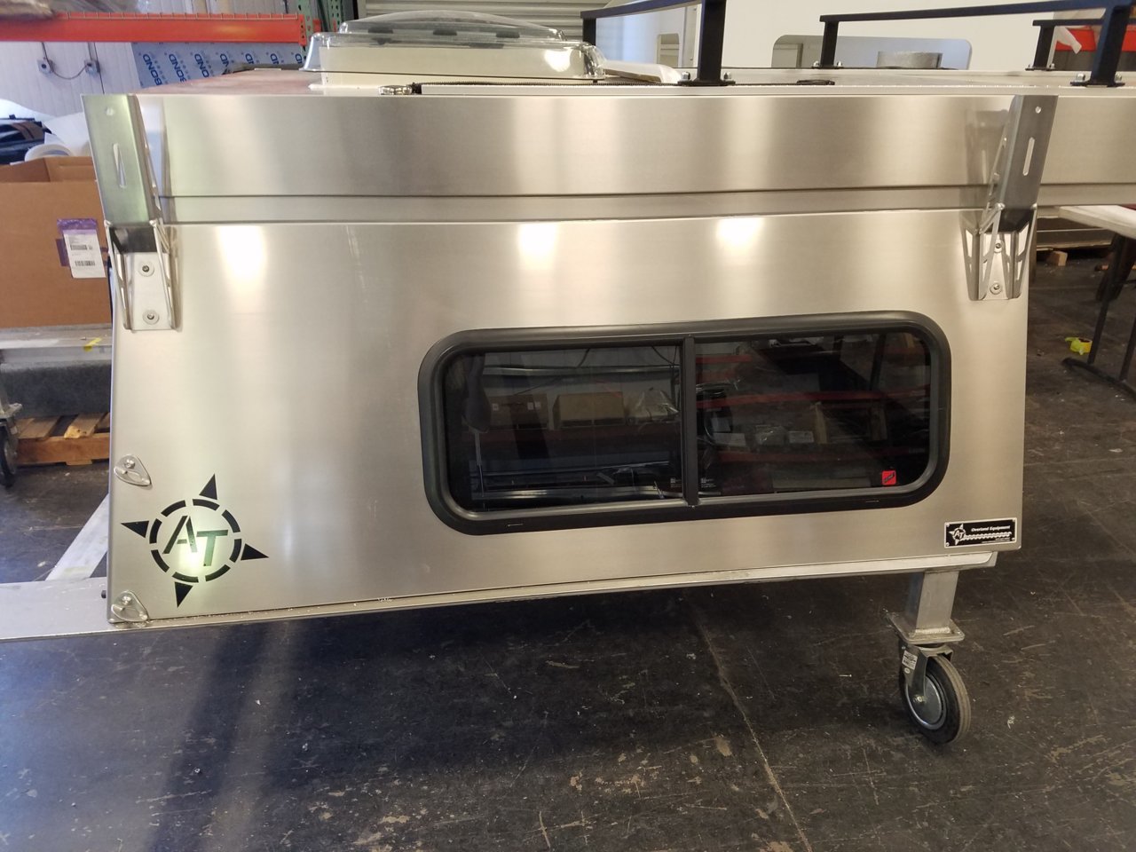

    Downgraded driver, added a sticker.
    Wonder if AT will add those awning mounts, those look pretty good!

    I’m pretty sure those are the mounts they started making for the summit and atlas

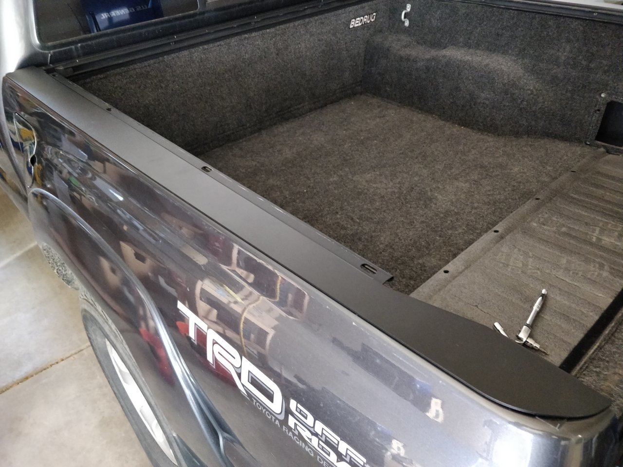

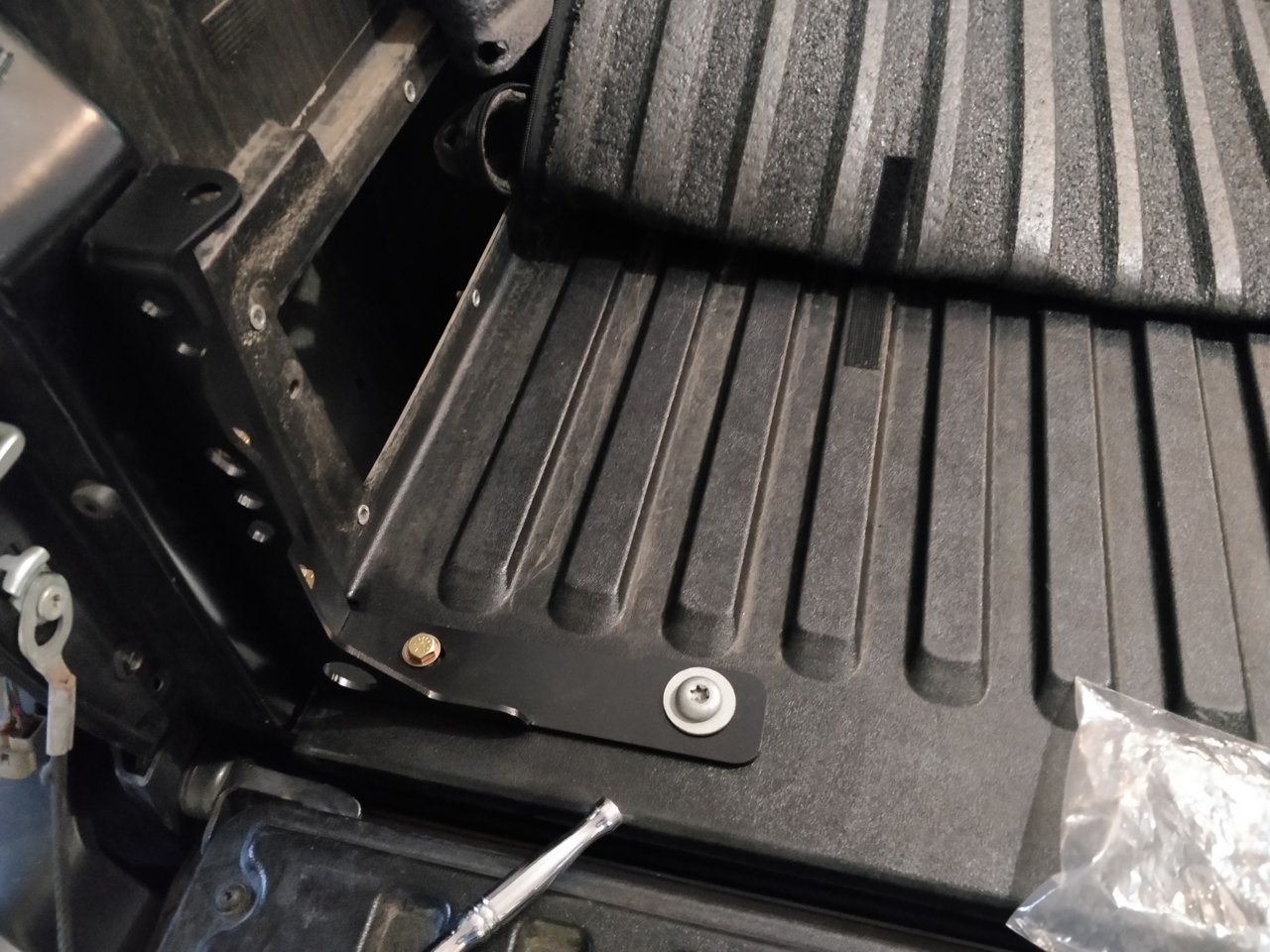

    So I got my habitat installed a few weeks ago. Here's how I wound up doing it.

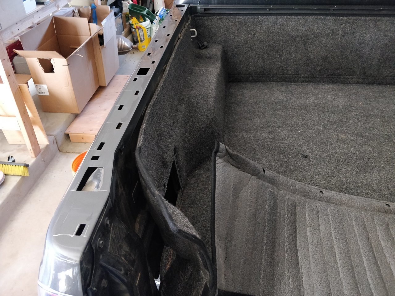

    First installed some ATH bed stiffeners.

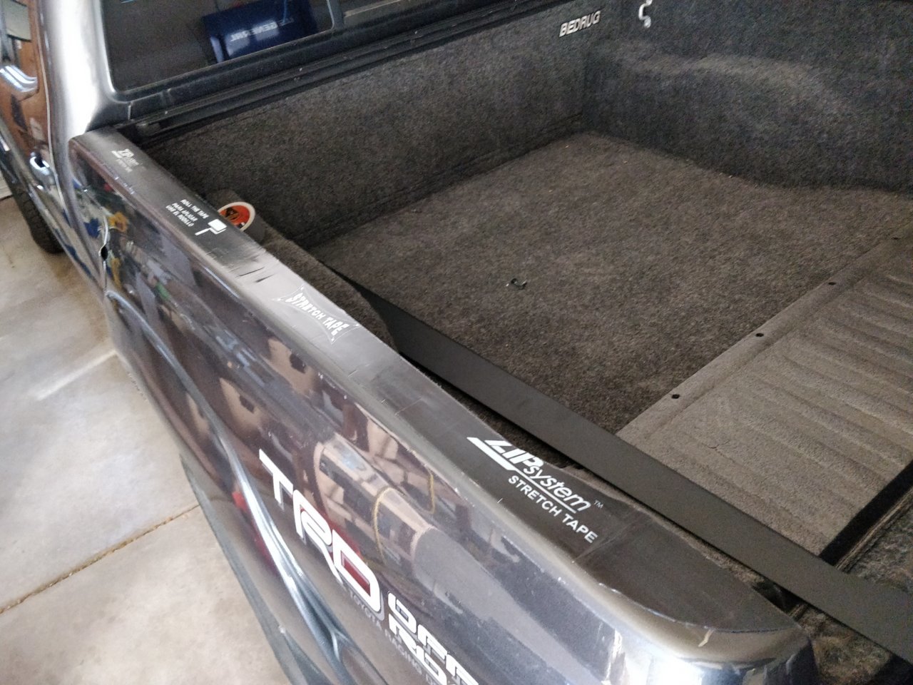

    I decided to use KB Voodoo bed caps to provide a smooth surface for good sealing. Prior to installing them I added window flashing tape on top of the bed sides.

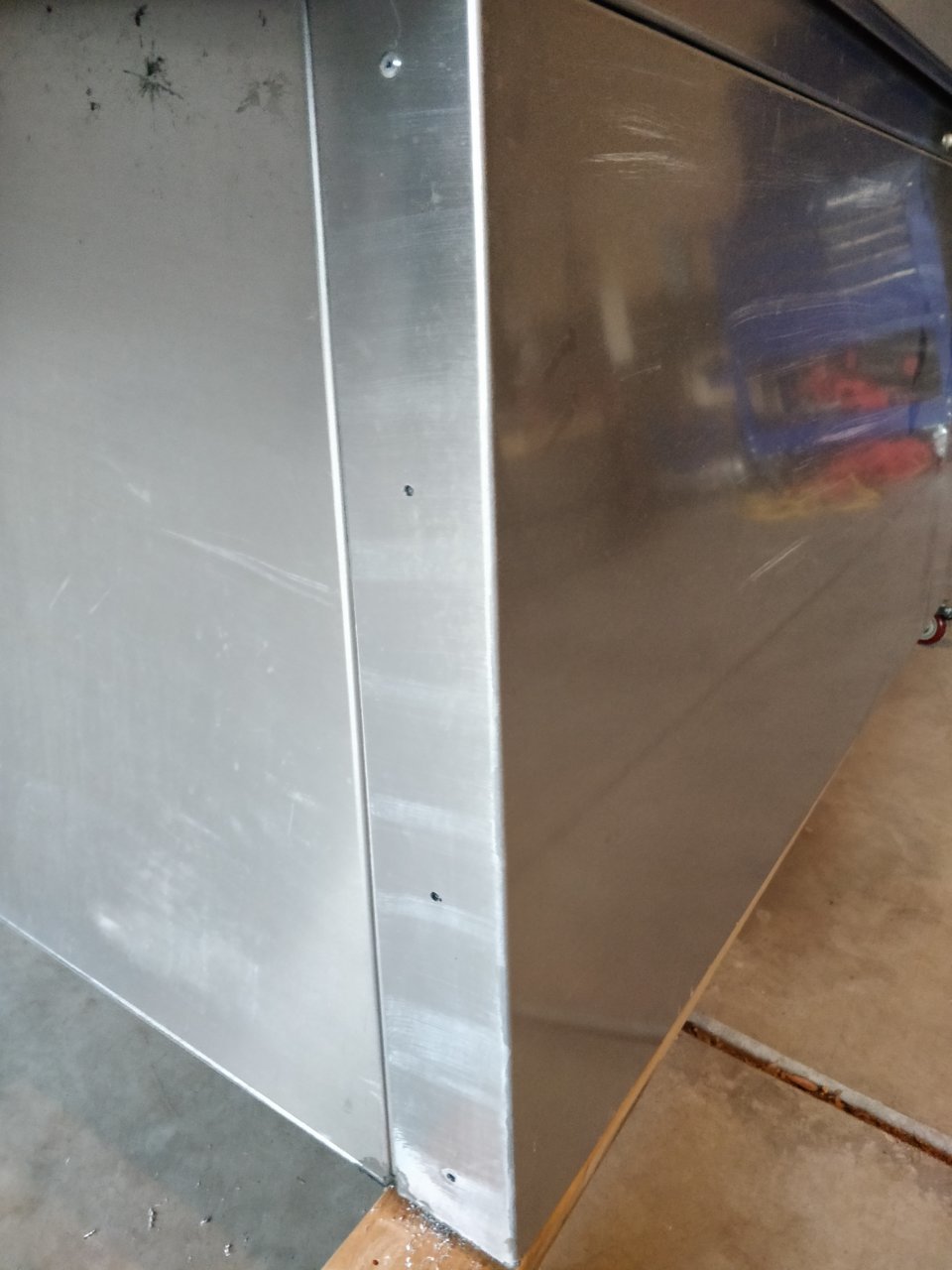

    Then I had to repair the broken rivets on the cab side of the Habitat. I drilled extra holes and added a total of 4 rivets to supplement the one.

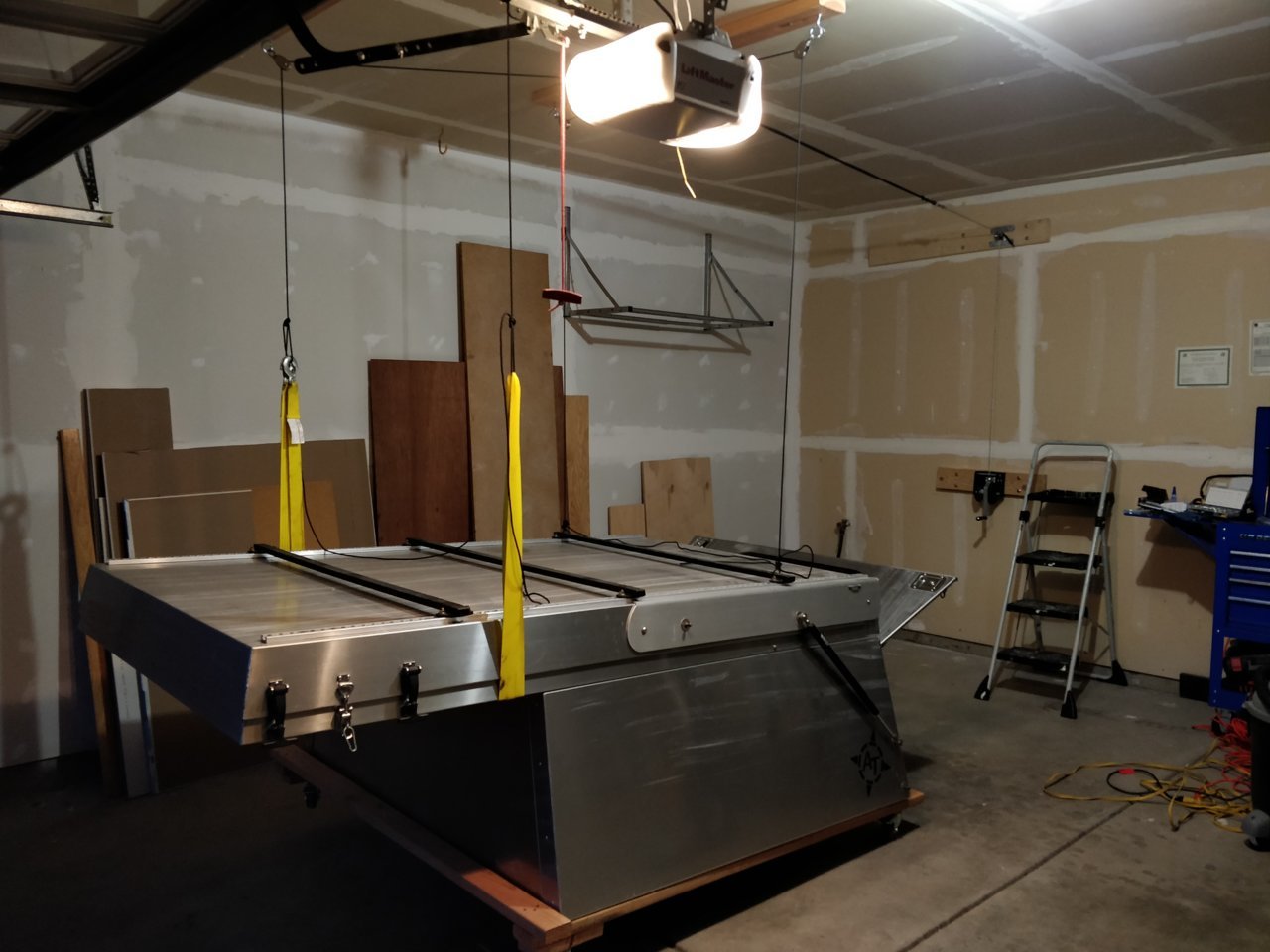

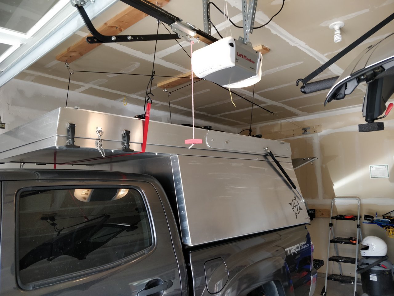

    I have a lift in my garage which made the install nice and easy. Was able to lower it onto my truck perfectly square.

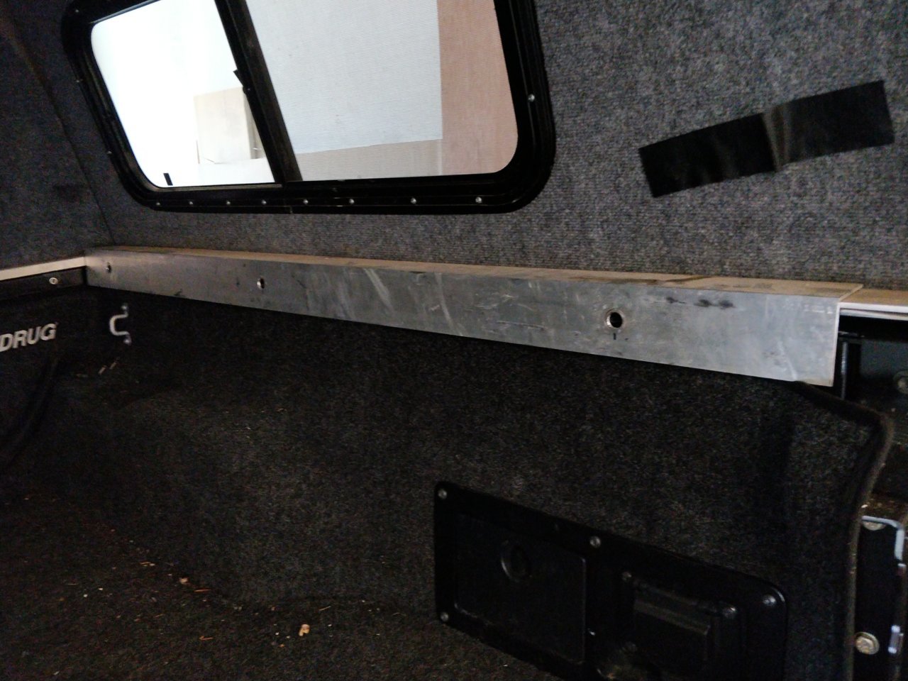

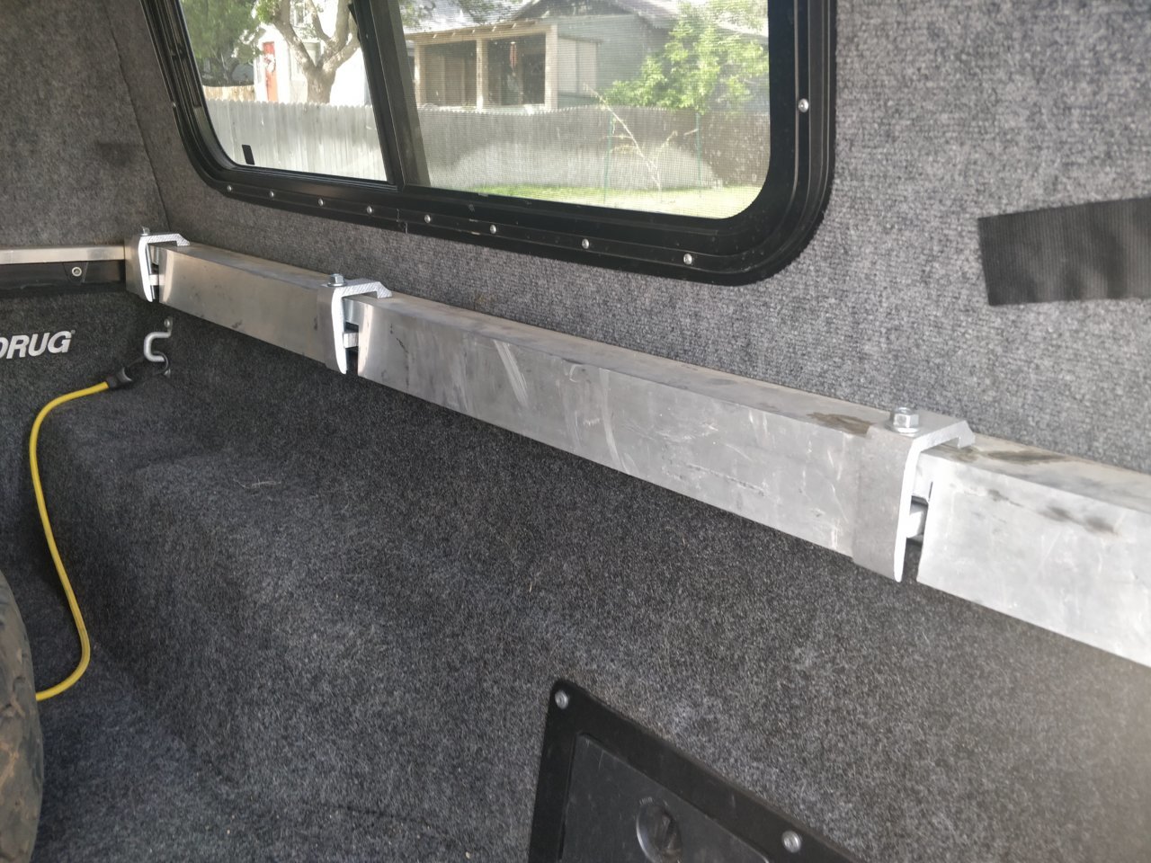

    The guy I bought the Habitat from did not use any bed rails so the holes were too high to use for securing it to the bed. I wound up cutting notches in the angle bar and used c-clamps to secure. I plan to cut or completely remove the angle bar at some point.

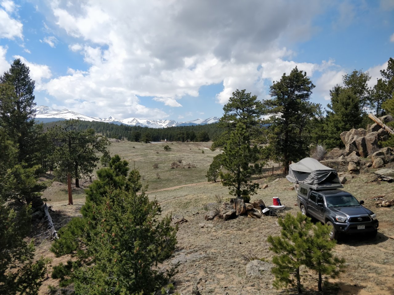

    And was able to put the Habitat to use a week later for a couple nights. What a game changer the Habitat is. Didn't have to worry about finding a smooth flat spot!
    I still need to upgrade the rear suspension. I'm thinking of using a stage 2 or 3 deaver expedition pack, but that likely will prevent me from parking in the garage. Also considering just an AAL with air bags and still fit in the garage.

    @Soccerties Looks good! like your bed rail tape job. those rivets in the front corners are just part of their method when they apply heavy duty double stick tape that holds those corners together, i do not think they add structurally, but replacing and adding more no hurt either. in terms of serious adhesion heavy duty double stick tape, the angle 'irons' are also adhered with that tape, it is nearly impossible to remove those angle.

    Yeah I read the post from the AT owner about the front rivets not being structural. He did follow up and say they use more than one rivet now so I figured I'd do the same.
    As for the angle bar. I'll probably wind up cutting it like another guy on here. Someone did mention they managed to get it off though. Just took a lot of work.

    Your truck looks great, and so does that camp site.

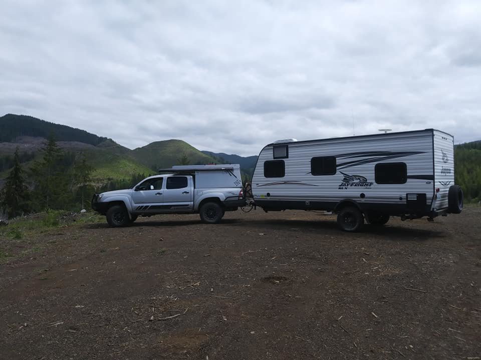

    Deciding to go for something warmer? FWC, travel trailer?
    I had both a Habitat and TT last weekend!!
