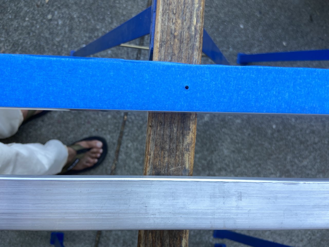

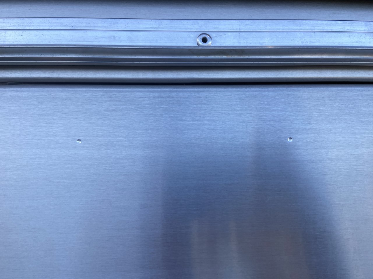

    46 inch undrilled L track arrived today. one side of Habitat
    Template for pilot bit, approximate 5 inch spacing

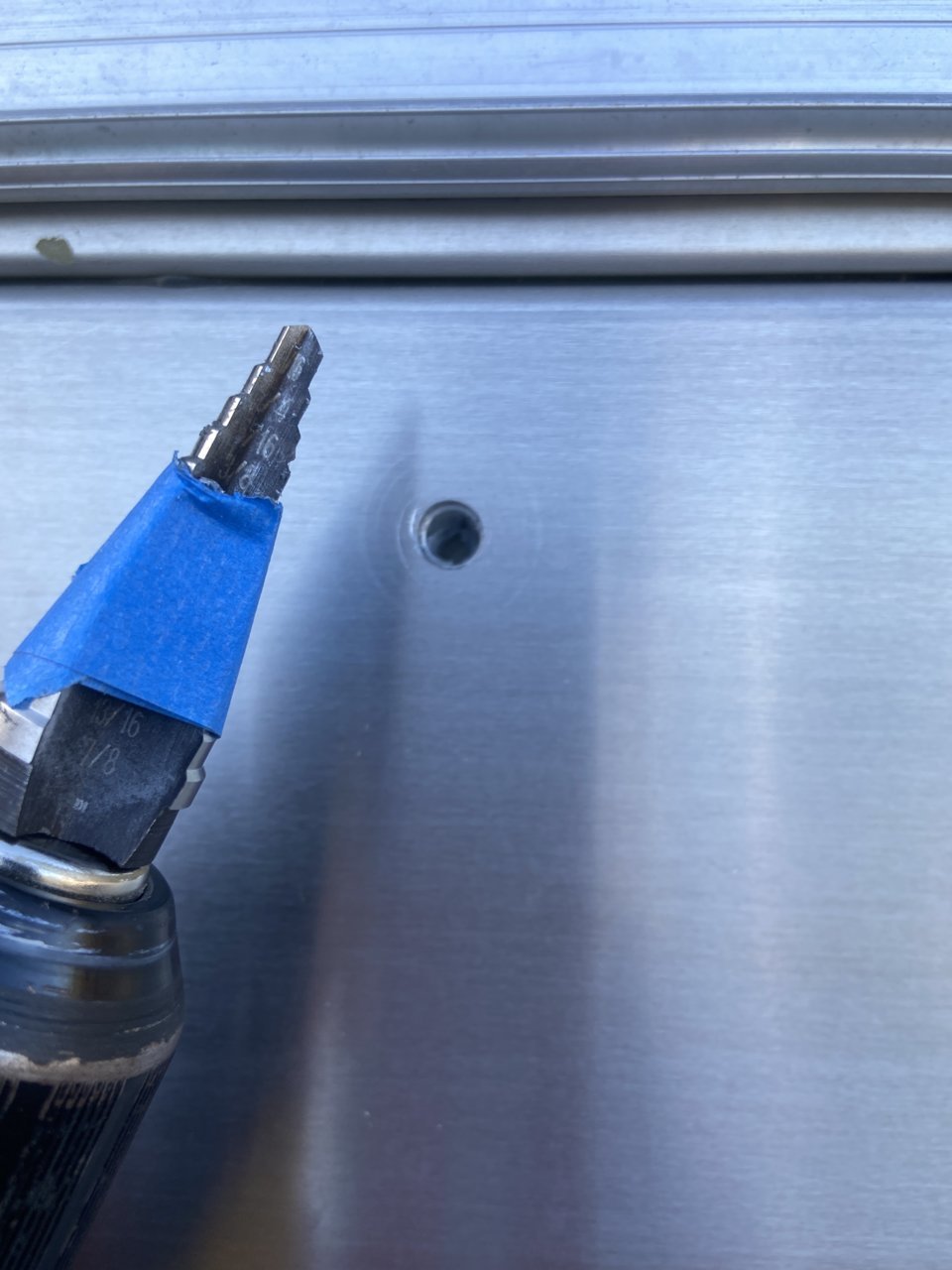

    pilot hole enlarged to 1/8 inch and L-track templated Habitat for drill marks. Blue tape gives grip while L-track held and taped for all marks
    1/2 inch 82* 6-flute countersink after enlarge hole to 1/4 inch

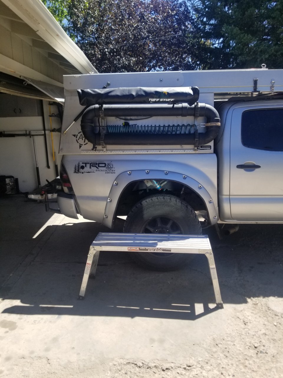

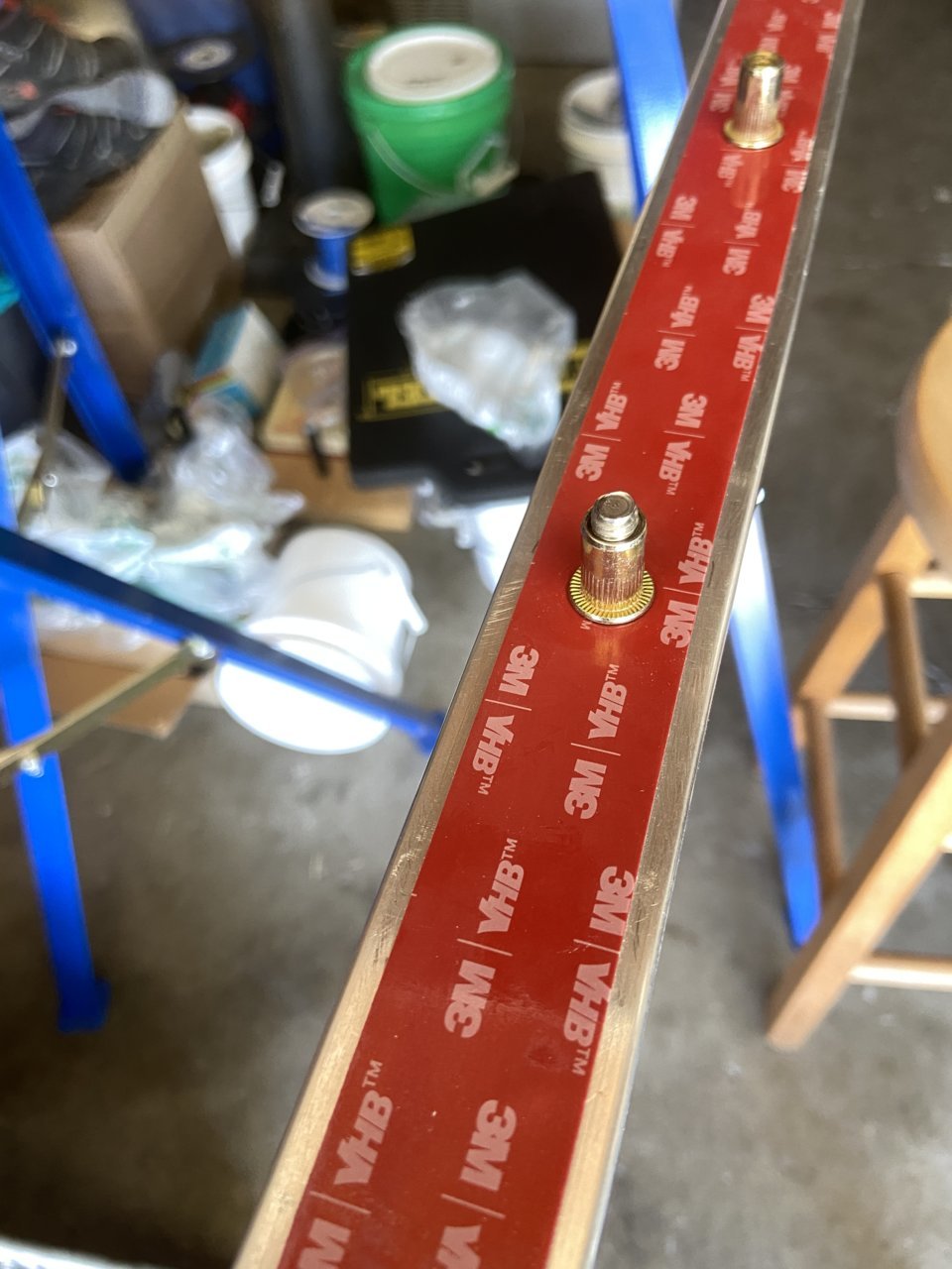

    Had VHB tape on hand. chose to use as 'sealant' and 'adhesive' for L-track. riv-nuts located as indicators for cutting tape for clearance when mounted.

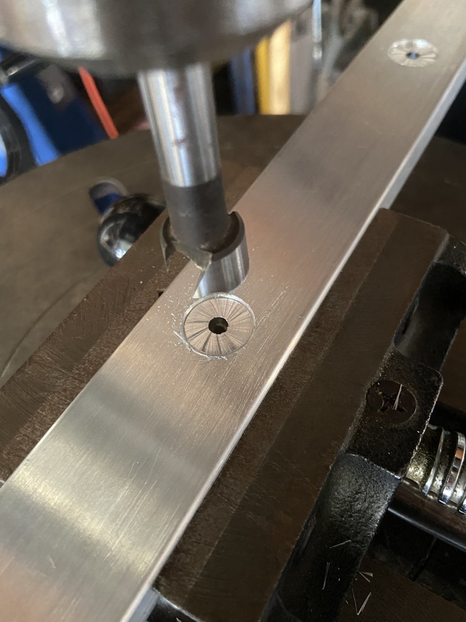

    The L-track I mounted yesterday is permanently affixed due to the VHB tape used. The mounting of this upper rail does not look as clean as I had envisioned, but will be functional. Today mounted the lower rail with an additional operation consisting of inappropriate tool use in that I cut 5/8 inch clearance backside of the rail with a Forstner bit. Forstner bit is a tool for wood only. End result with much better appearance with lower L-track permanently attached to Habitat. other issue was snapping the Astro tool mandrel off inside a riv-nut, tool needs a replacement part and riv-nut is useless. no worry, have enough screws and rivnuts placed. another step or two and I'll be able to mount a 4 gallon rotopax on the side wall of the Habitat, and be able to fuel up, and then siphon off as needed...just like OP.. In the past I have found a 4 gallon Rotopax can of gas was too much for me to handle and i stopped useing it after having a hard time in a snow storm cuz fingers got too cold and CARB funnel was junk. Being able to mount the 4 gal. can on the sidewall will be a treat. end of posting. last photo.

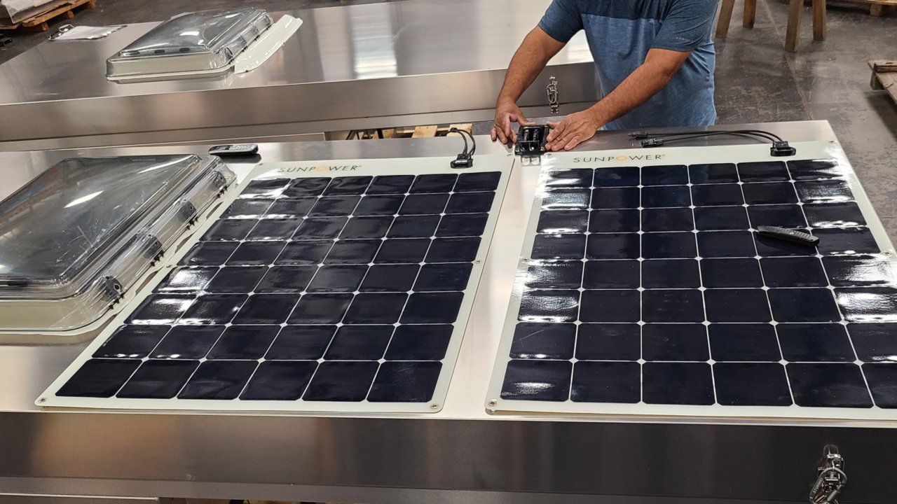

    The crew at AT Overland are pretty awesome. They called and talked last week for a long time about solar panels and placement and took the time to get everything laid out perfectly for the roof of my Atlas. I'm picking it up Friday morning and I couldn't be more excited.
