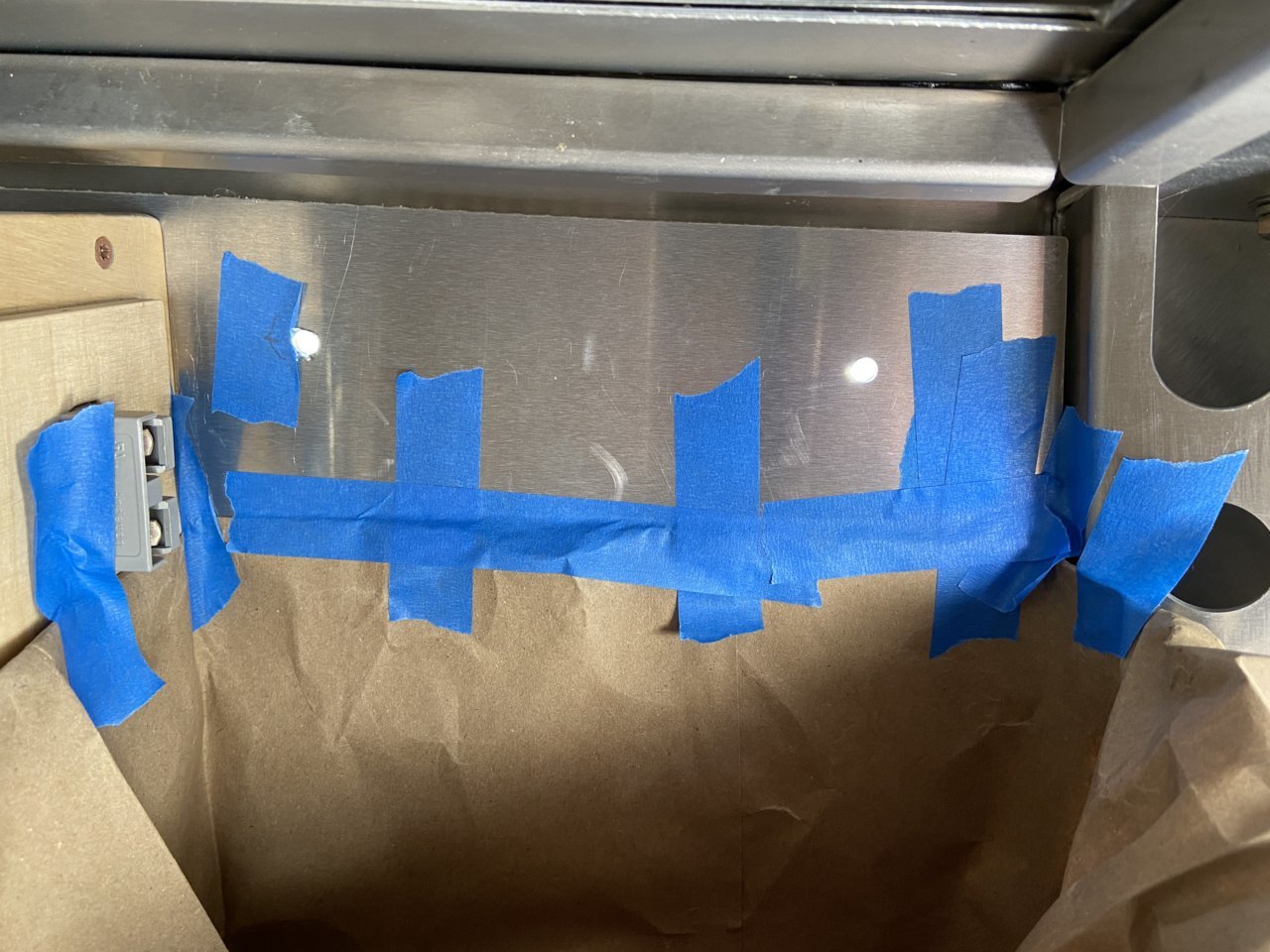

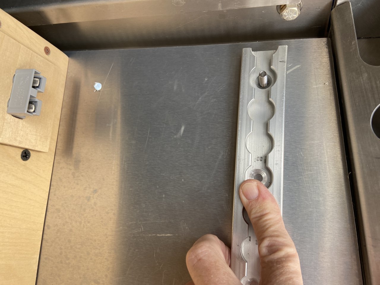

    sawbladeduller
    sawbladeduller semi-realist
    Oct 3, 2014
    #139583
    1,171
    North Cal
    '15 DCSB '98 2.7L
    fully zip tied
    going with your thought, and my earliest idea about L-track mounting, today I put my first two Thru-holes into the Hab. So photo below. The Hab wall has the aluminum sandwiched 'honeycomb', and attached to the outer skin. Thats two layers of aluminum on the skin, that made me wonder about the length of the Riv-nut and how well it 'mushrooms' when placed with the astro tool. Clearly putting a thru-bolt is a better option now that I look at it, IMO. After two drillings I'm taking a break for coffee and a post. I have had previous difficulty trying to drill a hole thru multiple panels in a PerPendicular (plumb) manner. Unfounded concern here. I use a Step-Bit to make the first skin puncture, a very clean hole. This piece of L-track has three Riv-nuts where I have the inside cabinet, and seven thru holes. I buy the L-track with no holes and drill and countersink where I want,PITA.
    excorcist[QUOTED][OP] and Rude1 like this.
