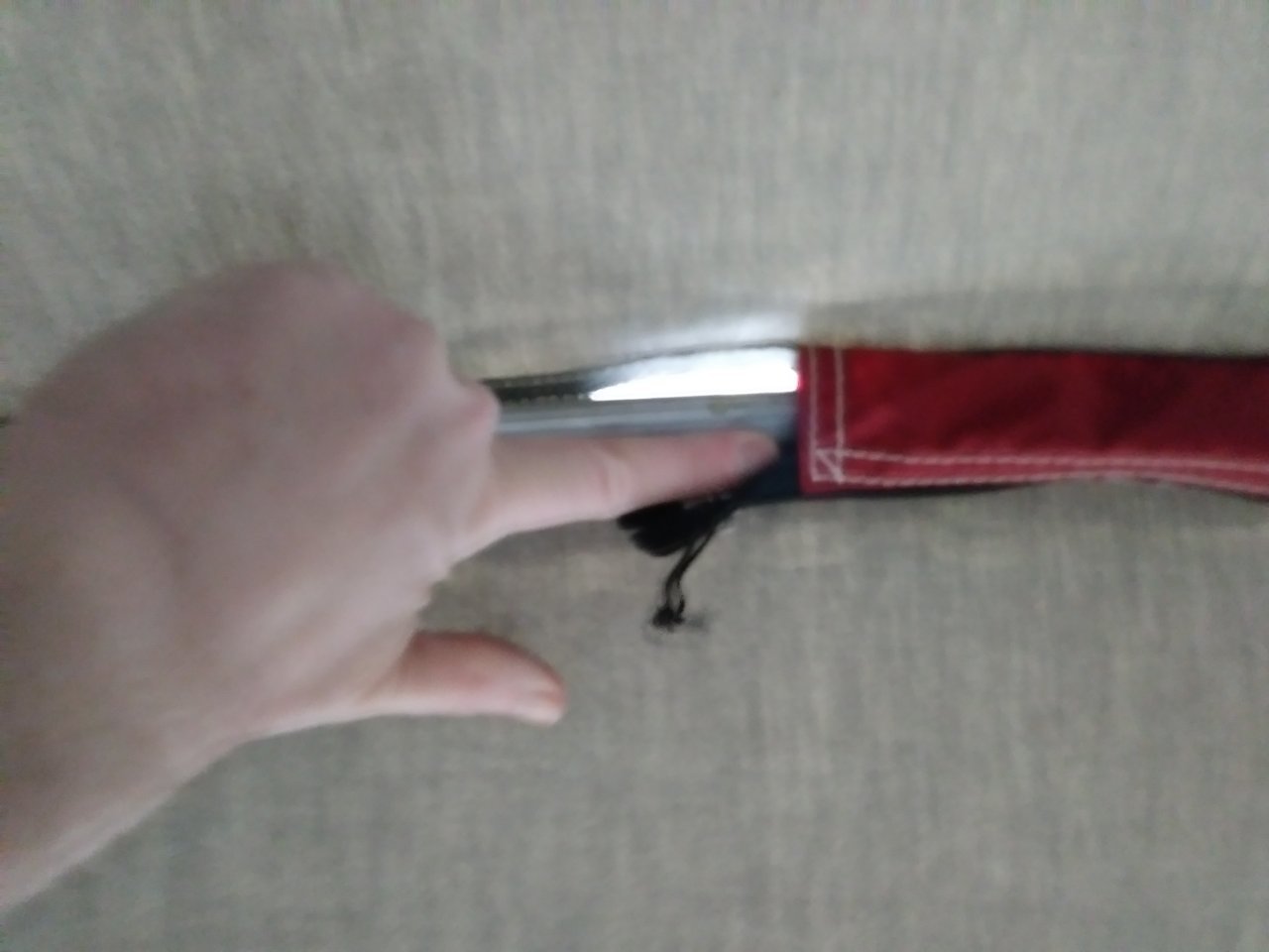

    Had Habitat open in buddy's garage to dry, after camping in the rain night before. Had to pull in with habitat open since couldn't open inside. When driving out I just barely caught a screw head on the door...

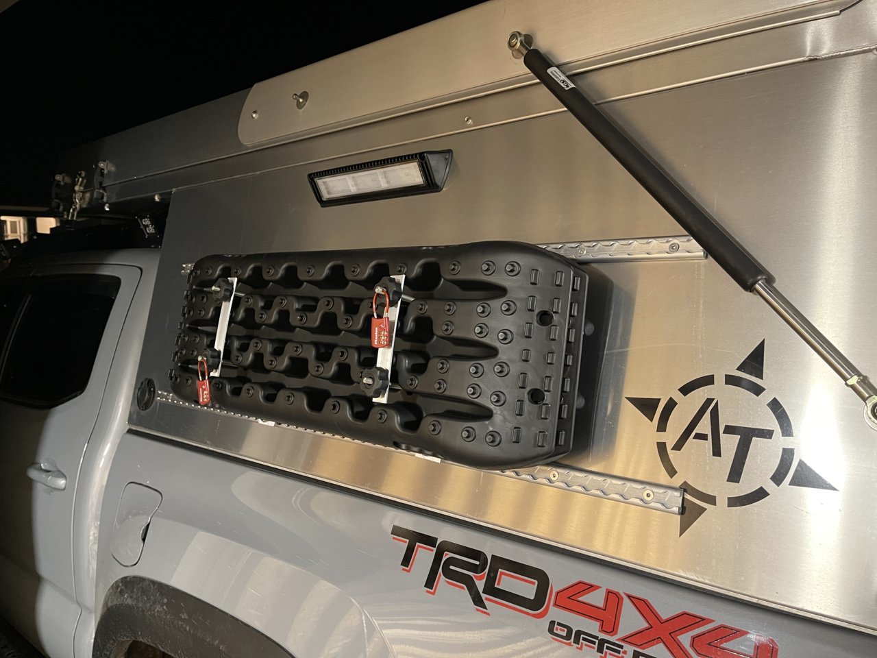

    Added l track to the side and it’s awesome. If anyone is looking to add some stuff to the sides of your topper I highly recommend.
