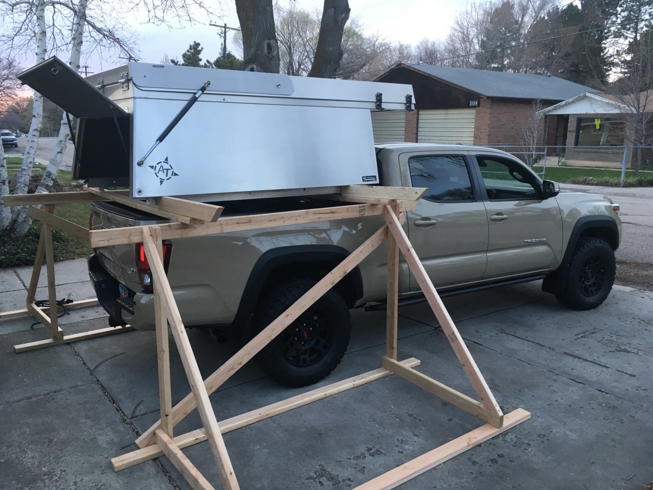

    You could try slipping 2x8 wooden boards which are 2-3 feet wider than the camper, under the base of the camper, and then have a few friends lift the boards up (and thus raising the camper) as the truck is driven forward.
    This would then allow those holding the camper up to simply lower it safely to the ground. I learned this trick during my last life when i was an Egyptian pyramid builder, obviously.

    That is a good idea, Probably could even use some saw horses or some other sort of stand on each side, and if need be do it all yourself by jacking up small amounts at a time on each side and slipping 2x4s under there.

    This is what I was thinking for lowering it, just wasn't sure how i'd come up with enough strong guys to handle it, lol.
    Something like that was my original thought when planning to swap from truck to truck, but once it was decided to just drop onto a trailer wasn't sure how it would work.

    This is from the post @sawbladeduller mentioned of @Rude1's setup to swap from truck to truck.

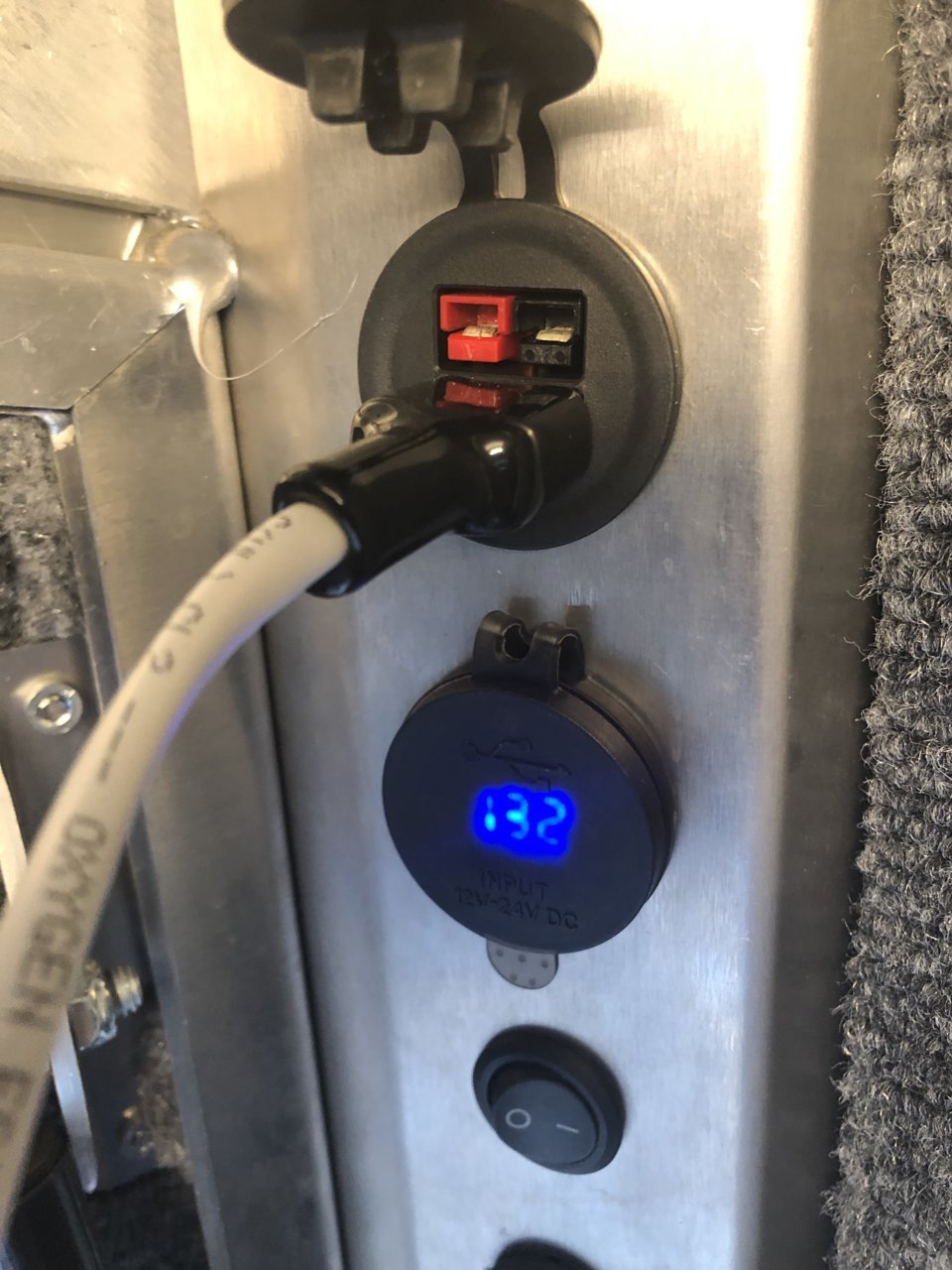

    What kind of switches did y’all use in the pillar? Because my simple switches are NOT fitting
    These worked for me:https://www.amazon.com/gp/product/B07K118ZM4/ref=ppx_yo_dt_b_search_asin_title?ie=UTF8&psc=1 I looked high and low for something better, i don't want back lit at all. Don't want the parasitic draw. I'm just running a few of those stick on LED strips off each of the switches. Anything more than .5amps you'd probably want a higher rated swtich. I have some other switches coming.
    Flag connectors helped everything fit in the posts :https://www.amazon.com/gp/product/B07KN6R37N/ref=ppx_yo_dt_b_search_asin_title?ie=UTF8&psc=1 is a pretty tight fit if you use the standard straight connectors.

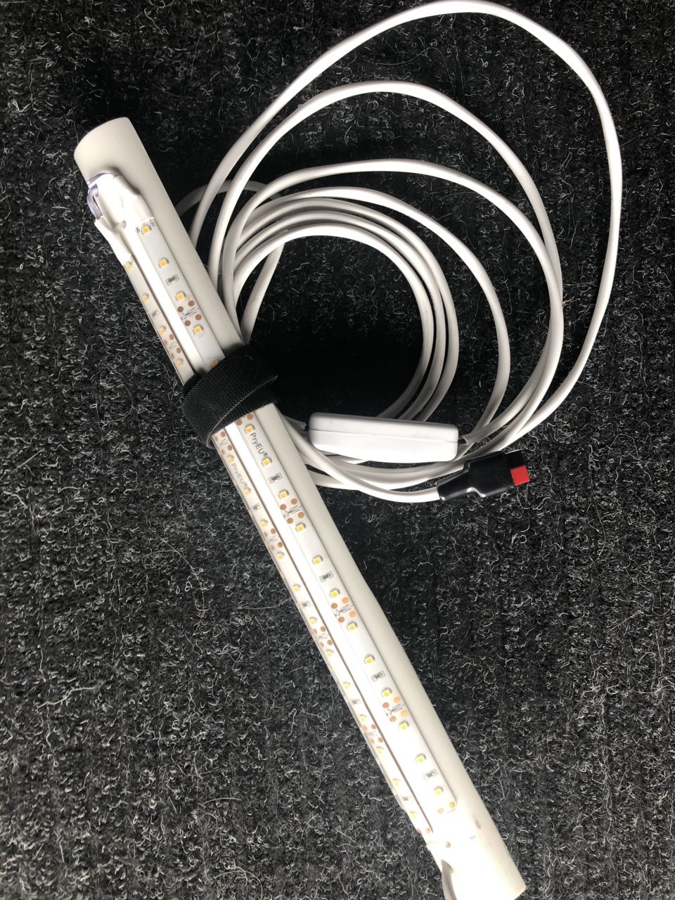

    I used these instead of the cigarette type adapter and updated the plugs on the fridge to work :https://powerwerx.com/panelpole-panel-mount-powerpole-housing I had the cigarette adapter slip out once and now I don't have to worry about the plug sliding out when bouncing down the road. I also rigged up a LED light, split a 1 1/4" piece of pvc and added 3 of those little stick on LED strips, then wired an inline switch to a plug. I use velcor straps to strap it to the top/middle tent support bar and plug it in.

    no problem getting them to pop into the holes?

    I push them in till they stick then give em a good wack with the heal of my hand. Worked. Mine's a mid 2018 habitat.

    Have you tried to remove them?! Haha
    good info tho! I have some new switches in the mail that are supposed to be smaller so maybe that’ll help
