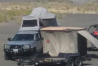

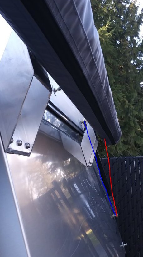

    It's due to how far out the lower mount of the strut is. It's mounted so much lower on the side of the Habitat, where it is wider. When you open the habitat and it's straight up at the struts fullest extension it hits (see lines on the pic below). It does NOT stay tight to the truck, as the angles change. That's why I had to add the washers. I thought it would clear... but it was hitting... just barely, but enough it wouldn't go buy without possibly breaking something.
    The awning was still within the width of the truck, so unless you were way off camber by a tree it was never a big deal. Image below shows the awning room and how it still draped against the side of the truck.

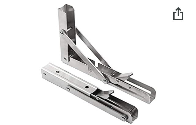

    We’d roll with it in the qd mounts, then pop 1/2 (or 2/3) mounts and swing out to clear the hab deployment, then back on. Or pop 2/2 (or 3/3) mounts and pull it off completely. Add an extra set of truck side pins to the other side for a choice of passenger or driver sided awning.
    I’ve got a set of these coming as a proof of concept for another idea.

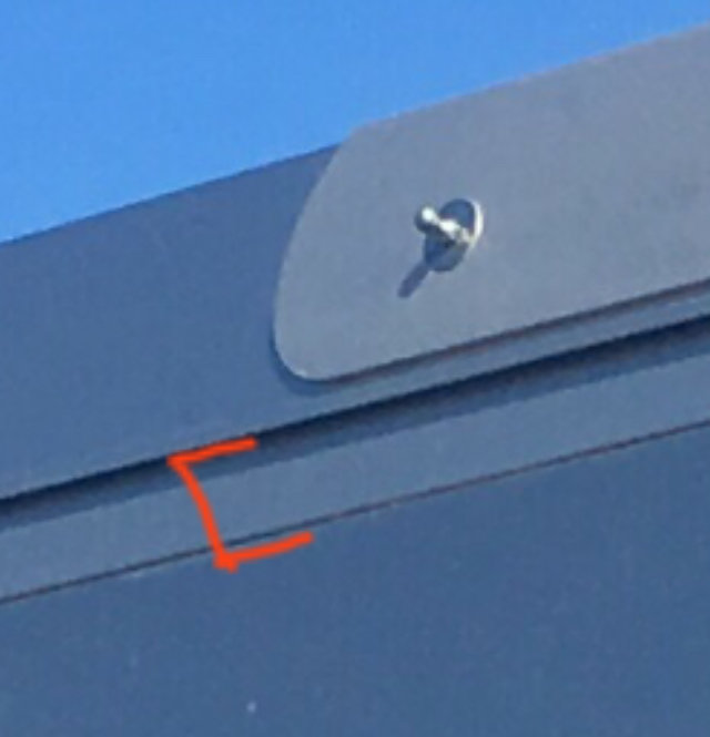

    Can anyone grab me this measurement?E0B16EA6-AFF8-45E5-9607-84DAF4CF19AB.jpg

    I feel this measurement can vary depending on how tight the latches are so just keep that in mind. Probably a small variance but worth noting

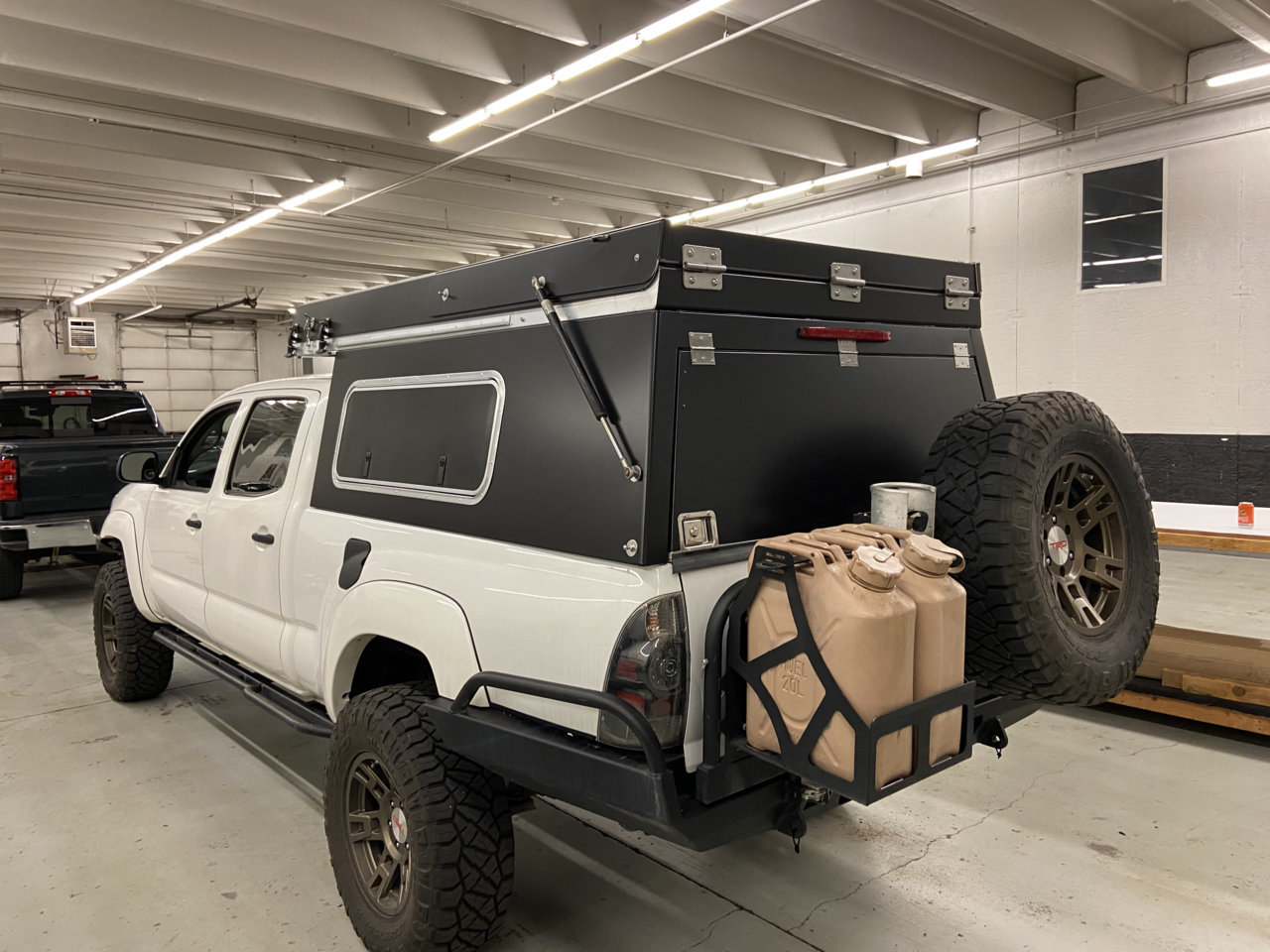

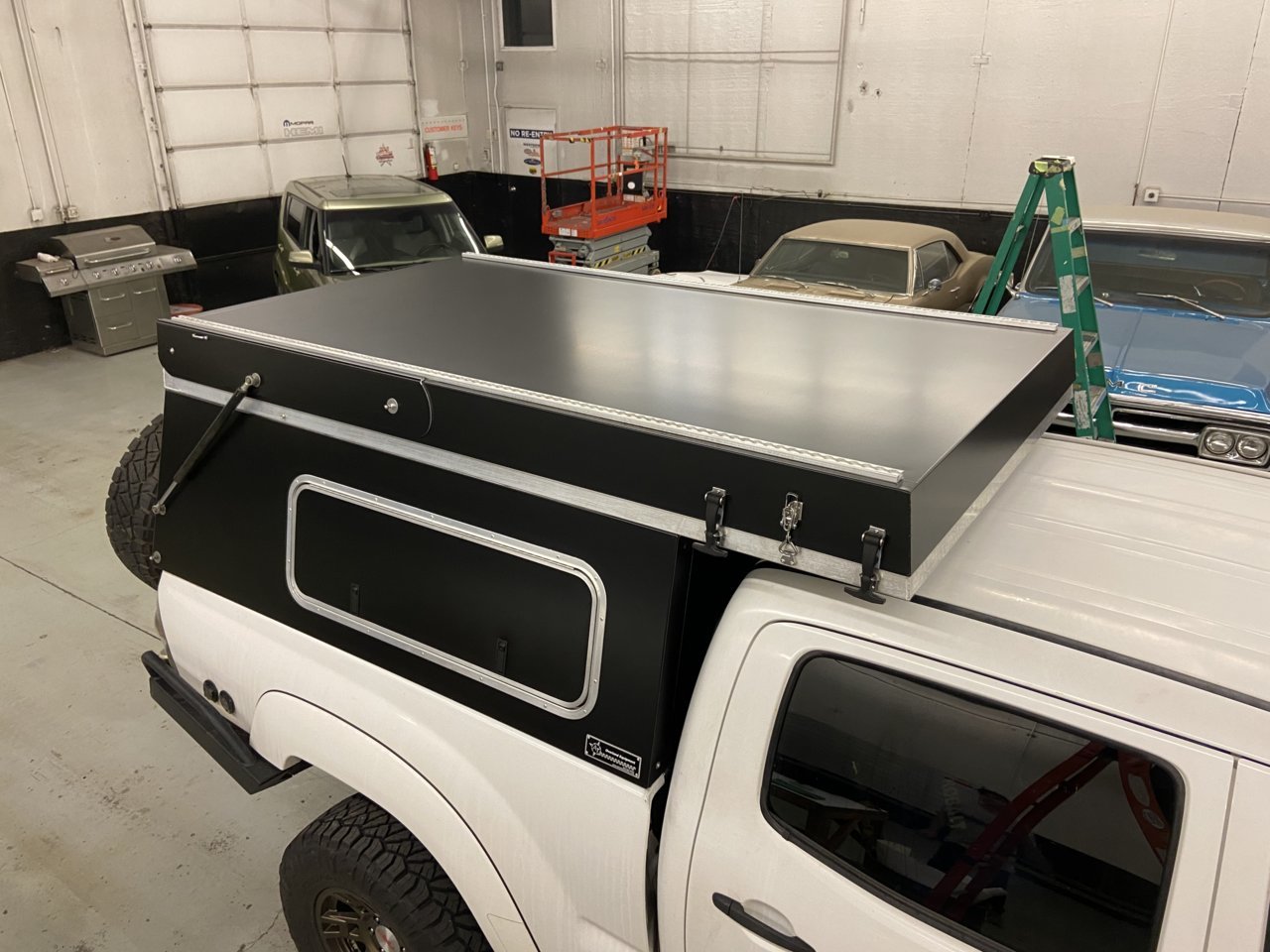

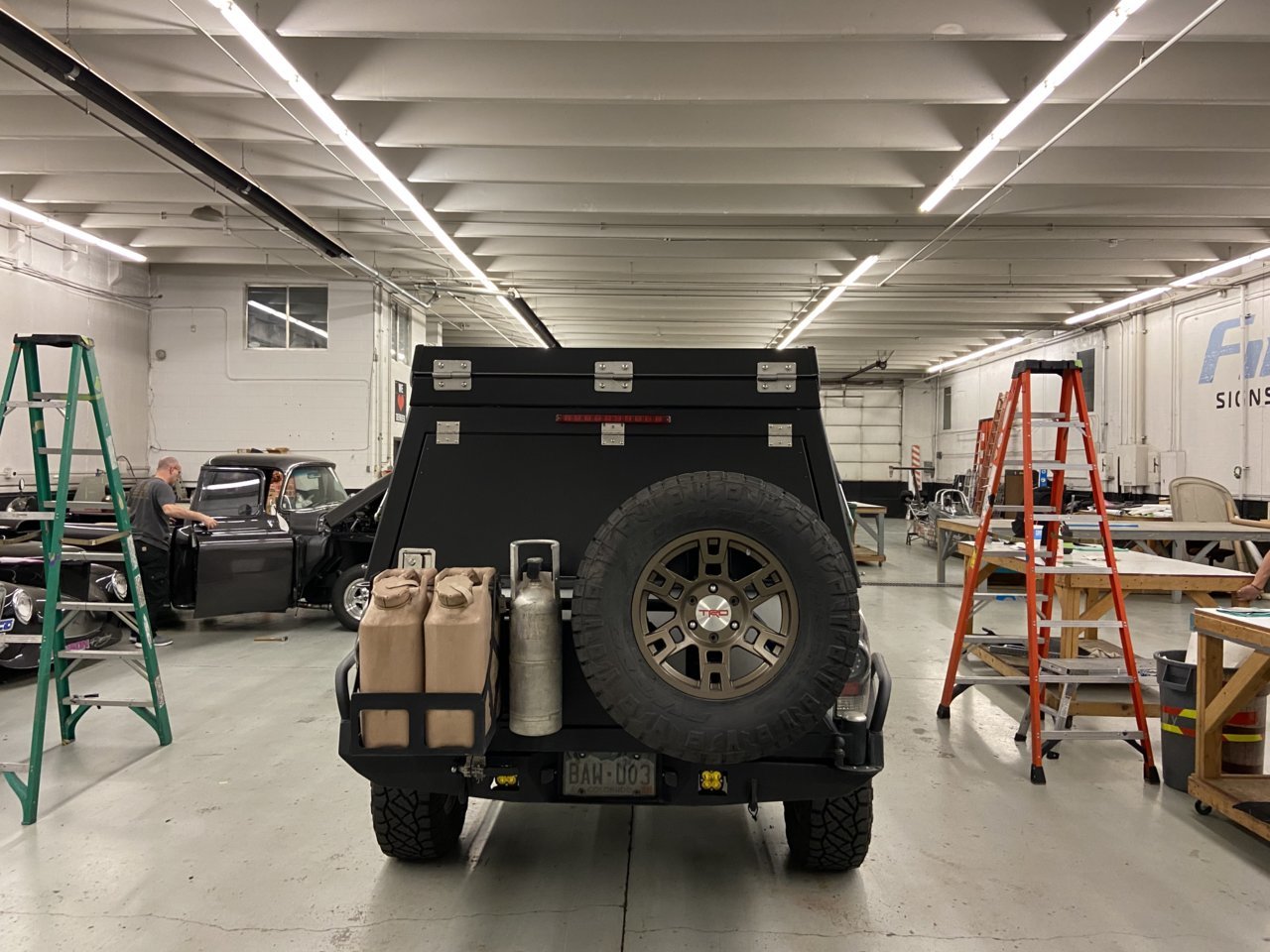

    Wrapped the AT in satin black today
    2155EA1A-A9FC-4B8C-8627-BABC05308EC6.jpg 91660B24-4A50-4929-89C4-54E3CA9BC3B3.jpg D8570D0A-1B00-4DA4-A3DD-EF17EF48D5C1.jpg

    Looks good bro, dont fight the tree sap bro...just let it be part of the experience.
    My satin wrap was the bomb...tree sap was my nemesis.

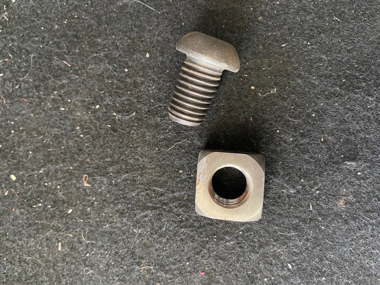

    While getting my habitat wrapped, i had a mounting bolt get seized in the nut in the bed track so i had to cut the button head off of it. As apart of this process, i determined the bolt was seized and the square nut was actually spinning in the track so it was a double whammy. The square nuts are never centered vertically in the track so by default the bolt would thread at an angle easily.
    I decided to replace the entire setup with something that wont allow this issue to happen again. I bought aluminum t slot nuts from Amazon and replaced the 1" 5/8 zinc button head bolts with 1" 3/8 grade 8 bolts. Smaller but stronger. Socket head rather than hex button head. The t slot nuts will not move in the track like the square nuts did. Note that i used extra thick washer so they were strong and didnt bend when being torqued down.
    Overall, i think this will be a huge improvement and reduce issues in the future so i thought id share.
    BEFORE
    AFTER
    T Slot Nuts

    Looks like others have had the same issue and did the same upgrade.

    I was worried those would be seized up when I was preparing to remove my Habitat. I took the truck to my buddy's in case I needed his help and power tools. Every one of them came loose with a quick turn of a ratchet. I must have been a lucky one. 2.5 years or so on the truck.
