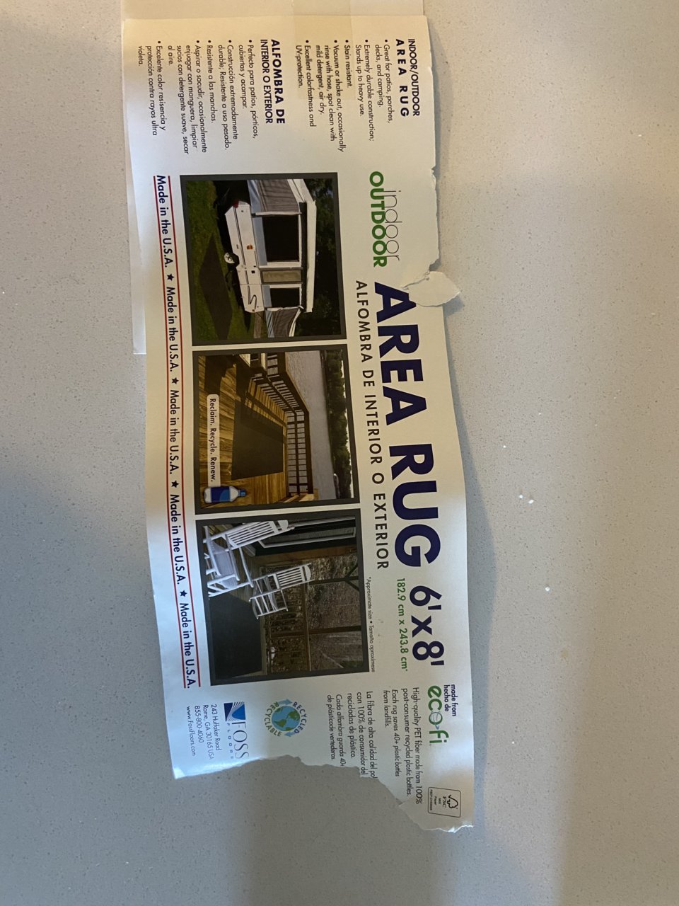

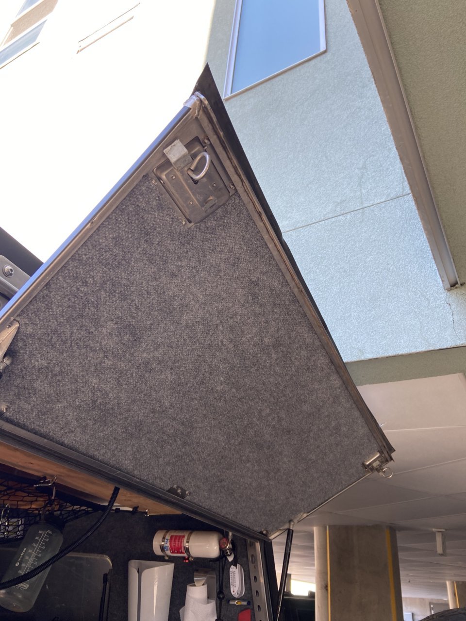

    Added carpet to my doors and rear hatch. Found a perfect match for the carpet at Home Depot for $20 per roll.

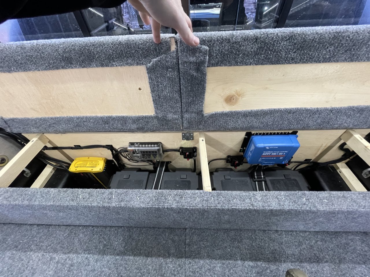

    Here’s some updated pictures of the mods I’ve made to my build. Figured this would help give other people ideas if they are doing the same. Any input or ideas anyone else have would be greatly appreciated

    looks good! love my Victron devices!

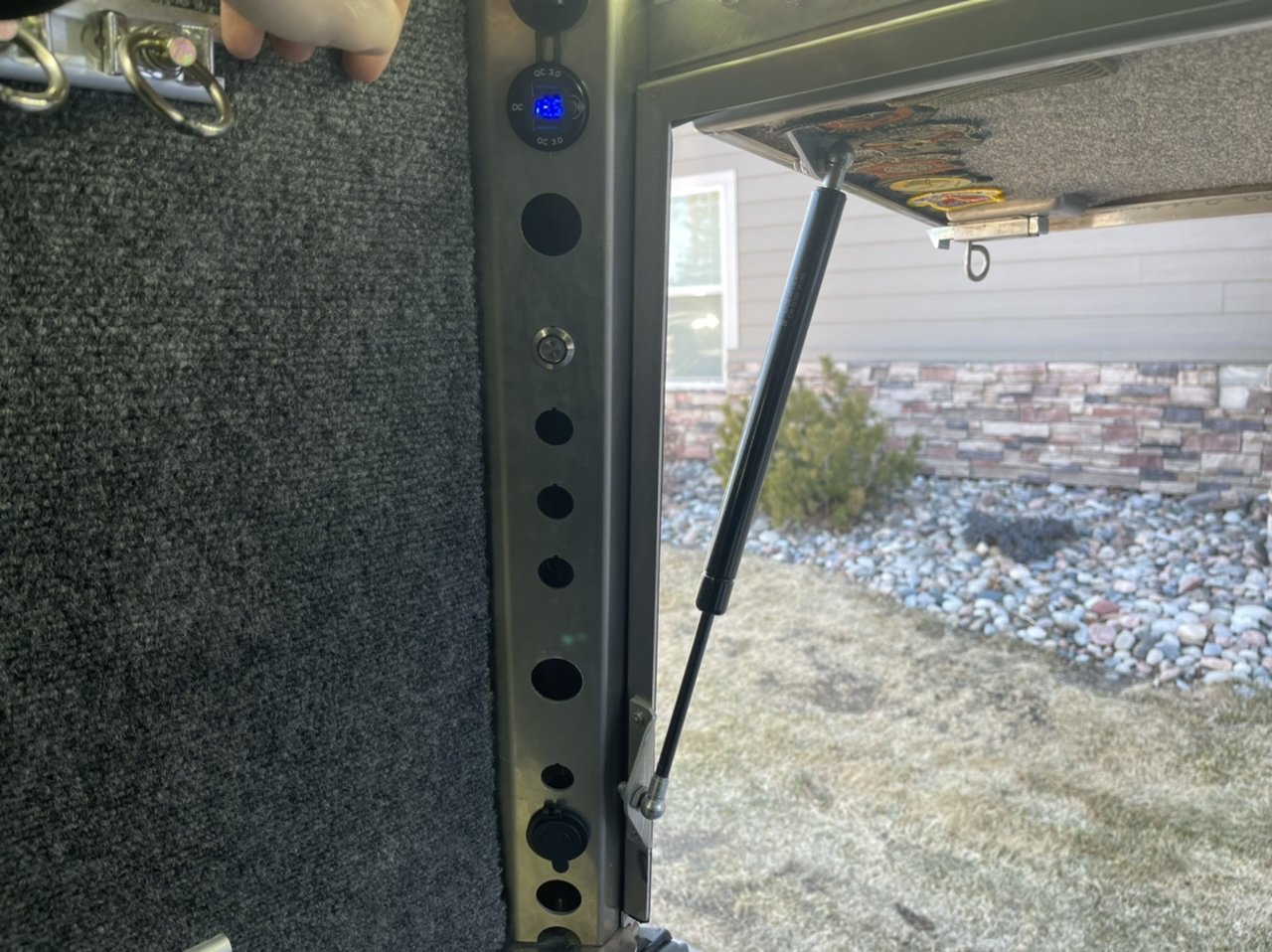

    FWIW - I have been trying to add the carpet and replace the gas struts on the rear hatch for 4 weeks now. AT claimed the carpet was special from the mill and that the Suspa C16-24193 strut was a special strut only they could source. They made it seem like it was all custom and i could only get it from them. So i kept trying to order and they would never send me an invoice. I called and emailed multiple times over the 4 week period and it seemed like my order was not a priority. After getting frustrated, i went on the search for these items on my own.
    I found the exact match for the carpet at Home Depot for $20 a roll. - https://www.homedepot.com/p/Foss-Un...ndoor-Outdoor-Area-Rug-CP45N41PJ1VH/202800194
    I found the Suspa C16-24193 strut on the Suspa website for $32 ($10 cheaper then what AT quoted me for replacements). - https://shop.suspa.com/c16-24193-gas-spring-p585.aspx
    The point of this is to share that these items are NOT that special and if you need replacements for worn parts, it probably easier and faster to just get them from the source rather than AT so i wanted to share the links.

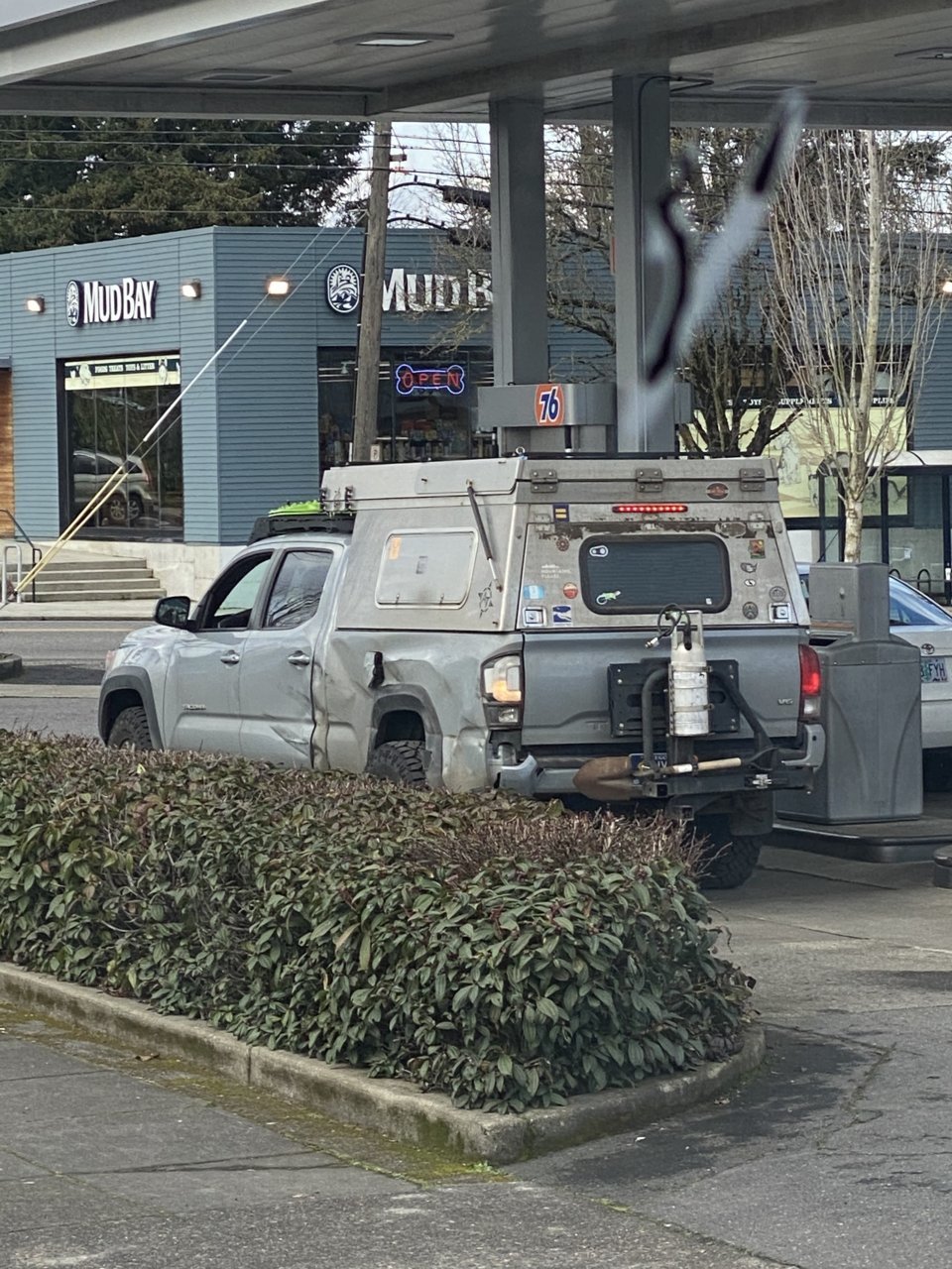

    Just saw this in the local spotted thread:

    I think you need more 110v outlets :D

    Looks like someone had a bad day but the habitat seems to have survived

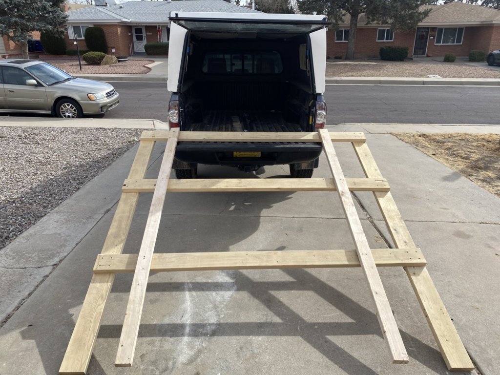

    looks like you’ve already solved your issue but for others that are looking to do the same.
    I take my FlipPac off with 4 people and it’s pretty easy. I built a dolly with some 1”x6”, 2”x4” boards, and castors.
    - unbolt FlipPac
    - get inside and lift the back end up and shimmy dolly under.
    - move toward front and lift and and shimmy dolly and FlipPac.
    - one person each corner and slide and dolly to the tailgate.
    - pick up and set on tailgate to reset.
    - lift on tailgate and set on ground.
    The whole operation takes 5 minuets of you e for 3 other bodies.

    Ooof. She took a beating, but solid pass on that Hab!

    truck looks good in that 'i use it kind of way'. good to see a shovel. dont like the propane hose just hang'n..looks like decent tires..envy the body color.
