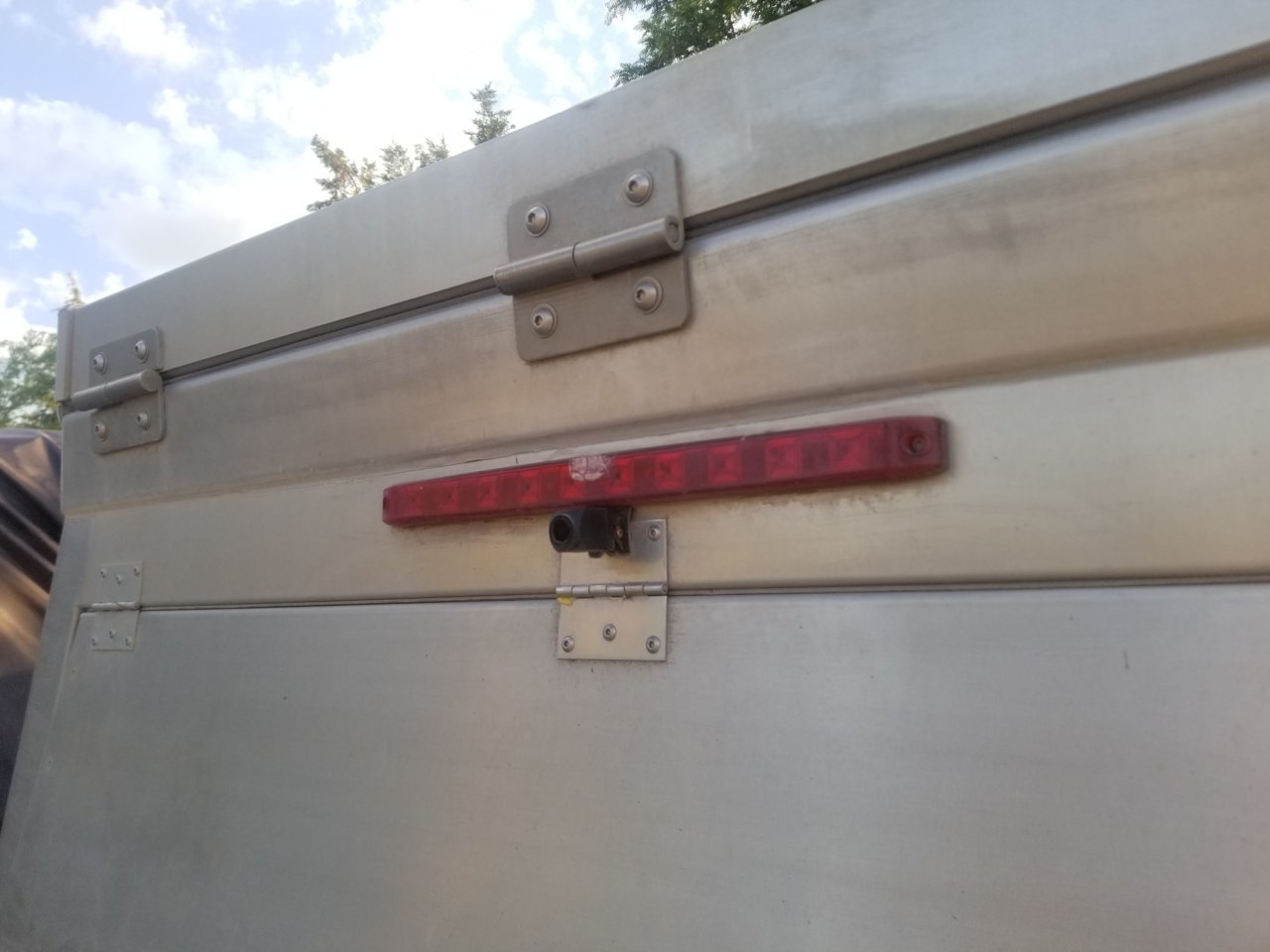

    I don't have a cab side window on the hab so my rear view mirror was completely useless. I was debating completely removing the mirror for better visibility but decided to try one of these mirror mounted screens.
    https://www.amazon.com/gp/product/B07XZ1D226/

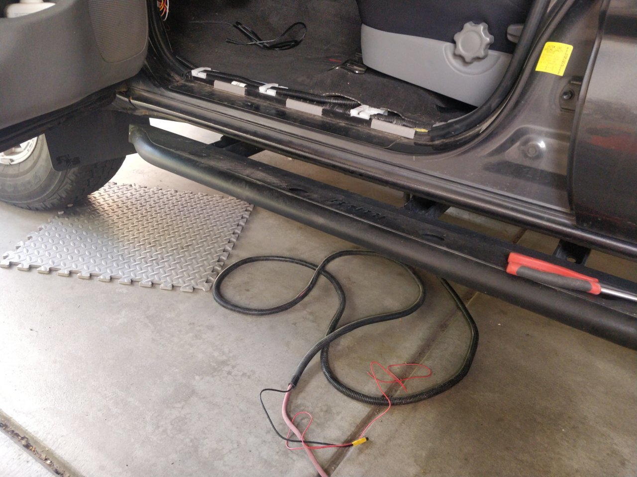

    I was running a power line back to the hab so ran the camera cable at the same time.
    The hole for the center brake light is actually big enough to fit the camera wire through as well so I didn't have to drill any extra holes in the hab. I just cut a little notch out of the brake light.
    Having rear visibility again is great and the wide angle camera almost completely eliminates my blind spots. The refresh rate is a little slow so passing cars can jitter but overall I think it's a great addition.
    I will add depending on how you route the cable you will need to buy an extension cable for the camera wire. I was about a couple feet short without it when routing under the truck following the main rear wiring harness.

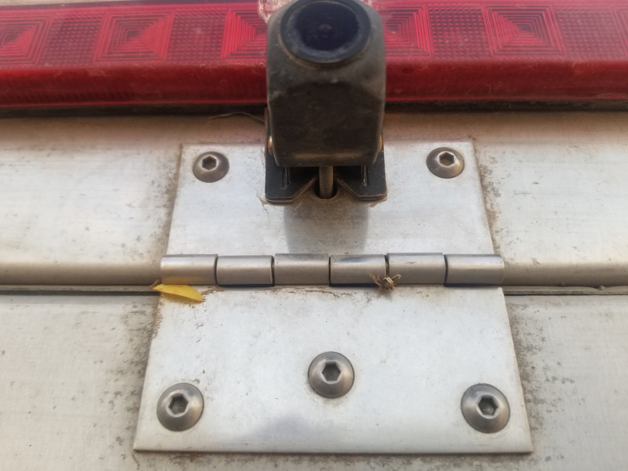

    We have been using the exped megamat duo on top of original mattress for the last year or so. Wont sleep in there without it now. It has the added benefit when temps drop down real low of extra insulation under you when sleeping. We pack it away when tent is closed, its worth the effort. It goes really quickly once you have done it a couple times.
    I have meant to post about this exact thing. It is a must unless you have a pass through window / rear hatch window. Here is how I mounted our camera, used the middle bolt hole of middle hinge, also a pic showing clearance of rear hatch, has been like this the past year and is one of the things I wish I would have done day 1 of ownership.

    Dont open your tent with the camera mounted here or you're going to crush it.

    Good call as that's something I didn't consider originally. However luck was on my side and the camera just clears when open. Not a mm to spare though.

    I had originally planned to mount it where you did but thought it would for sure get crushed there. It ended up working well for me anyhow. Its definitely nice to have either way.

    Yeah the camera's a must. A lot easier changing lanes on the highway. I should have gotten the camera from day one also.
    The first time I drove away after having the hab open the camera was pointed lower and for one sec I wondered why. Then it clicked that the top pushed it down a bit. Very lucky I mounted just low enough. I would recommend your mounting location for others.

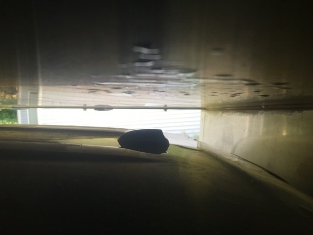

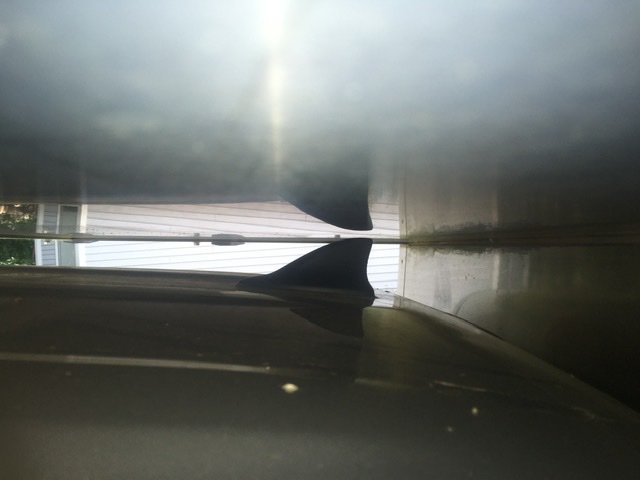

    Swapped out the shark fin antenna to a pre-12 bump type.

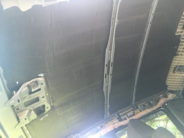

    Covered the roof in butyl and closed cell foam to match the doors, walls, and floor. The headliner/roof took me less time and effort that the rest.

    What's the part number for that antenna?
    86960-04040
