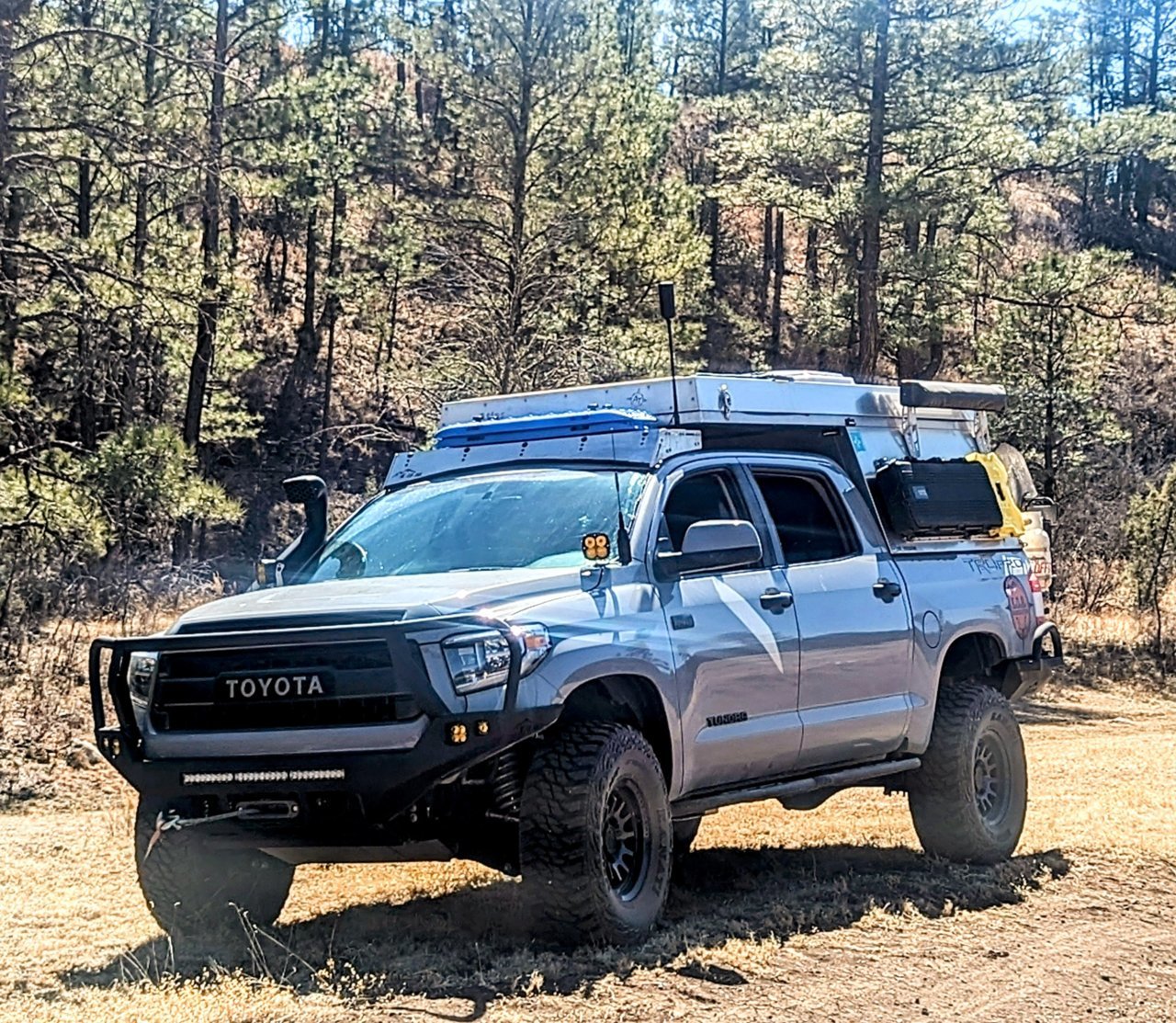

    Details on those awning mounts?

    They are the mounts that AT sells.

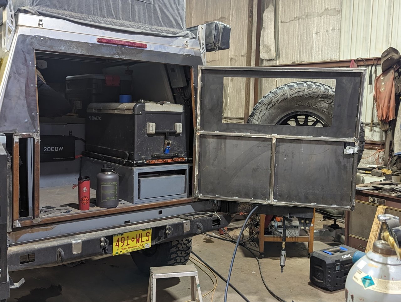

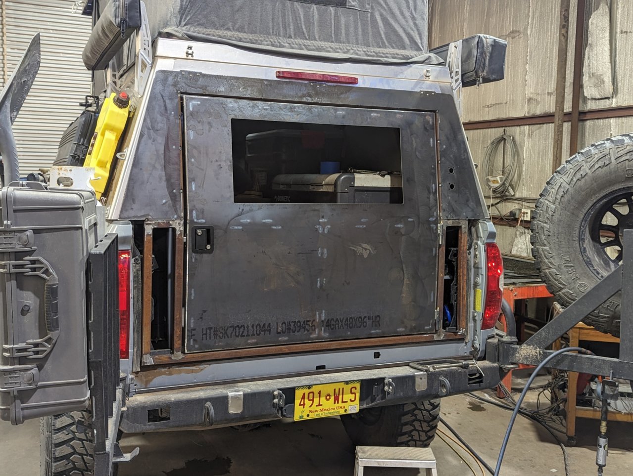

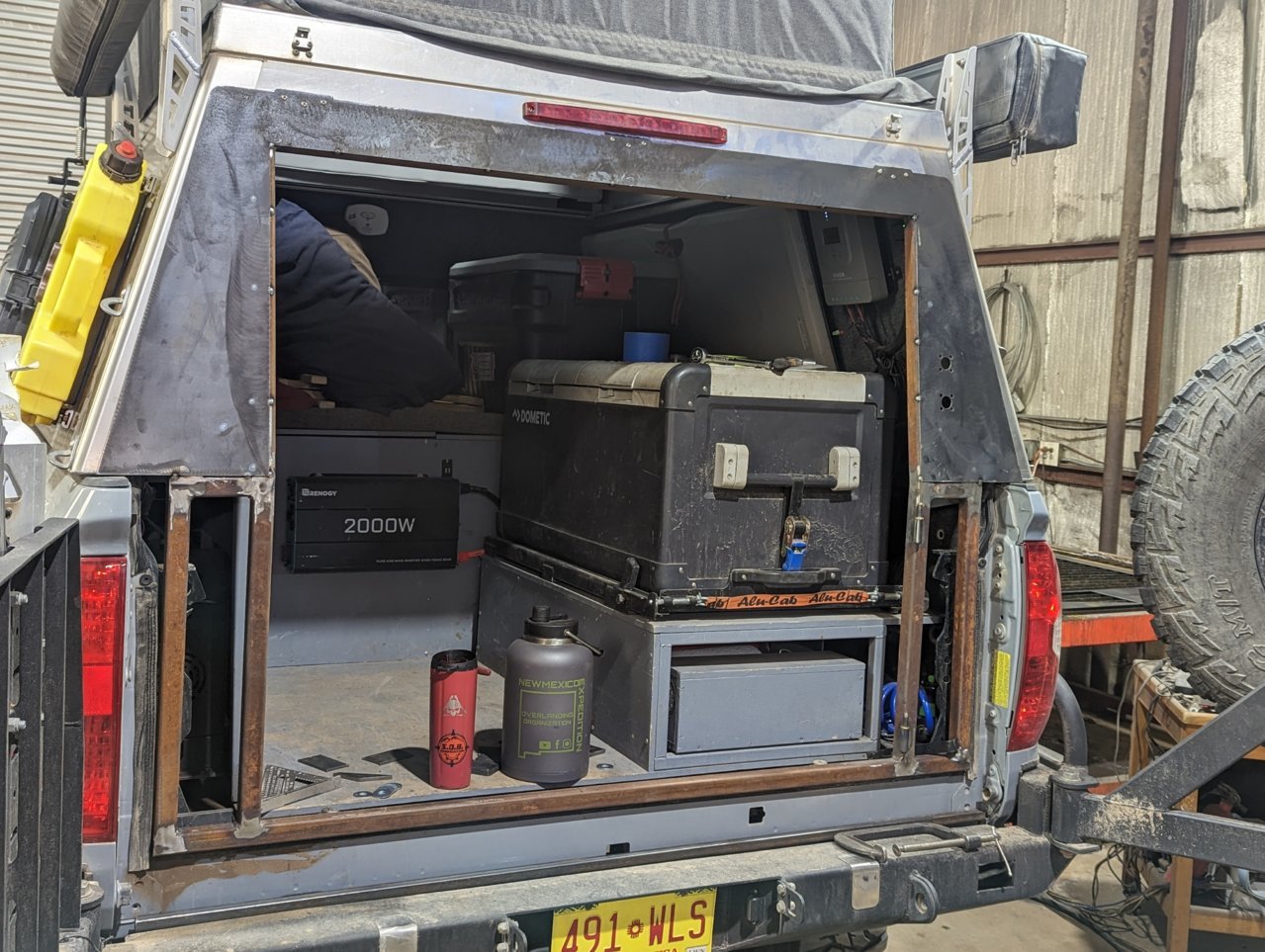

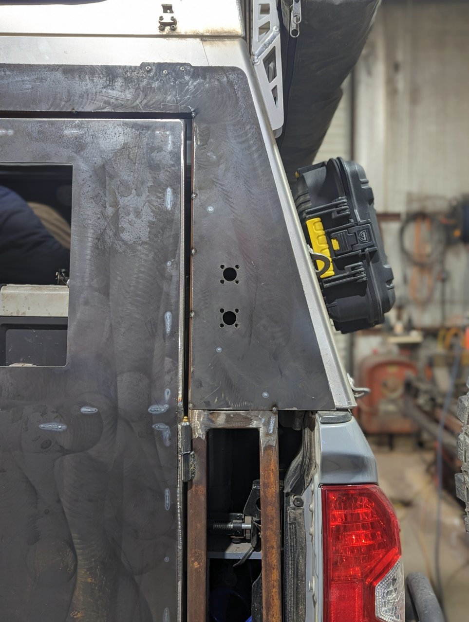

    Not a Tacoma, but a Tundra. I pulled my tailgate and rear camper door to make a custom door. Should have it wrapped up tomorrow and painted. I'm going to run it for a while and make any changes that need to be made and have it powdercoated.

    How far out from the edge of the camper does the awning mount place that inside edge? Wondering if there will be enough clearance for the gas
    shock on a habitat while opening.

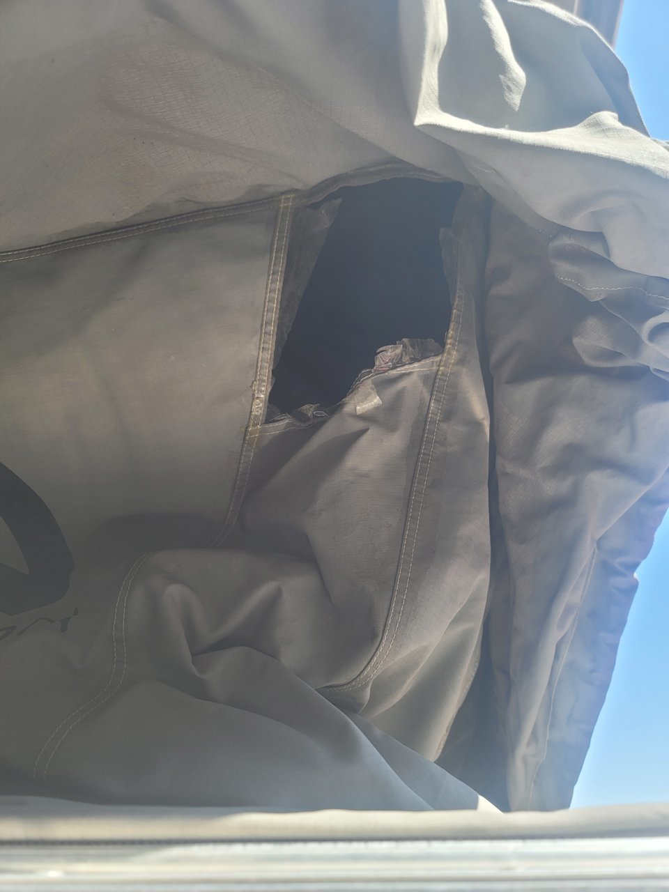

    Have any of you fellow habitat owners had a cold weather issue with the little side light windows cracking?
    When I was unfolding my tent earlier this year in freezing temps both the windows shattered. I would he very surprised if this was an isolated event.
    I reached out to AT to ask how I should go about repairing it, their response was kind of weird, told me that it wasnt a cold weather issue, really didnt even know how to respond to that I literally watched both of them brake at the same time while unfolding the tent.....in any case if any of you have any ideas to fix it / patch it im all ears.20230601_100355.jpg

    I’m kinda surprised they didnt have a response.. thats kinda crap.
    I’d probably start with a canvas patch and see how well it holds. Something like this
    KING MOUNTAIN Canvas Iron on Patch,3"×60",Waterproof 100% Cotton Fabric Repair Patch,Used for Various Sofa,Tent,Clothes,Seats,Suitcases (Black,Waterproof) https://www.amazon.com/dp/B0BNPJ3YSW
    Eventually id probably sew a patch over the hole.. which sounds like a huge pain.

    But I did have a Samurai with clear vinyl and it would break when freezing. A boat canvas shop had more durable material for cheap. I'm sure a marine canvas shop would give you the vinyl for free, just pay the seamstress fee for stitching it in. Treat it with UV tech occasionally to keep it soft

    I honestly dont like the vinyl material in tents. I have owned a couple older (90s) pop up campers and the vinyl windows did not fair well in cold weather. Also the same problems guys with the modern softopper shells are having, and it only gets worse with time. I was hopeful nemo would take the cold weather into consideration and have some sort of different material but thats due to my own ignorance. The tents are as legit as can be other than these little windows. When I replace I will be replacing sans vinyl.
    I guess I was hoping for an easy solution but looking like I will have to pull the whole tent off to have it sewed.

    Ok that sucks. I'd take off the tent fabric and get it taken to tailor who specializes in quilts and large sewn stuff.
    Topaz Quilting and Embroidery in Reno maybe? I'd start there.
    The main thing is I'd check in with Mario to see what spec thread they use. I'm not sure if you'll be able to get the same tent fabric if you want to change to something opaque, but you can use marine vinyl, usually you can find something with UV Resistance and Non-Yellowing specification. I'd also recommend taking the opportunity to sew on some velcro panels inside and out. Maybe you can cover them with some foam insulation during the winter to reduce the stress from low temp.
    Yes, low temp can destroy vinyl fabrics, so heating it even ever so slightly can help out, even like using a diesel heater whenever you have the tent popped open in the winter. If you're really anal, you could get some 12v heaters and velcro them in place and turn them on a few minutes before you open and close the tent.

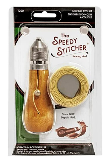

    Wife and I had a good experience sewing with the Speedy-Stitcher when we ripped our tent open. It just needs two people, one inside the tent, and one outside. The stitch is like a sewing machine's, so it holds really well. I think it's waxed thread, but we just put seam seal stuff over it, too.
    https://www.amazon.com/dp/B000HGIJQ4

    I like this idea much more than removing the tent

    Google “sail window”
