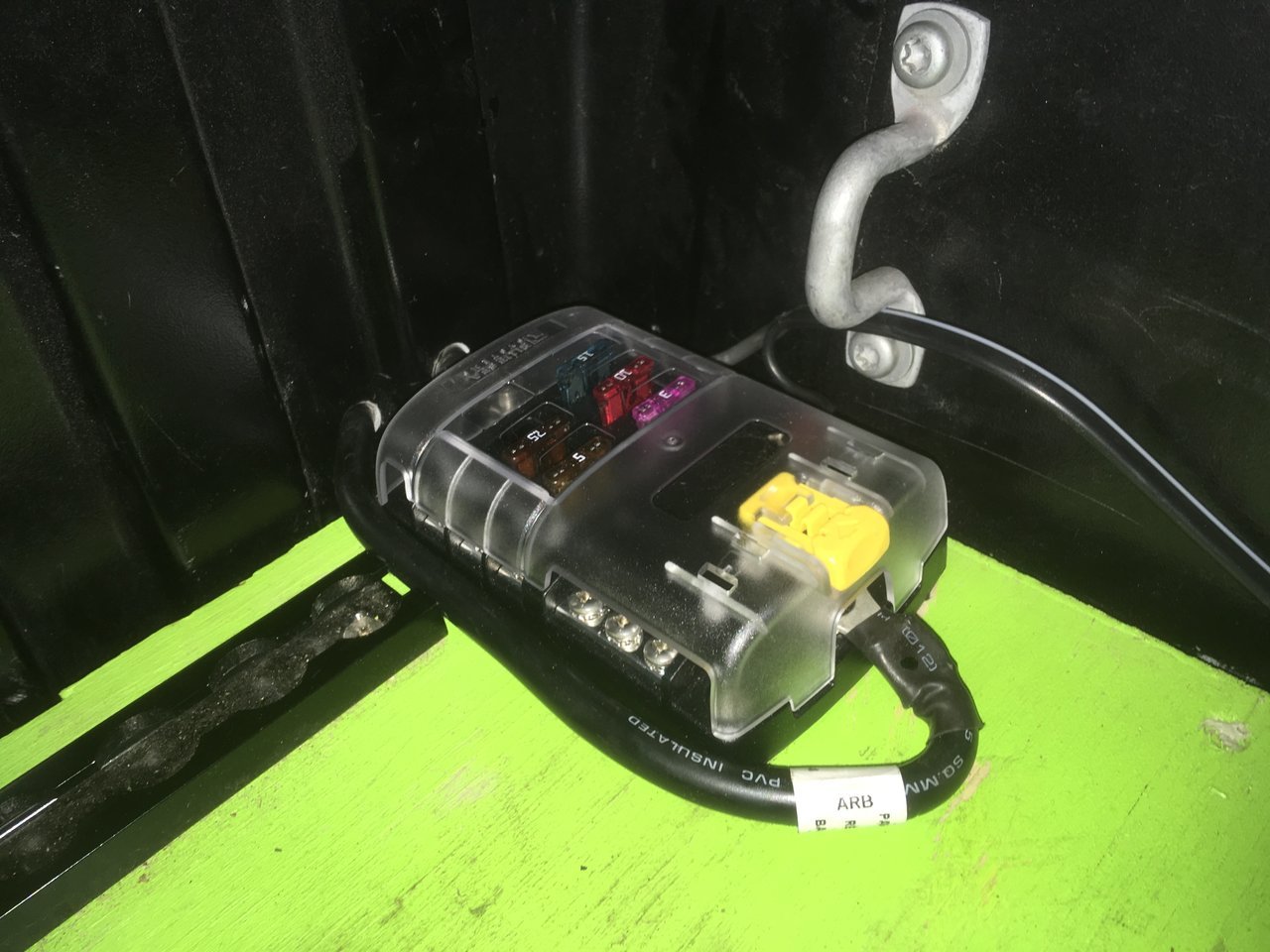

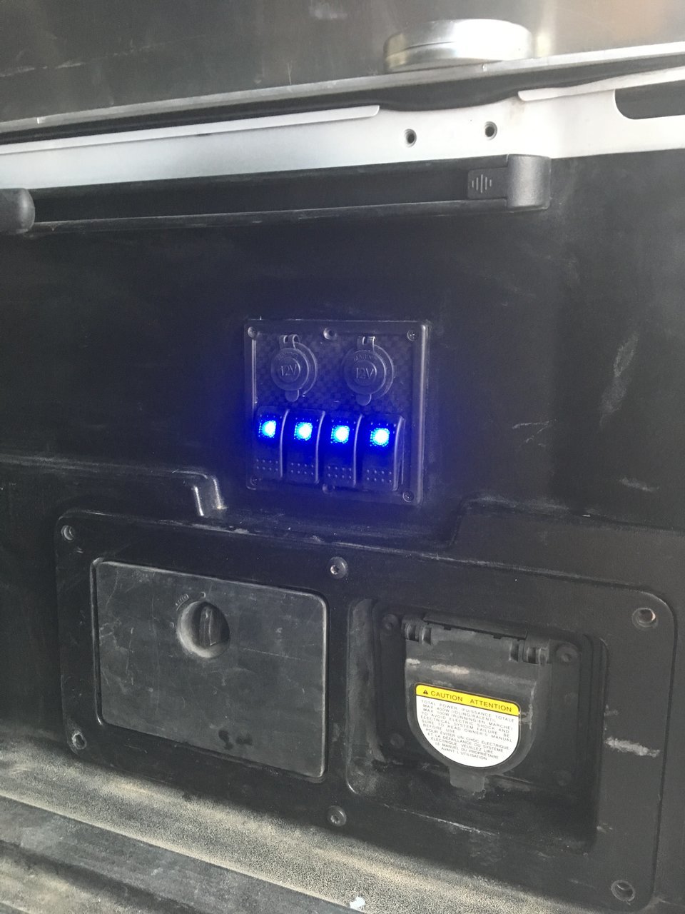

    I just wired up a switch panel with 2 12v outlets in the bed. Ran 8awg from my second battery along the frame to a fuse box in the compartment beside the 120v outlet. 40amp in line breaker by the battery. Now I can run my fridge and lights off a 12v system and it looks pretty damn OEM.

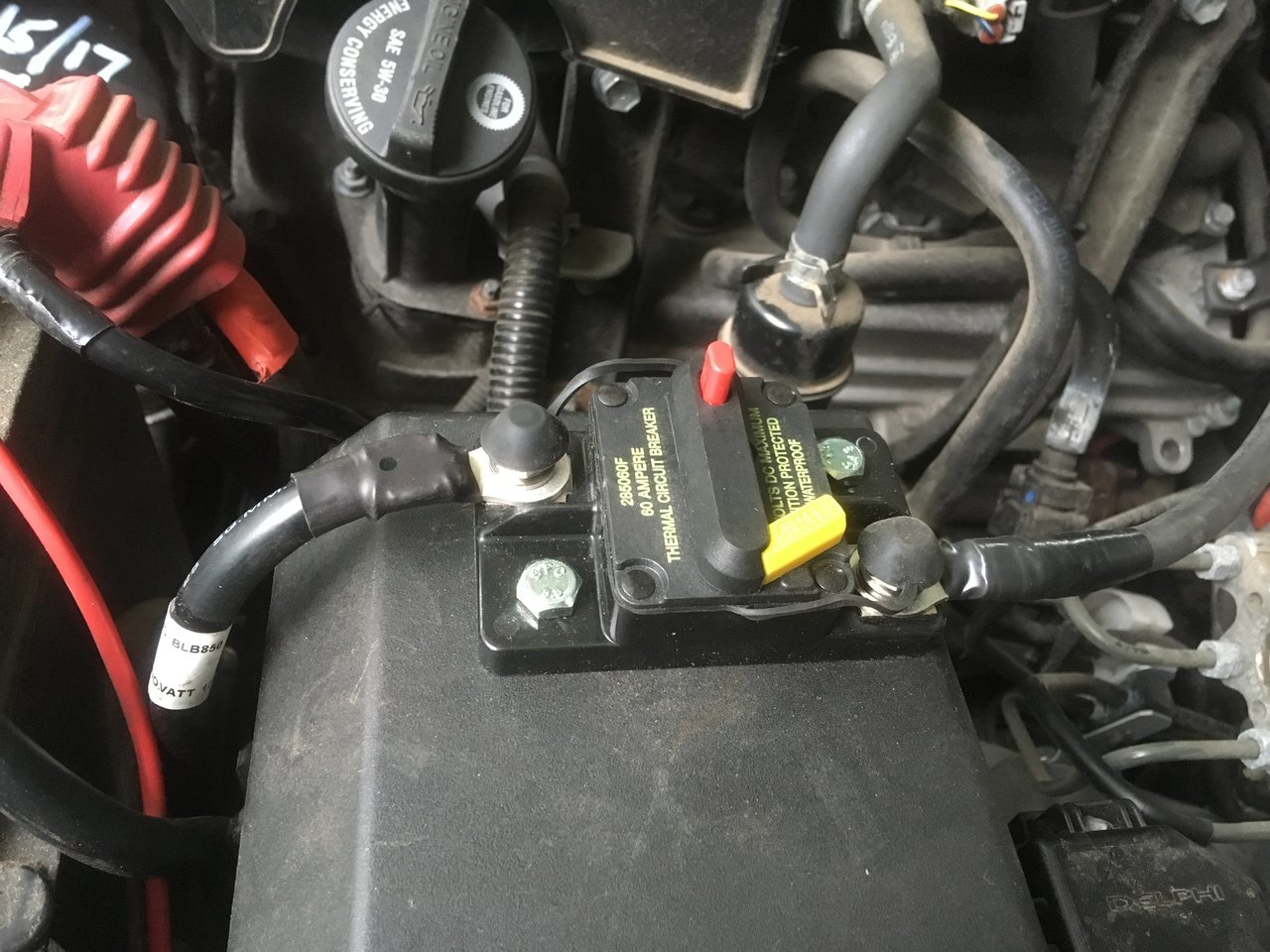

    I am running a 40a blue sea breaker on the fuse box, 2ga welding wire down the frame to the passenger side of the bed and into a 6 circuit blue sea sub panel, with ground bus, attached to the frame via more 2ga. Right now the fridge is wired. Soon it will be led lighting strips, some 12v USB adapters, and god knows what else.
    BTW. The round holes in the corners fit the westmarine plugs perfectly.
