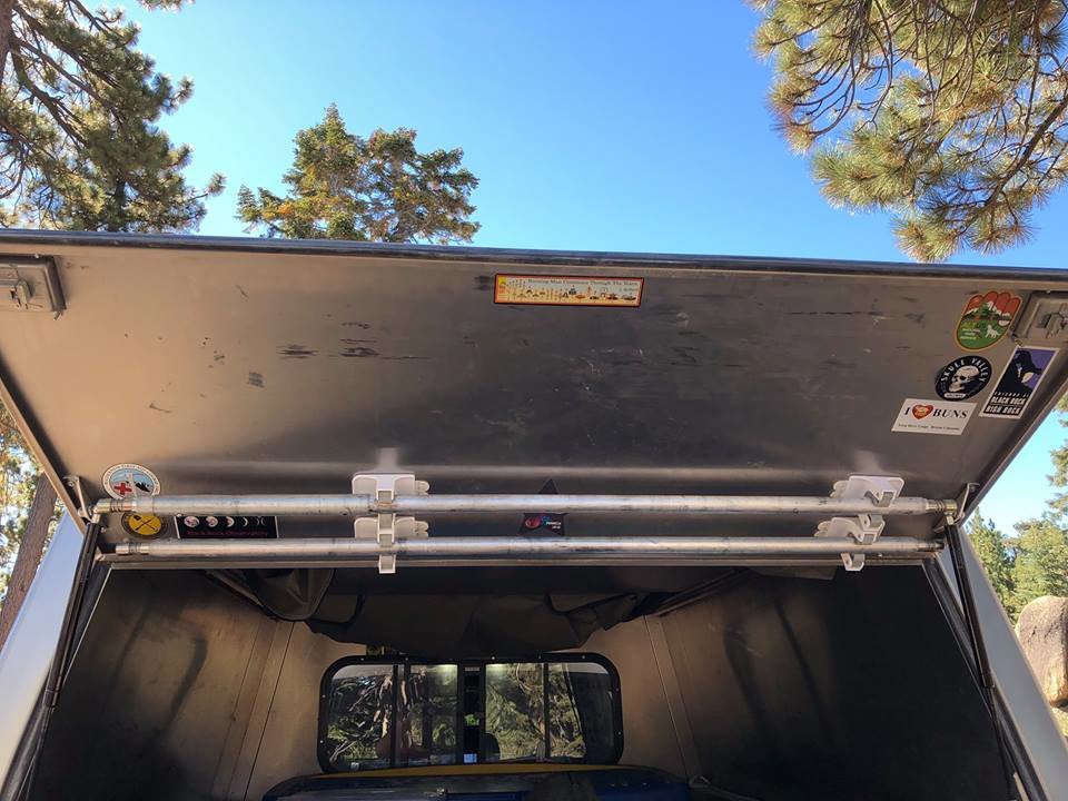

    @excorcist how did you attach those kayak paddle clips? Just drill and tap into the side rail? I'm copying you.

    Yep, just used some really small sheet metal type screws and a tiny drill bit... although I did just see someone on the facebook group for habitats used some of these :
    https://www.amazon.com/Command-Broo...d=1537330688&sr=8-4&keywords=command+broom+3m
    And they attached them to the inside of hatch. Looked really convenient and out of the way at the same time... as well as less intrusive.

    Found the picture:

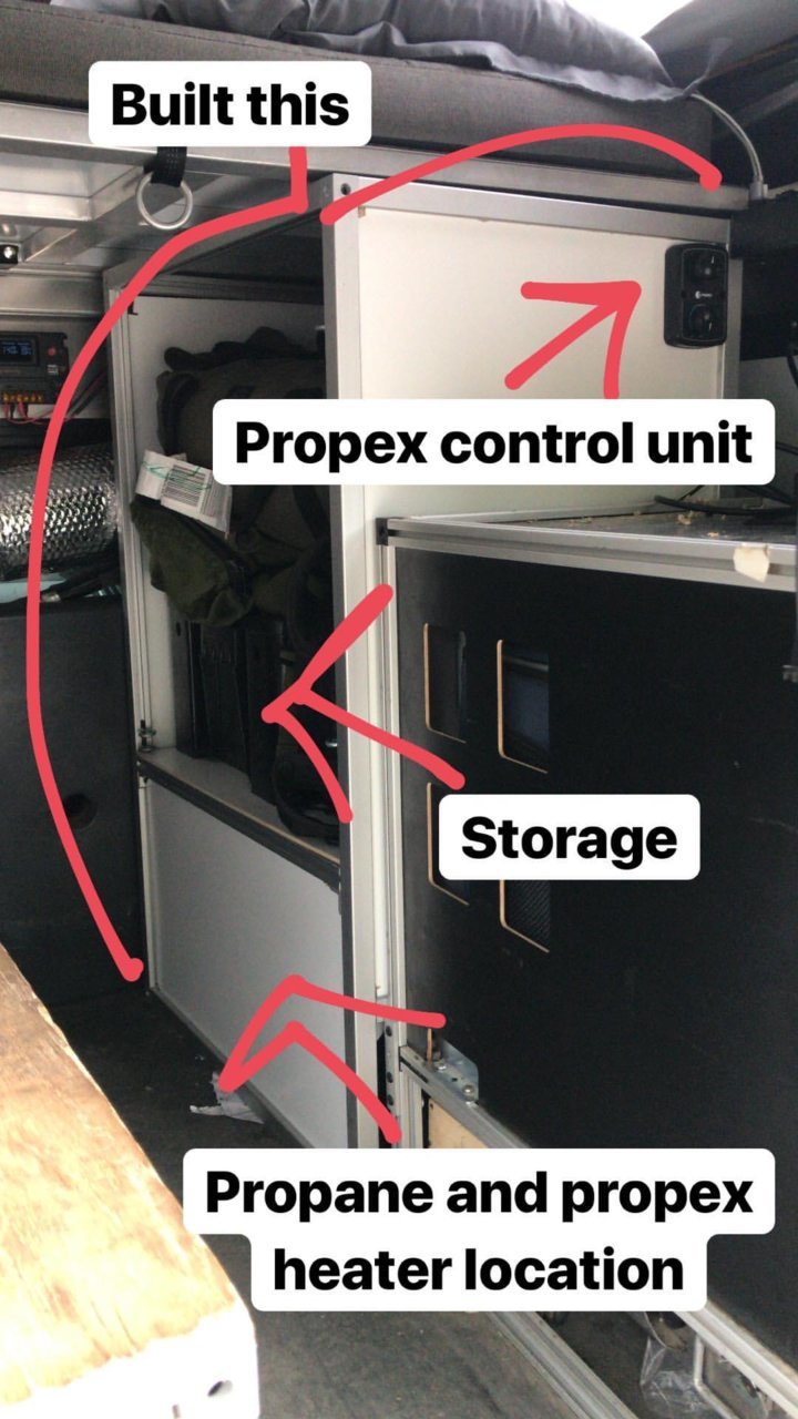

    Any new ideas on heating the Habitat? It's getting colder in Northern California (41F in the early morning and 84F in the day) but we like to camp throughout the year. Only issue is that both my wife and 17 year old corgi, like it warm inside and blankets/bags aren't enough. There has been a few discussion on this thread, mostly about mattress pads and Webasto heater. I'm looking for a safe option and Mr. Heater is not a consideration - checked with Zodi yesterday and they confirmed that their 20,000 BTU heater is discontinued despite their website that says "Coming Soon". Looks like my best option is the HeatSource portable kit from Adventure trailers (I don't want a permanent mount), but at $1500 it isn't cheap. There is a good thread on Expedition Portal - https://www.expeditionportal.com/fo...test-results-five-ways-to-heat-a-tent.188602/ - and it seemed that the best solution was something similar to Heatsource - Propex Portable heat kit.
    Any suggestions...?

    Heatsource and Propex are the same thing.
    I have a Propex I installed in a Vagabond Drifter and I’m a huge fan - it does require drilling 2x 1.5 inch holes in your bed though.
    It’s very efficient, and the heat it puts out is nice and dry with no crazy odor.

    I'm hesitant to drill into the bed, not sure why but just seems so permanent - Where did you locate the heater? Did you consider a portable kit?

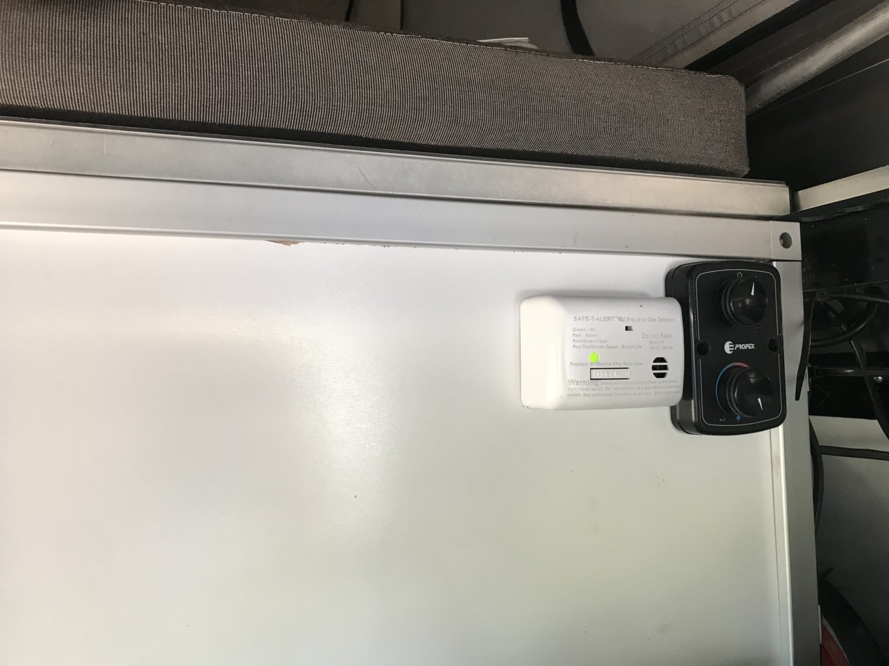

    I located it behind my fridge slide on the right side of the bed inside a shelf I made.
    I opted for a "permanent" install as I am living full time out of my rig and I don't think there's really a good way to pipe the hot air in/out without resulting in a lot of heat loss. I have no regrets and have used it several times already.
    I have also since added an LPG alarm just in case.
