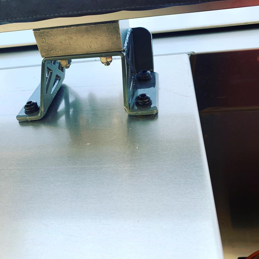

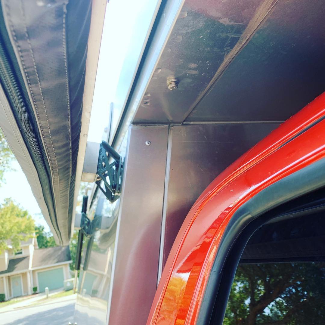

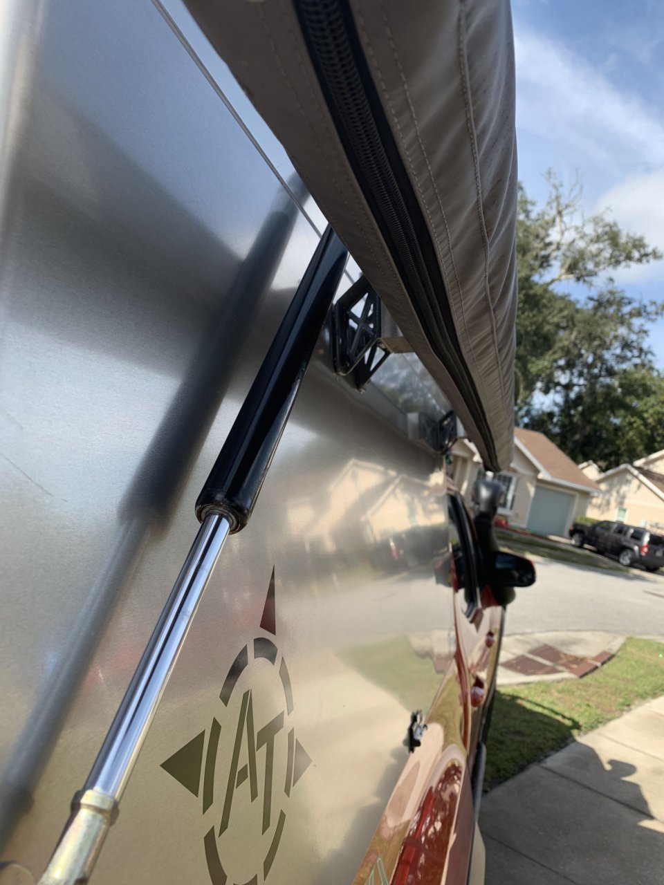

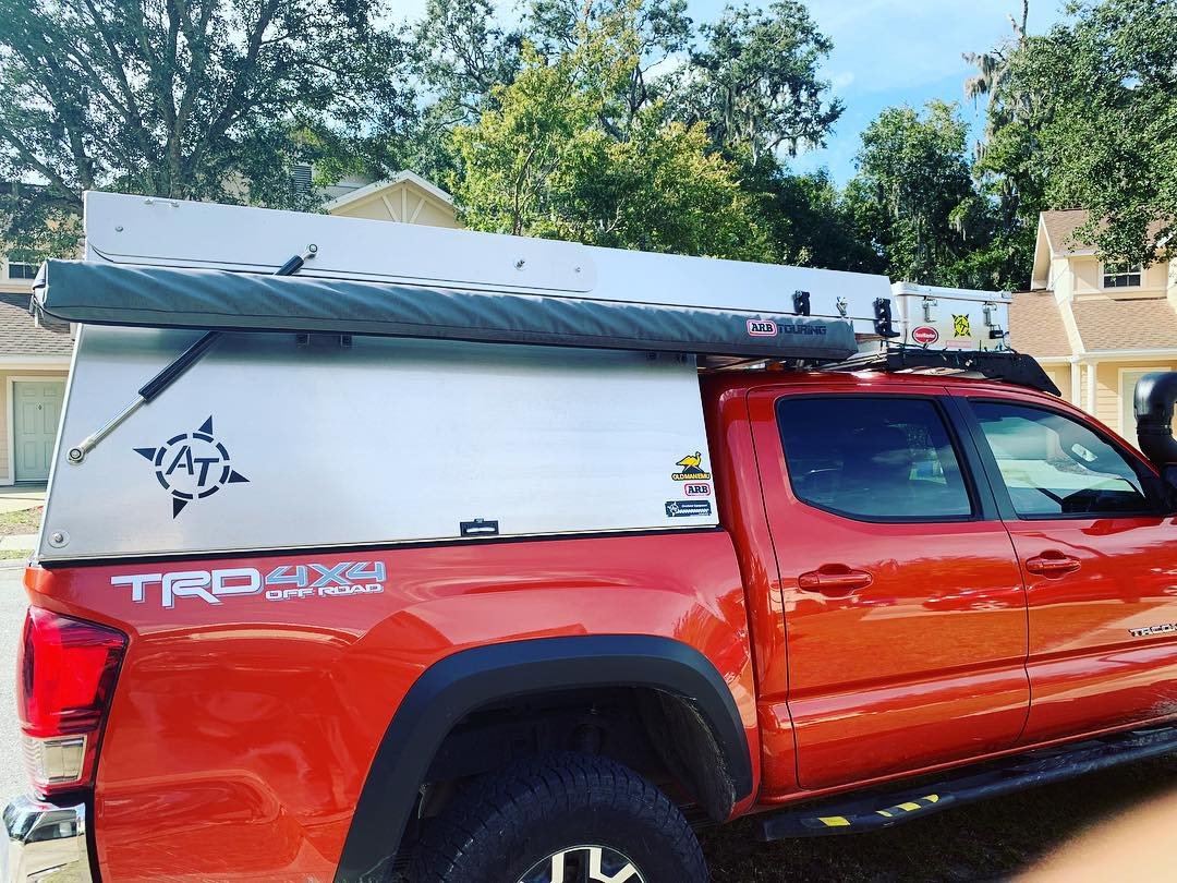

    510826DC-4823-4C5C-88E7-CF2B9D6A4013.jpg FC2C9386-37B2-4490-9626-044BB93FE5DD.jpg 510826DC-4823-4C5C-88E7-CF2B9D6A4013.jpg FC2C9386-37B2-4490-9626-044BB93FE5DD.jpg AA7B49C2-90D7-4CEB-9A99-F7B30C0F2051.jpg DE3D0330-03B5-4C90-BCAF-56A4BBBC9F62.jpg
    What’s up guys, here’s how I mounted my awning to the habitat. The bracket is made by gofastcampers. When I first mounted it I realized it still wouldn’t clear the strut so a friend of mine made a 1” spacers to add more distance from the strut. I used rivnuts to mount the brackets, I’ve taken it through a few trails and so far so good. The only thing to worry about is you have to remember the awning is there through tighter trails.

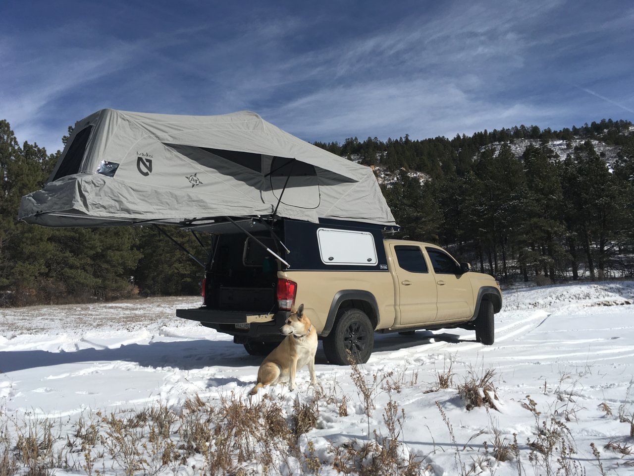

    Got out for a run in the snow today and decided to flip the habitat and take a nap after. 0C6F93BE-6AD0-40B9-ABB7-C8E3F0F4EC12.jpg
