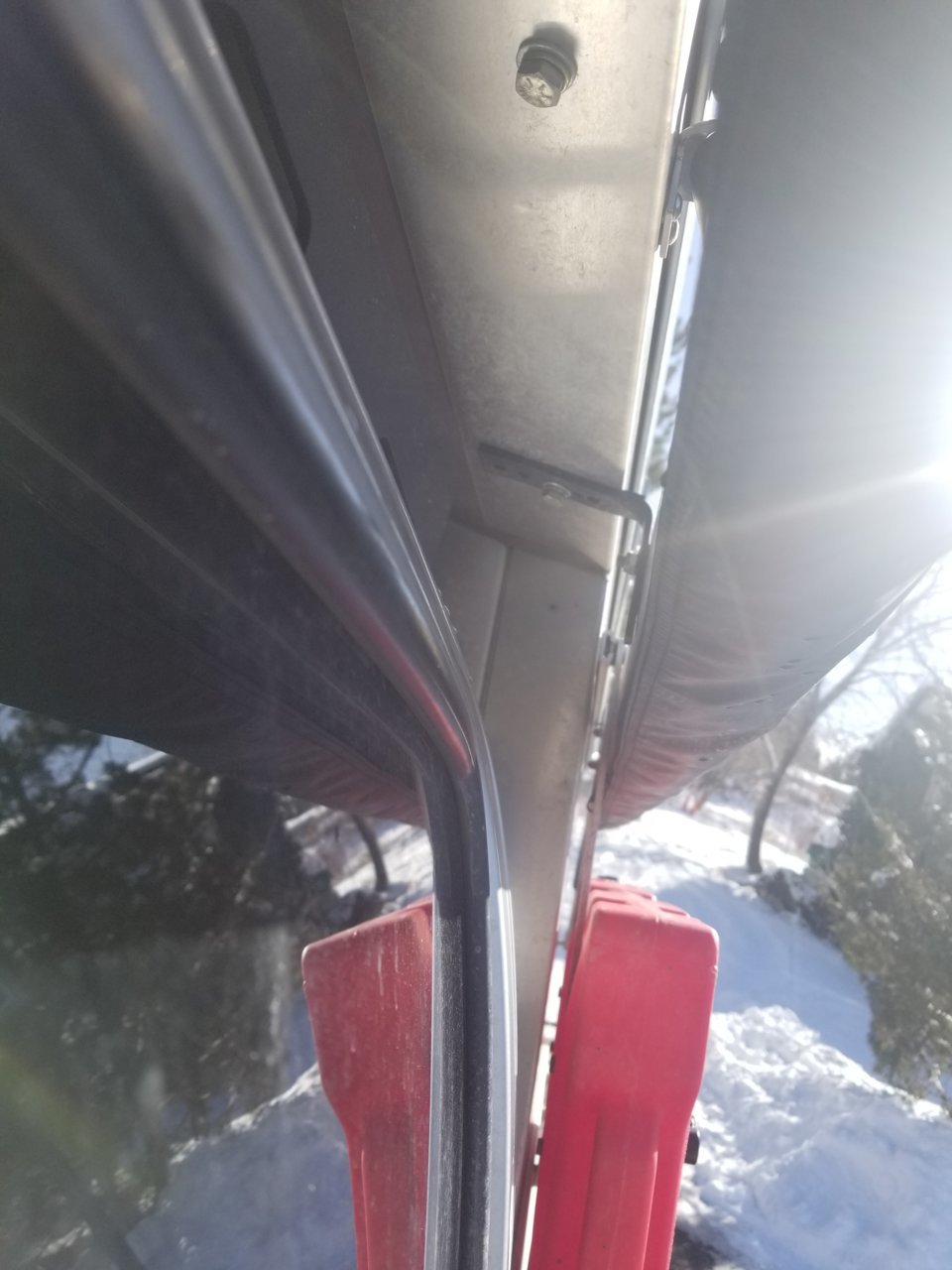

    Nope just used what was there. I did make the bracket longer than necessary so it had more surface area on habitat to avoid too much leverage on it.
    It has been rock solid. Between the two bolts under there and the attachment on the l track its not going anywhere.20190211_132229.jpg 20190211_132229.jpg

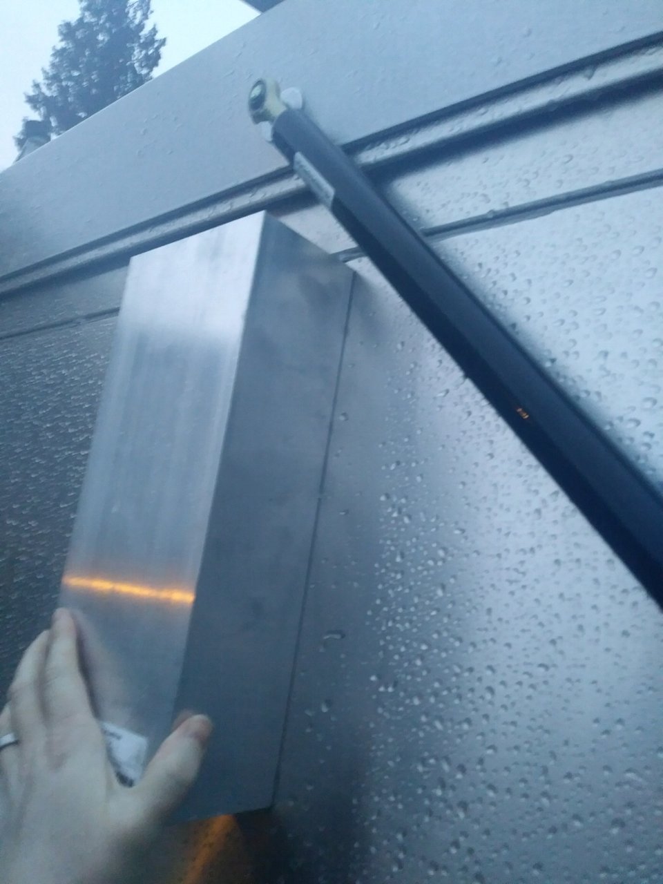

    Dude! Much appreciated. Thanks for the photos :) I figure I'll do that , but I'll prolly use all three for a lil extra spread of the weight, specially since mine will be extending outward about 3 inches further than yours.
    Going to cut an offset bracket outta the below piece of aluminum. 3x5 inch rectangle tube. Will rivnut it to the Habitat as pictured, and one near the front as well, then the three bolts under the overhang. At least that's the plan!!

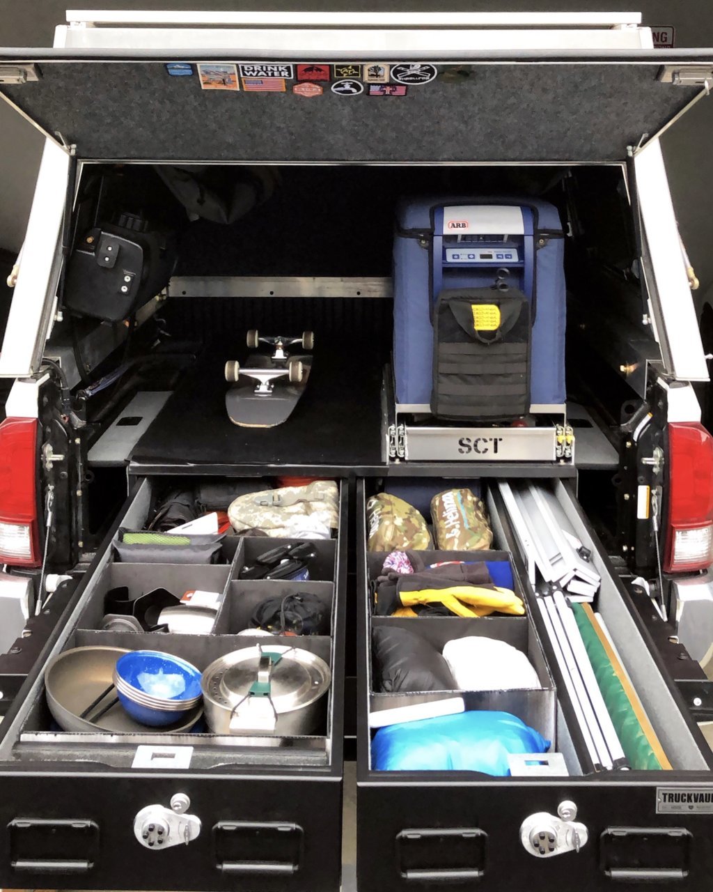

    We now have our new floor in! 3 removable Plywood panels across six milk crates. We will be carpeting them and drilling some finger/hand holes for lifting them off for access while in the Habitat. Who needs an expensive drawer system?
