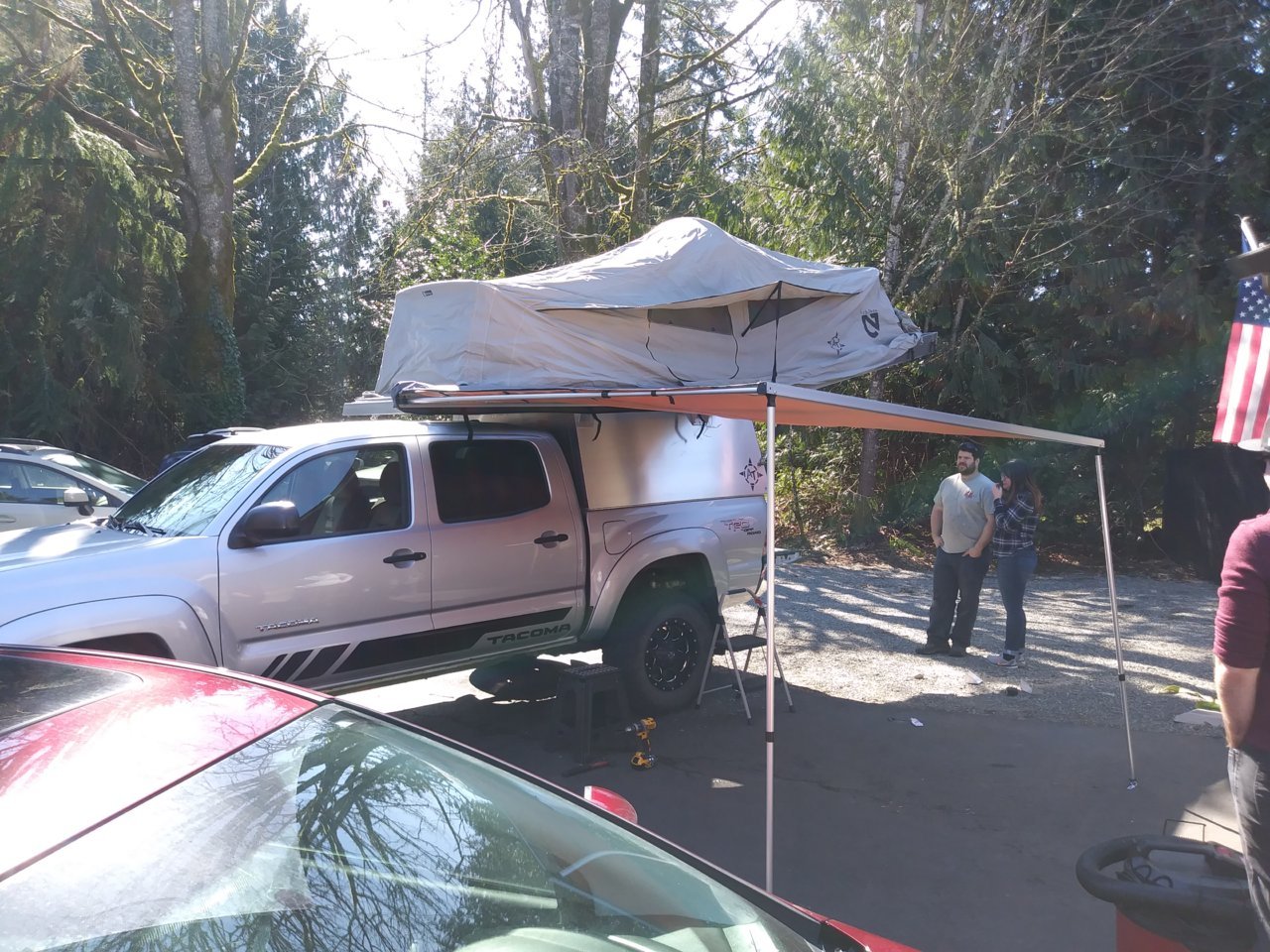

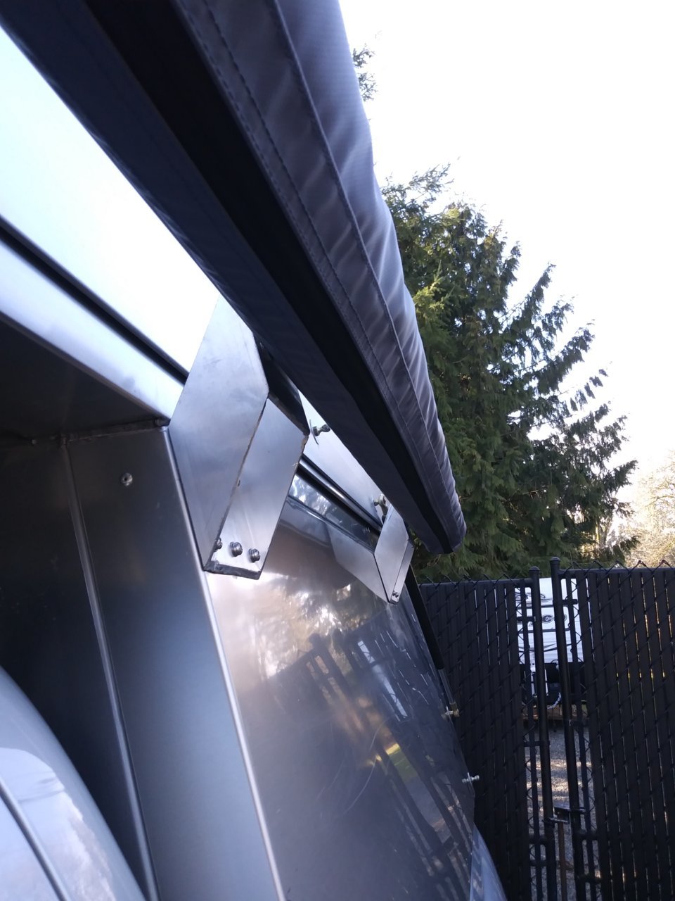

    Got the ARB 2500 awning on today! (8 foot)
    Made mounts out of 3x5 aluminum tube cut at 45 degree angle, or thereabouts. 6 rivnuts into the Habitat in each one.
    Front mount is simple flat steel bent into an L. Uses one of the existing bolts and added one rivnut.

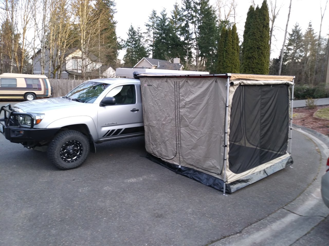

    And here is with the awning room. This thing is awesome.
