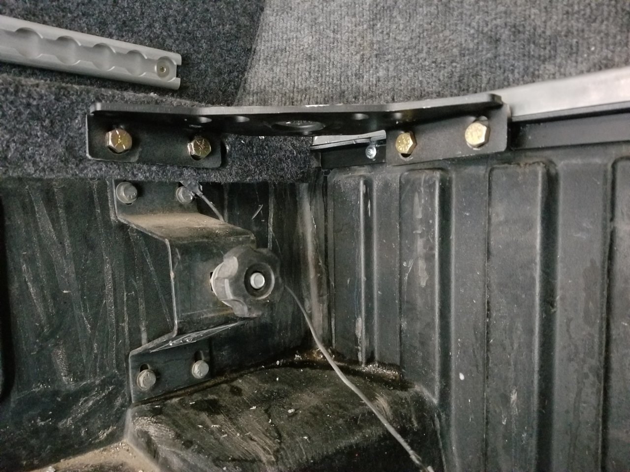

    So your gusset is mounted to the bed rail through the habitat mount? Looks good!

    Yes, it is mounted through the habitat into the bed rail on the side, the front I had to get a piece of angle iron and bolt it to the front rail, then welded on some nuts for the corner gussets. No more worries about habitat walls splaying.

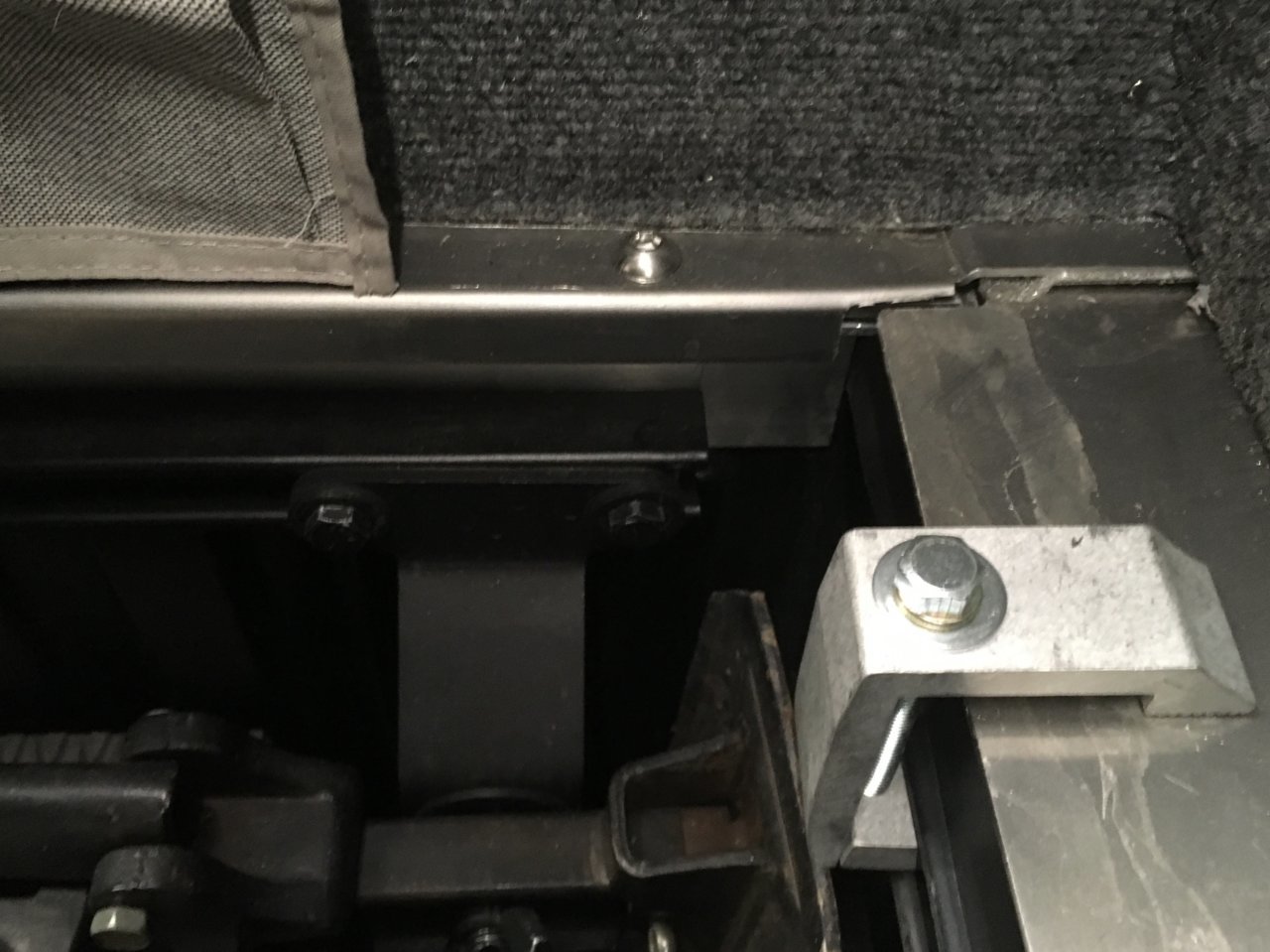

    When AT installed my habitat they asked me if I wanted the big aluminum angle brackets or if I wanted to keep access to the stock railing. Since I mount so much to the railing I wanted to keep that accessible. Overall I think the clamps are a cleaner solution and still having access to the c channel is awesome for securing contents. Four clamps on each side and then front of the habitat was bolted thru in each corner into the aluminum angle that replaced the stock front of our Tacoma beds. I have had zero movement side to side or front to back with it attached to the truck this way.

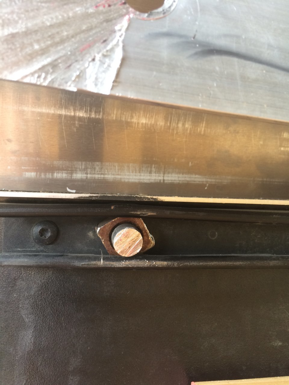

    ..i have not been missing the bedrails, but making some changes, and just ordered a set of clamps.
    i got a small obstruction to get past yet. before sawing the button head off, the nut would rotate in the track, not tightening nor loosening. this has to be removed before any other clamp-nut or T-nut can be placed.

    Drill it out if you can’t slide it out. That’s the only not thing I can think of. I have to remove the rail mount bolts and the end cap to get the nuts past anyway.
    I installed my habitat and had to remove the rails a few times to mount things including molle bed side panels. It’s tedious.
