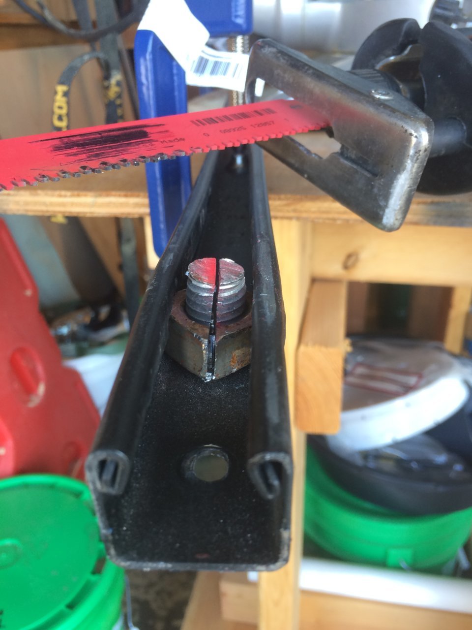

    Neiko 10071A Torx Bit Socket Set, T8 - T60, S2 Steel | 13-Piece Set https://www.amazon.com/dp/B000J0TF6G/ref=cm_sw_r_cp_api_i_lryMCbHTGZKZX
    I’ve had this cheap little set forever. It’s worked on everything i’ve needed. If they’re tight, a few taps with a breaker bar and hammer could help.

    Another option to remove that nut, angle grinder with a cutoff wheel and a very steady hand. (Not the best way, but it would work. Cut it horizontally in half) be sure to hold it with something.

    good idea here..more my style...i was thinking I "could" use the saws-all to possibly cut a section of the lower lip off that 'C'-channel. originally thought I had a messed up 'C'- channel and that by removing the channel and getting a new channel i could solve problem...the 'C' channel is messed up, just not as bad as i thought, and it is a lot stouter than I thought. yesterday when i pulled the double layer angle-aluminum off, I inadvertently pulled the the driver side Habitat one-half inch rearward. AT used some serious industrial double-stick adhesive to hold those pieces together. moved it back into position with a ratchet strap, a long 2x4 across the hatch mouth, and a new mount on my forward bed platform. thanks for tool suggestions and ideas.

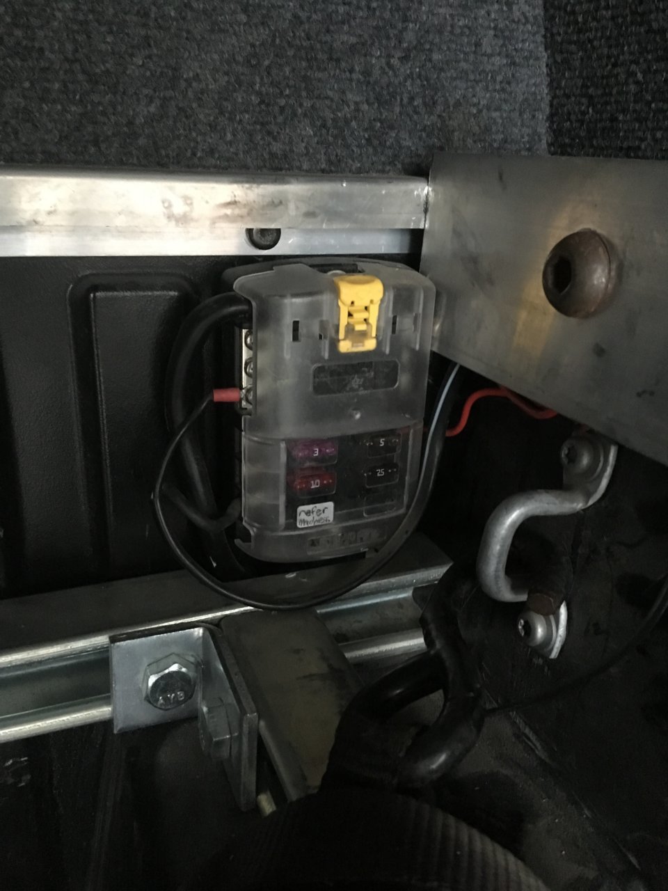

    Adventure Trailers Tacoma Habitat Pelfreybilt Rock Sliders Line-X Pelfreybilt Pro mid, Gas, Exhaust Reroute Skids Hondo Unholey Dash mount Total Chaos Bed Stiffeners Redline Tuning Hood Lift Struts Weathertech Floor Liners
    If I could do it all over again, I'd mount a blue seas fuse panel to the wall of the habitat. I ran everything to the hood.

    Icon Coil Overs. Deaver U402 Stage 3 Leafs w/ Bilstein 5160s. ARB Deluxe Bull Bar. Fuel Boost wheels w/ Wrangler Duratracs. Brute Force Fab Sliders & HC Rear Bumper w/swingout

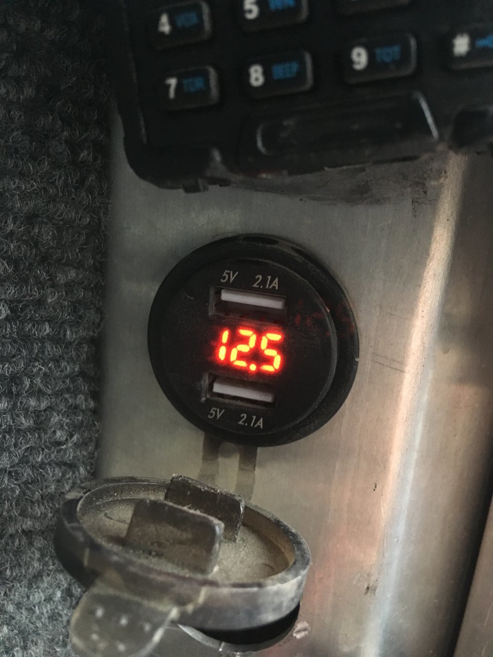

    I have a Blue Sea fuse panel in a box in the bed (along with my additional batteries, charger, etc.). I installed 4 Blue Sea outlet (2x cigarette and 2x USB) in the vertical rails.
    Luckily for me, I have small fingers. I dropped the screw on retention rings down through the very top hole in the corner. Had to run the wires up from the bottom, putting them through said retention ring, then out through the hole where the wires could be attached to the back of each outlet. Then I had to use a finger through another hole to tighten the ring on the back of each outlet.

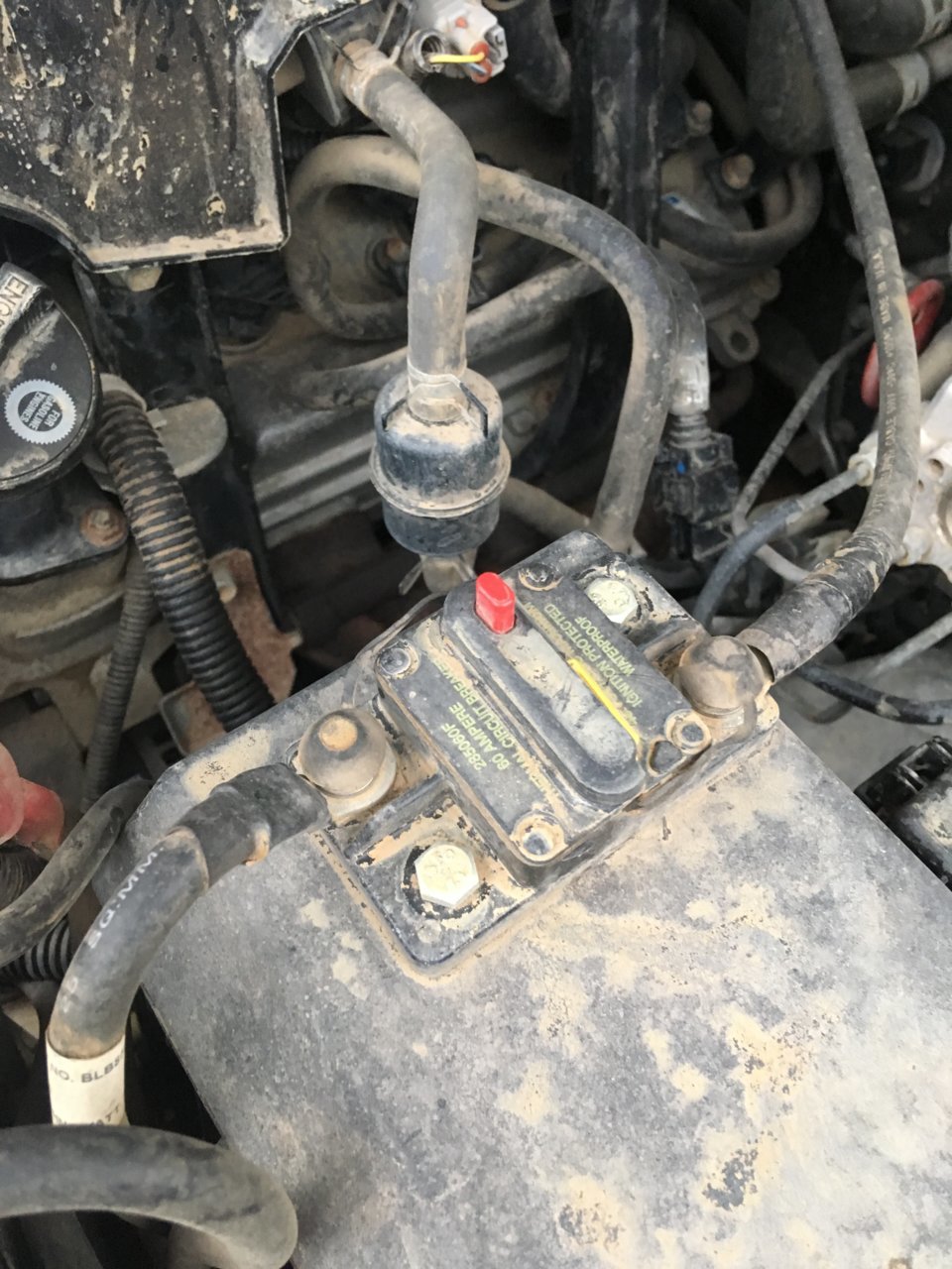

    60a circuit breaker on the fuse block, 4ga welding ground wire to blue sea fuse block with bus-bar in bed.
    Right now runs fridge and USB Charger with volt meter. Soon to run compressor as well.
