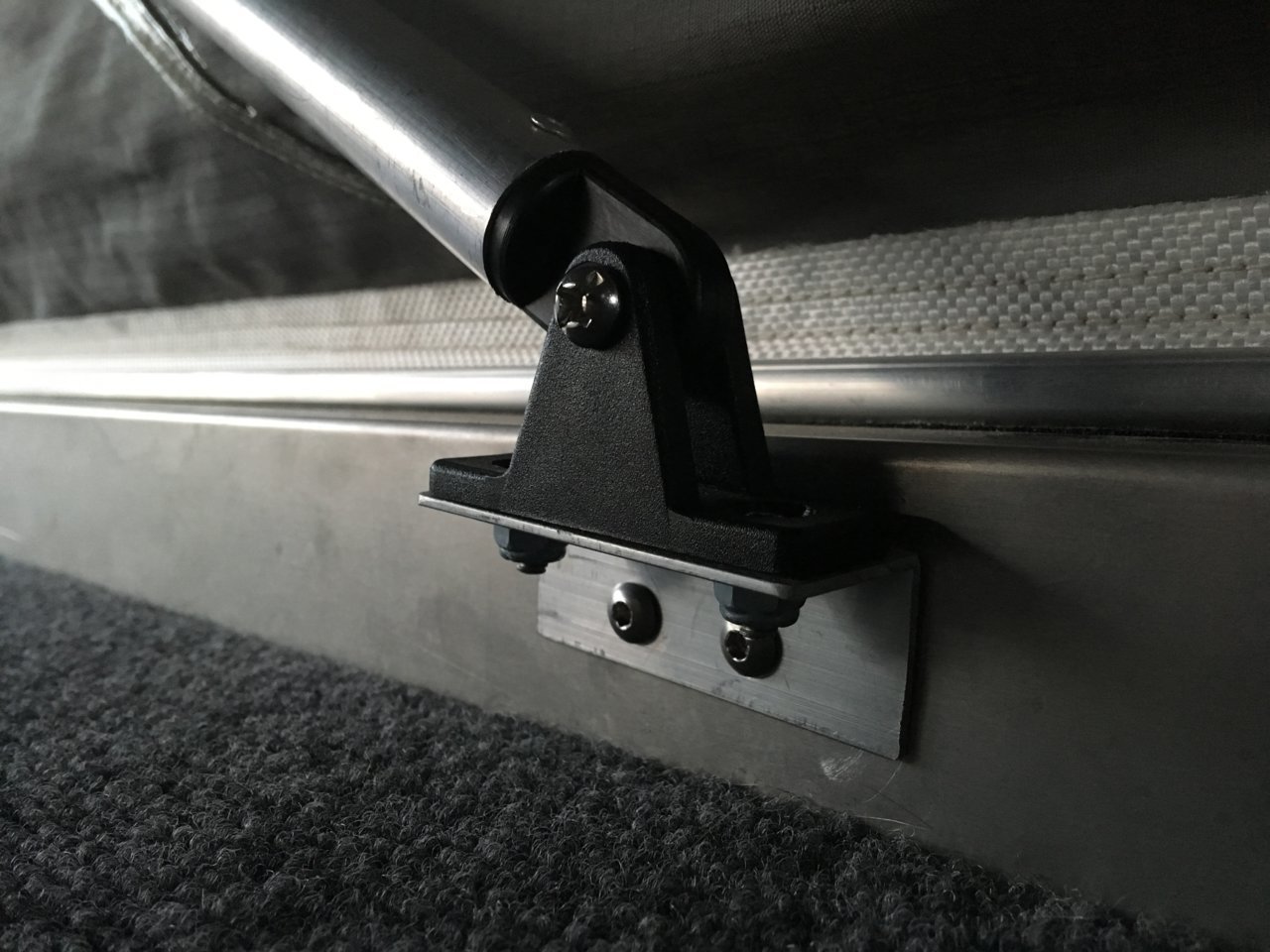

    Looking at ideas to include a nice sqooshy mattress for the truck half of the tent. One option is the exped double. It’s 52” wide and the gap between the channels is 48.5”, or 1.25” of each side crunches to fit. Looks like the first 2” of the mattress will have crunch.
    The only issue is the forward bows. Looking at it, I feel if I flipped the brackets it’ll be a little less sharp objects to much about with.
    I wonder if @Mr D would object or weigh in on the idea? It almost looks like my tent now would favor a shift in hinge location, as it appears the hinge is not aligned right.

    curious..IIRC, my hinges have that similiar non-square placement...thought it was a random placement. as to sharp edges potentially detrimental to a squishy air mattress, i'd think you could wrap that hinge to reduce its sharpy nature. I used to used 4 inch thick closed cell foam, cut to fit, in kayak cockpits for fit. cut, glue, shape with a rasp. you could soften up those edges.

    The air awesomeness is 4” thick, and already too wide. I was worried about it filling that gap under the aluminum angle then crunching up more around the post, I’m (my wife) is concerned about it mucking with a $300 mattress. I considered a closed cell foam mattress but the storage of such would be detrimental. The angles look good to flip the brackets and reduce sharp.

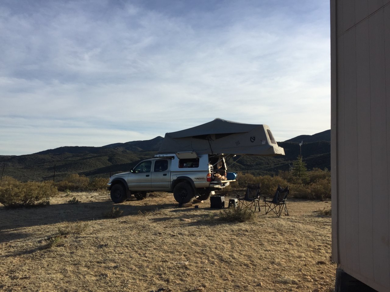

    IMG_4099.jpg Picked up our Tacoma about two months ago and the Habitat a week after that. This is my third Tacoma and my wife and I are coming from a JKU Rubicon. The Jeep got to be too small for us and we were tired of trying to get the cover on the rooftop tent. Don't have many pictures yet and haven't had time to build out the bed yet. Got our 50qt ARB fridge back there on an AT slide. Reused the Genesis dual battery kit from the JK. Tossed on an OME heavy lift with AAL and some FJ steelies. That's it for now.
    I don't want to muck it up too much here, I'll start my own thread elsewhere. We LOVE the Habitat so far and couldn't be happier with our decision to change platforms. Enjoying seeing why others have done with their Habitats.

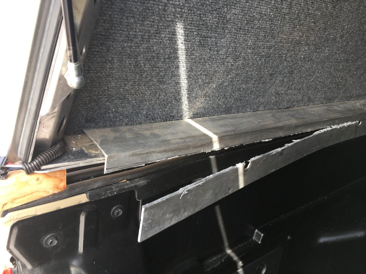

    Well I got impatient and didn’t wait for a reply from AT. After spending 30 minutes trying to remove the L-channel, I gave up on that method. That tape is tough stuff! I got about 10 inches free but couldn’t get any more.
    I went ahead and trimmed part of the channel off to access the utility track (for clamps) or make it so I can install a longer L-Channel.
    I was able to get my hands on one set of clamps. The clamps are a little cheap feeling in my opinion. I’m either going to get better clamps or as mentioned above, add a new L-Channel to the top of the current setup.
    Here’s a pic of the L-channel getting trimmed:

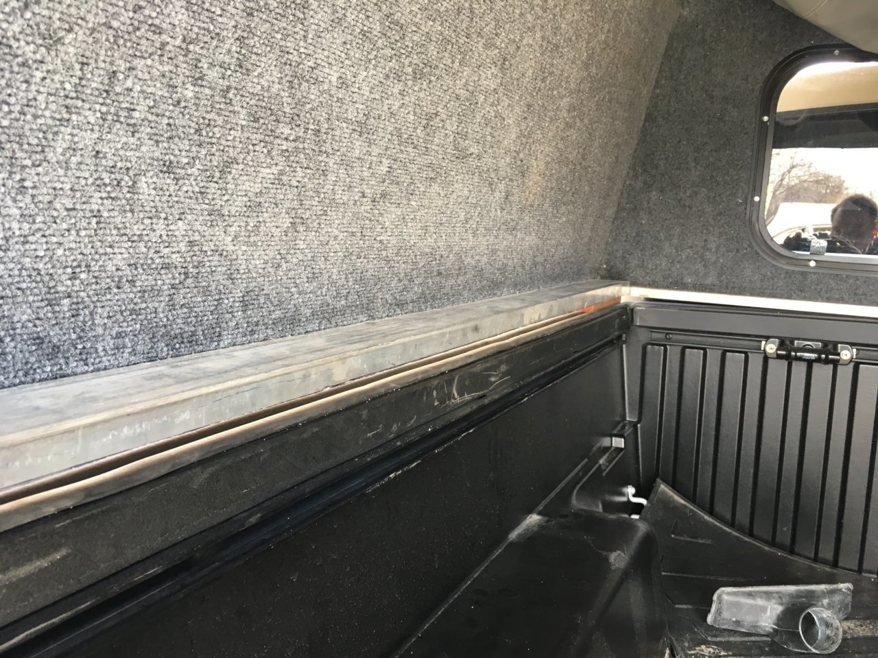

    I used my circular saw with an aluminum blade.
    Here it is trimmed:

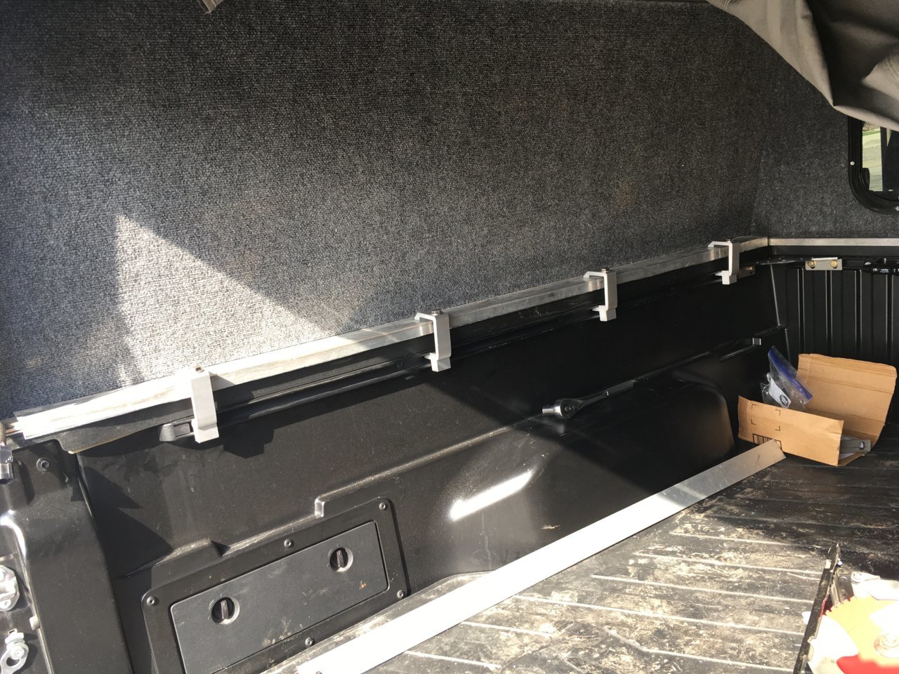

    I ended up lifting the Hab 2 inches to not cut into by truck bed.
    Here it is with the 4 clamps I have:

    Trim job looks good, well done. i see you have those ATH units like OP. I'm still waiting on the clamps to see them. was messing with mine today, utilizing the T-nuts and grade 8 bolts for length. the T-nuts seem to be good option, looks like i'm going to use at least 4 T-nut/bolts, and possibly use some clamps...
    Your idea about sourcing a L-channel with longer leg is good. The problem with that OEM L-channel is that it is dam wimpy. It will flex past 90*, i mean it opens wider than a 90* angle when stressed with the leverage that the open Habitat sleep platform induces. this a problem I have, and maybe no one else does. I'm going to use the L-channel, but I'm working on a 1/4 inch thick 12 inch section of aluminum channel to place in the crucial most forward 12-14 inches to augment. plan two bolts into utility channel through the extra piece. problem with the heavier gauge aluminum L section is it has curve at the inside angle, so does not fit flush on existing 90* L-channel. plan X is source a 2.5 inch wide 3/8inch thick plate about 14inch long to place between, such that vertical leg fits flush over the C-channel 'leg', and the gap made due to the inside curve is accommodated by the additional plate. I know, you'd have to see my drawing, and i don't have one....
    My main point though, is finding a 'square' L channel with a long vertical leg will be the crux, but that is a good idea.

    Yeah, square L-channel is hard to source. Adding the other backing plate or spacer behind the off-set L-channel is a good idea but starts to get pretty bulky.
    I’m actually planning on using the ATH stiffeners to mount a clamp to high stress front area. The plan is to drill a hole in the stiffeners and clamp from the steel plate. This will tie in the front utility channel as well.
    Finding an aluminum square tube might work to remove the inner radius of an L-channel but involves lots of cutting.
