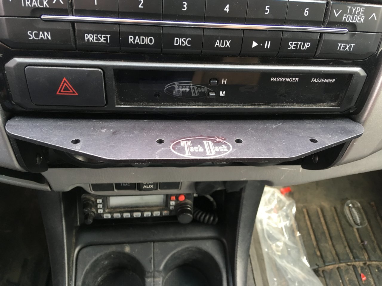

    Not Hab related, but my truck got its HD tech deck today.

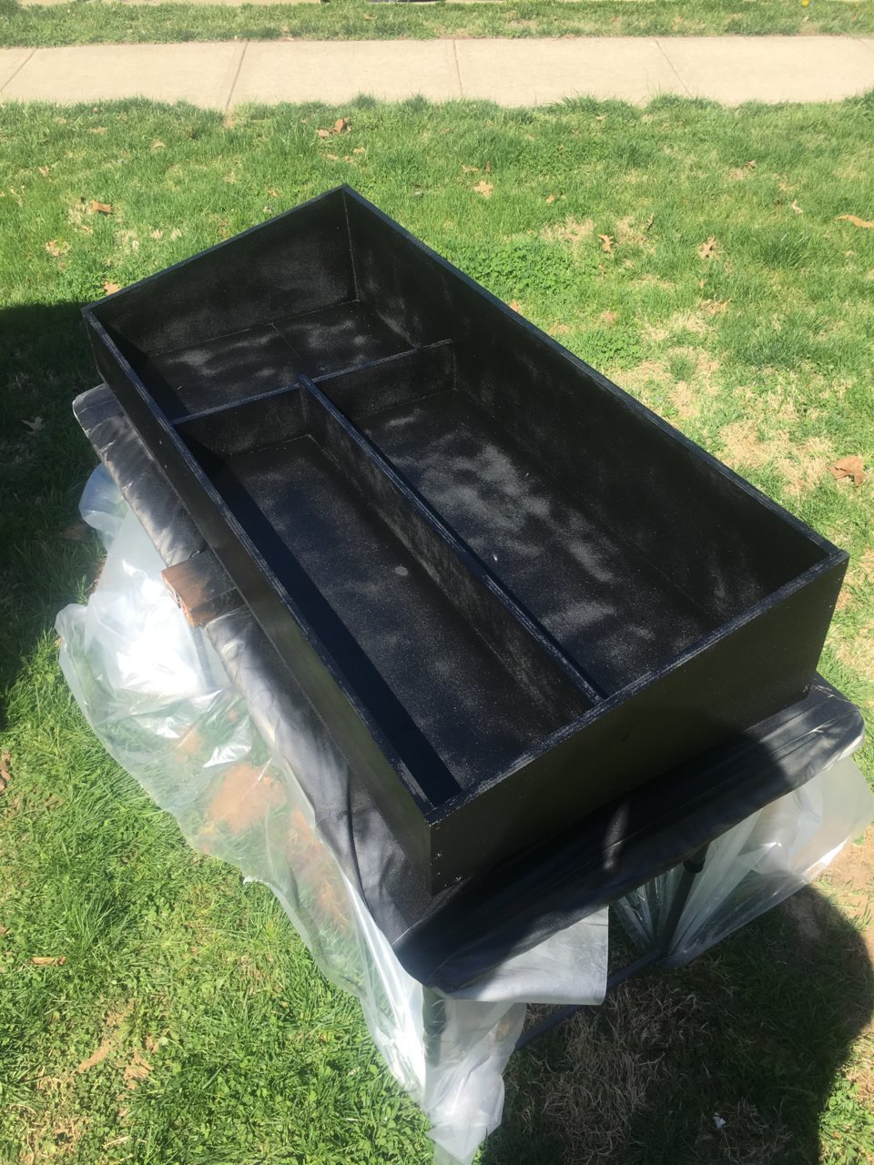

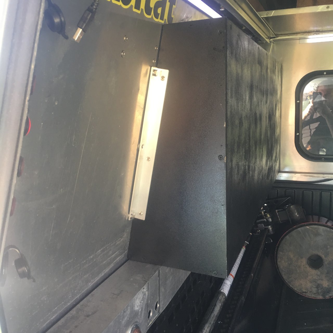

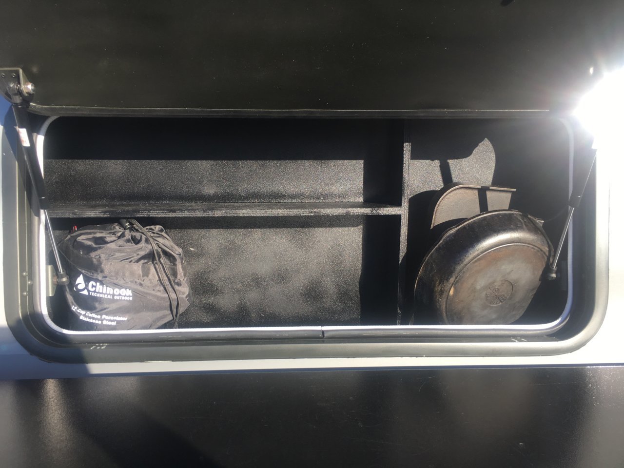

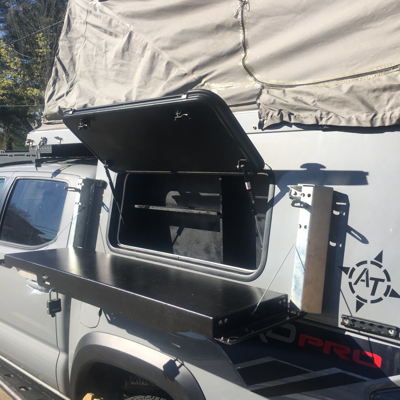

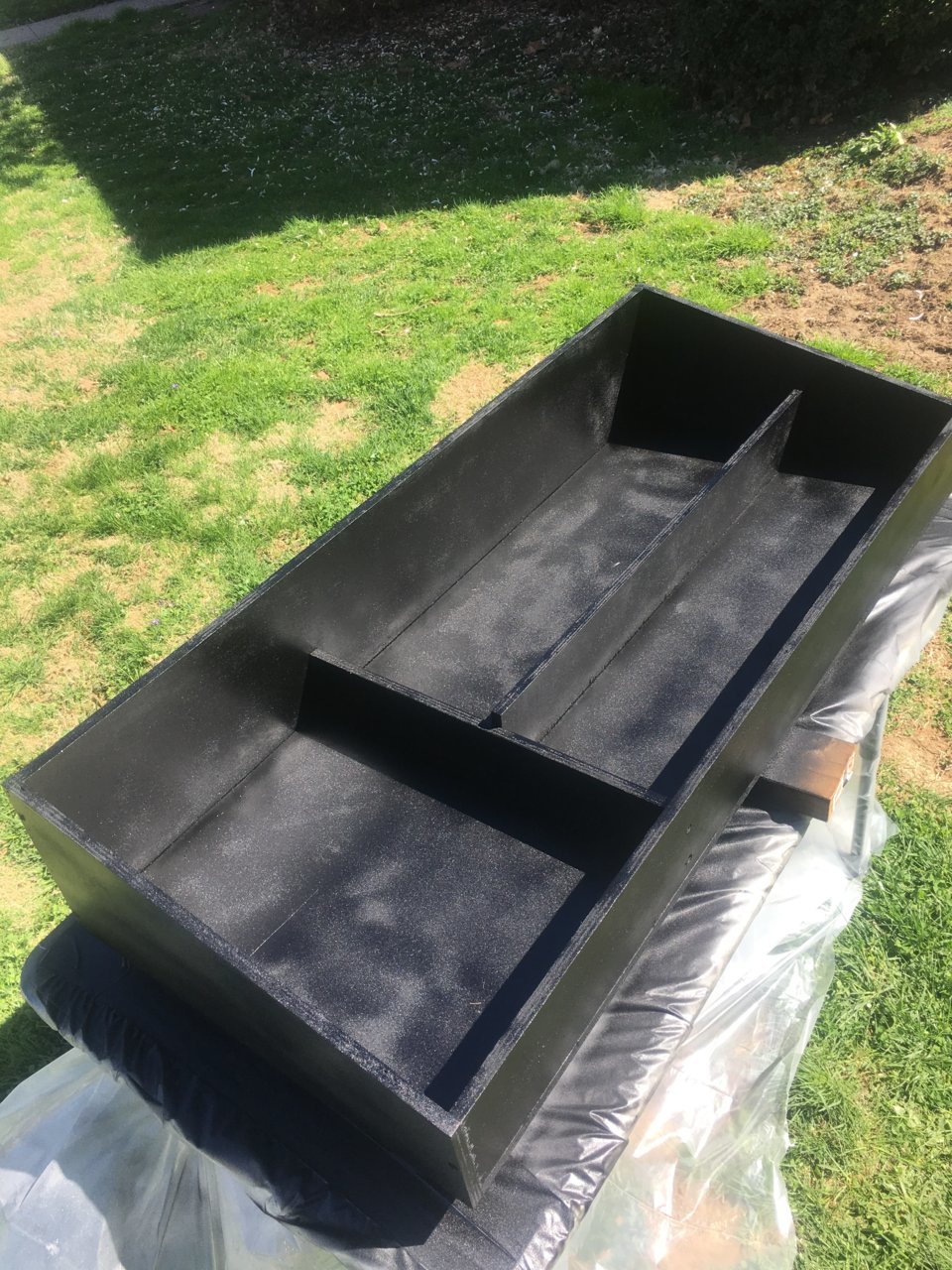

    Added the box. It’s going to be handy storage

    That looks perfect. Im sure it will be used quite alot.

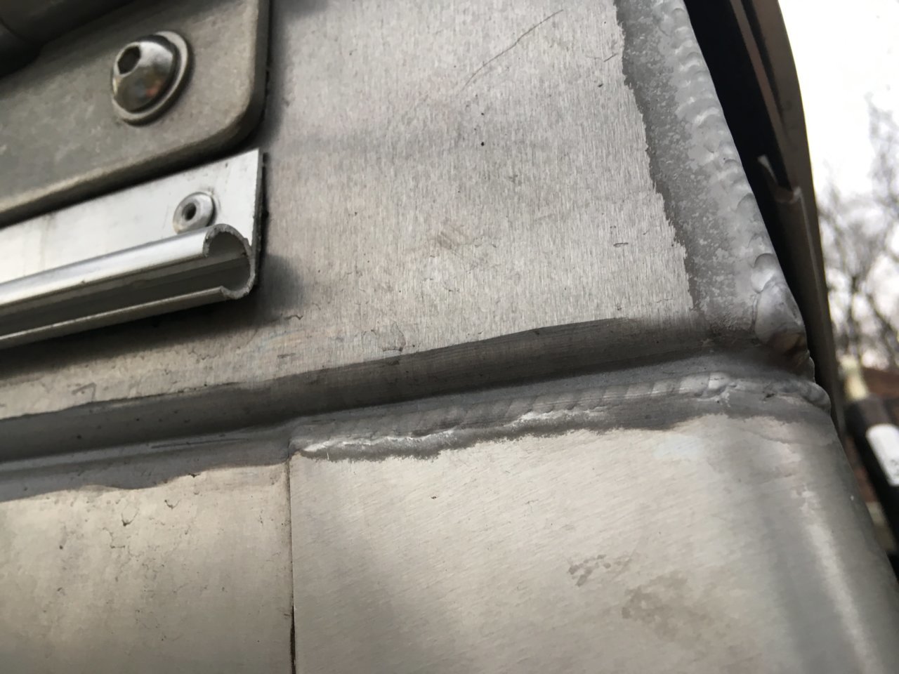

    ..i've got quite a few holes in the composite bed material, most of them plugged with caulking. the refrigerator slide platform is still bolted thru the bed x4 bolts, works good, no worries, about a 2x3 foot piece on floor. have minimal 'cabinet' and platform of plywood. i like plywood, but do not want to overdo it with weight. many many ways for dust and water to enter the bed and Habitat, i'm not too worried, just dirty. most recent i'm finding a puddle of water on the left rear corner of the Habitat shell mating section, near the hatch latch...thought it was rain water thru the latch, but taped it shut, still wet...curious...coming from the hinge area....

    I had this same issue and found the fix. I noticed the puddles at the rear corners, and immediately thought tail gate. Then found drips forming on he rear mounting bolts above the hatch. Thought it was my adding an awning welt there, but that was sealed at install.
    I put a bead of ultra gray permatex rtv in the gap between the Hab’s tent module and walls. No more intrusion. I’ll add a pic when I leave for work in a bit.
    On edit: 9E329E1D-C0E1-4973-B77C-9976EAAD7316.jpg

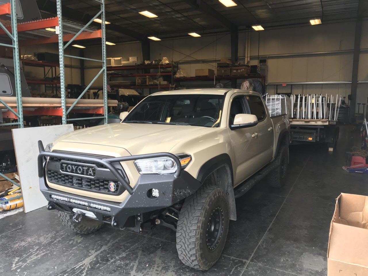

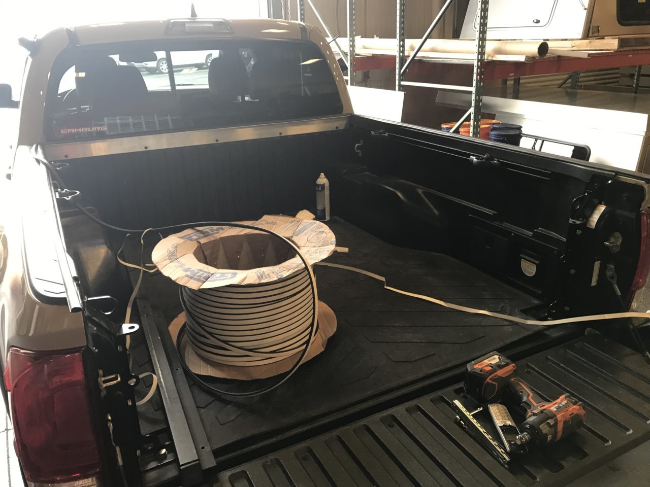

    Well this is going to be fun 88119DE1-50E1-487E-8A34-2DD932B72CD8.jpg 82F04CC2-AEC3-4C69-8532-633023890A42.jpg

    You're gonna remove the bedside caps right?
    EDIT: NEVERMIND, looks like you are having someone do it. thought you were doing yourself :)

    Is removing the bed caps the way to go? I’ve seen pix both ways

    I've always heard that the plastic bed rails' texture does not give a good sealing surface, which is why they pull them off.

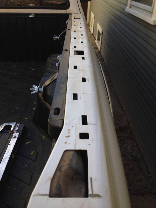

    Like Swiss cheese. I took them off to mount my WilderNest, similar reasons as the Habitat.

    I had my habitat installed the first of February 2019 by AT Overland. They said they do not (they used to but said it is better if you don't on the new Tacomas) and did not remove the plastic rails on my 2018 TRDOR. I have had no water intrusion because of the rails. They only place I have ever seen water is just along the top of the tailgate because it sticks out from under the habitat. I have a bedrug and added P shaped weather stripping along the sides of the tailgate (one piece on the body and one piece on the tailgate/ I also added a small piece at the ends of the bed at the top where it joins the habitat. We had a bunch of rainy days after the install and I've hosed my truck off many times and no rain intrusion. The bedrug is perfect in my opinion. Covers all seams where dust can enter except the tailgate top (now with my weatherstripping).
