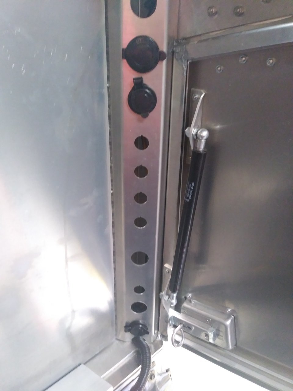

    Those should fit.
    I used these
    Blue Sea Systems 12 Volt Dash Socket https://www.amazon.com/dp/B001U4ZZPK/ref=cm_sw_r_cp_api_i_iBYSCbEQM310V
    Blue Sea Systems Dual USB Charger Socket https://www.amazon.com/dp/B0082CXEI8/ref=cm_sw_r_cp_api_i_5zYSCbXGXK6E5
    Rigid Industries 40191 Lighted Rocker Switch https://www.amazon.com/dp/B009NLMWT4/ref=cm_sw_r_cp_api_i_1yYSCbTN0VYFB
    Blue Sea Systems Mini OLED DC Voltmeter with 12V/24V DC https://www.amazon.com/dp/B01CZ2ZXKM/ref=cm_sw_r_cp_api_i_ZwYSCbTCESJQV

    Thanks these look like they would just pop in those opening on the side. Was curious if you ran ground from the battery or grounded to the truck and also the 3 pin design confused me will have to look over some videos how to wire those.

    Ground from the battery. If I could do it all over again, i’d Run a 6 AWG or 4 to a blue seas fuse block mounted to the Rear. With a circuit breaker in line.
    Bussmann CB285-120 Surface-Mount Circuit Breakers, 120 Amps (1 per pack) https://www.amazon.com/dp/B01G5WHSFQ/ref=cm_sw_r_cp_api_i_Fd4SCbKAH5WYS
    Blue Sea Systems ST Blade Fuse Block - 12 Circuits with Negative Bus & Cover https://www.amazon.com/dp/B001P6FTHC/ref=cm_sw_r_cp_api_i_gb4SCbGYBV3N7
    Edit: I ran everything in small wires back to the hood. In hindsight. I should have done it all local.

    The three pins are as follows. The gold is your ground, the other 2 are the physical switch for your hot. Basically run a positive wire to the first silver lead 1 on the back of the switch, run a wire from silver lead 2 of the switch to the load or light or whatever, then for the ground side, split the ground wire to a Y and run to the ground side of switch or gold lead 3 and the ground side of your load (Lights, accessories, etc. ) The switch has to have a ground pin if you want it to light up. Hope this helps.

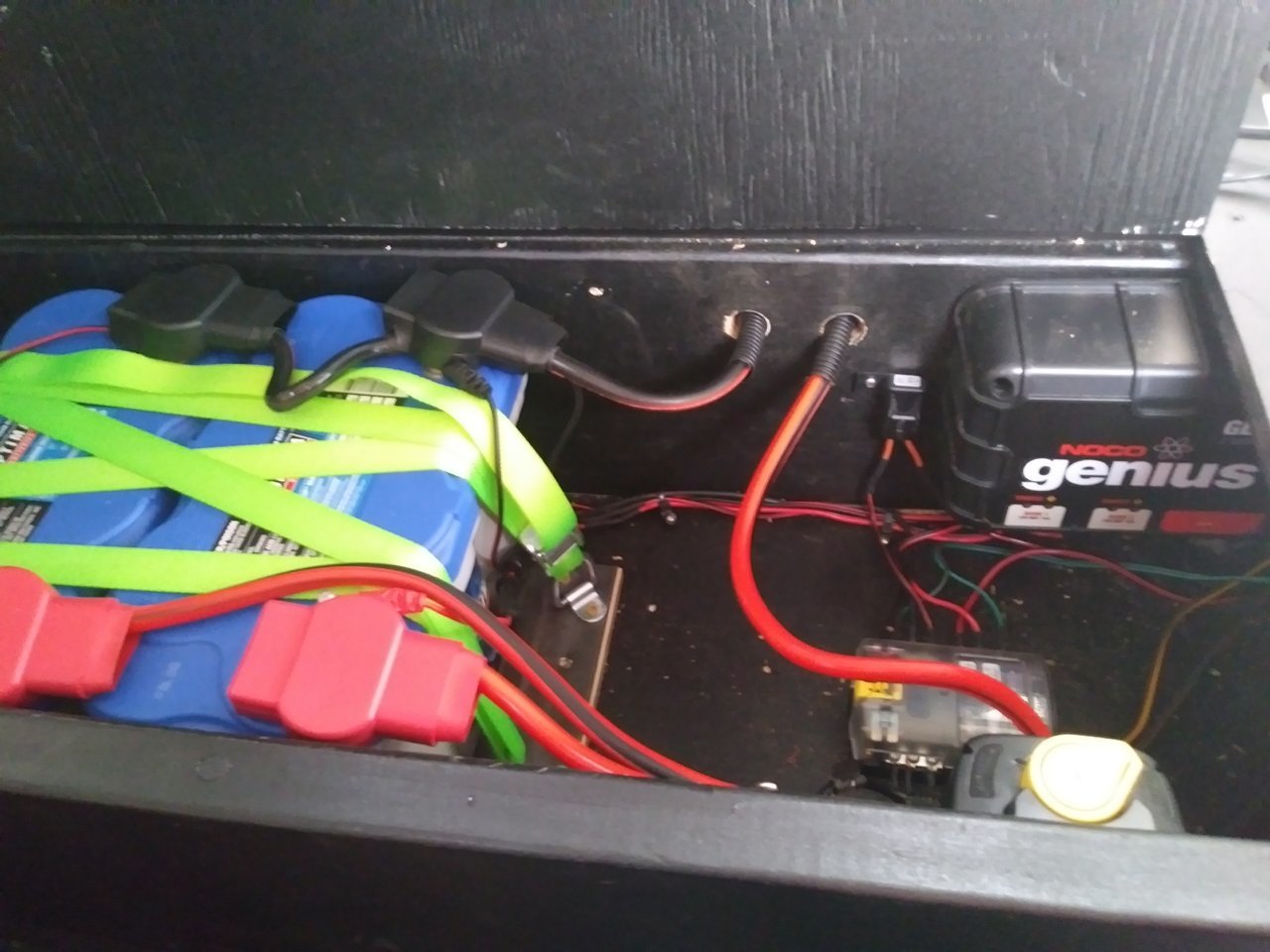

    I only ran positive from the truck battery, via HD jumper cable. Then grounded my stuff to a bolt on the top side of the frame under the passenger side of the bed. Made for a lot less big heavy wire to run.
    I also used a lot of Blue Sea stuff: ml-acr, fuse block, 12v sockets, usb, and voltage meter. Also a battery selector switch so I could manually select between my two house batteries, or shut them off completely and still run everything off the truck.
    Edit/note. Not a big deal, but I think it was the smart usb by blue sea that is 1mm larger in diameter than the other plugs, and wouldn't fit in the holes. I grabbed a wood paddle bit and reamed it out just a touch to make it fit. Still no clue why the difference in size, and it wasn't mis manufactured, the diameter was listed on the packaging that way.

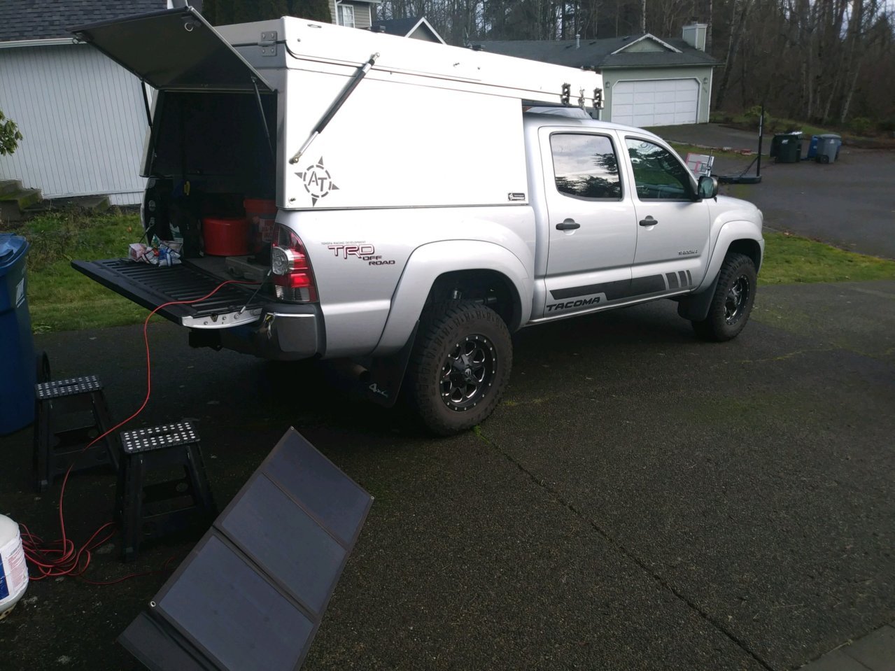

    I think that Goal Zero will probably treat you real well. Being it's lithium you probably have similar usable capacity to my dual 66 amp hour Optimas. (Dang I want me some Lithium batteries...)
    And I can't remember the last time I charged them off the truck. I just make sure they are fully charged before I head out and setup my 100 watt solar panel when I get there. I normally sit in one place for multiple days, and the 100 watt seems to keep up with my usage (fridge and recharging cell phones).
    I've done 3 day/2 night trips without using the solar, as well, and still had plenty of juice leftover. BUT, YMMV as I normally camp in relatively mild temperatures up here in the PNW, your fridge might be pulling more juice if you are camping somewhere HOT.

    I originally planned on getting a 200 watt hard suitcase style panel, but very glad I decided to grab this lightweight 100w folding panel instead. It's been plenty so far, and it's WAY smaller/lighter.
