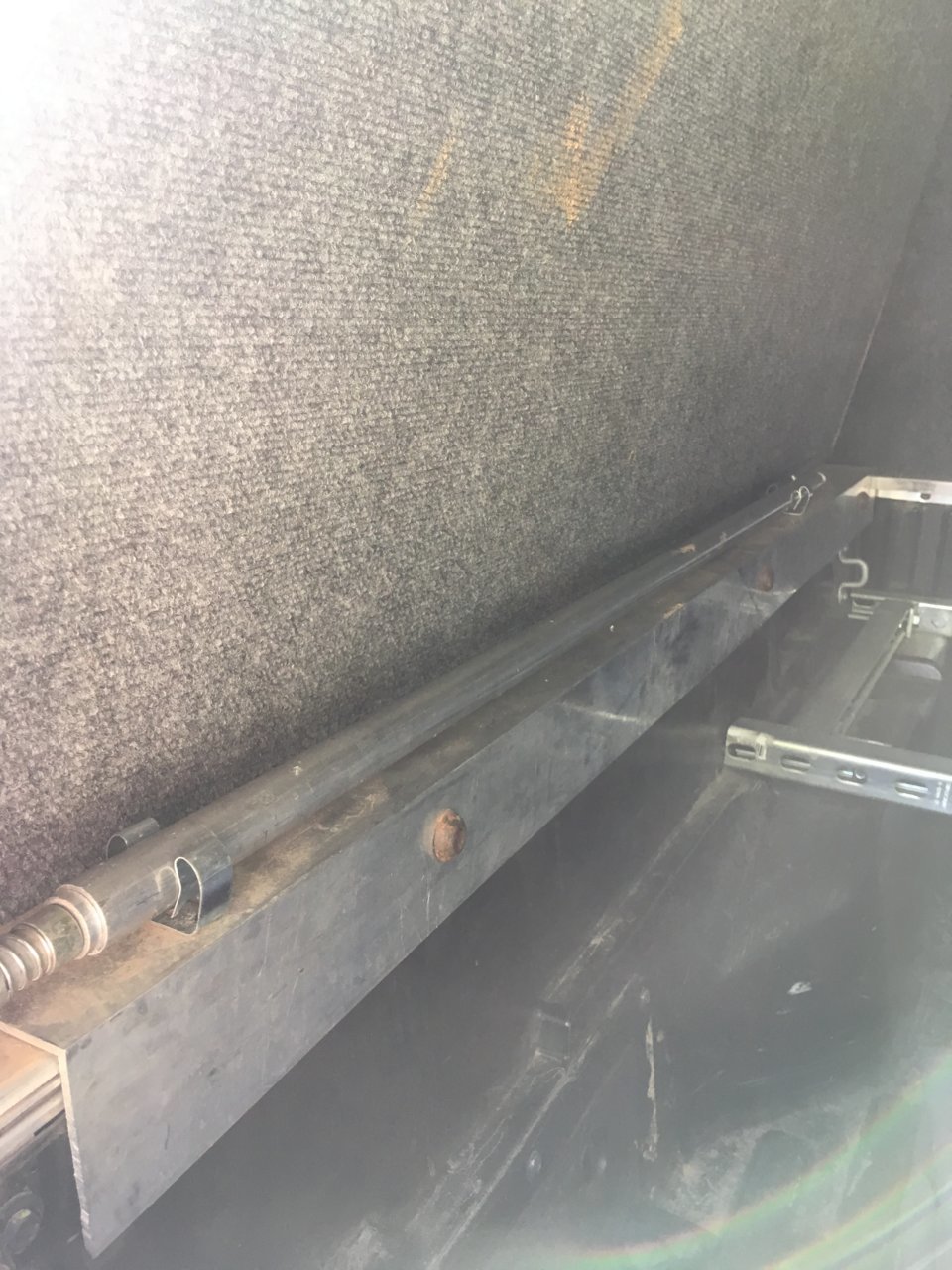

    I use stainless steel broom holders from the hardware store. A little VHB tape and two per side on the ledges.

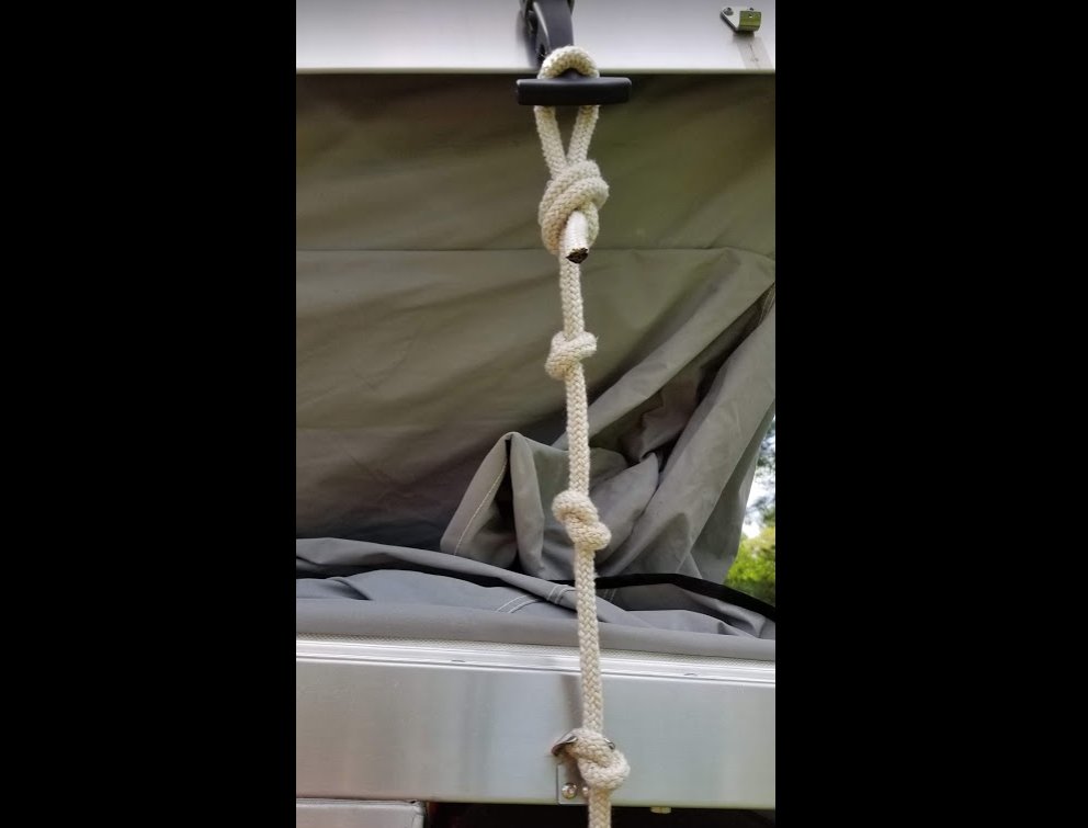

    Saw this somewhere else and copied, sorry I can't remember who it was to give them credit, but works great, made one for each side, I think it is 3/8 braided.

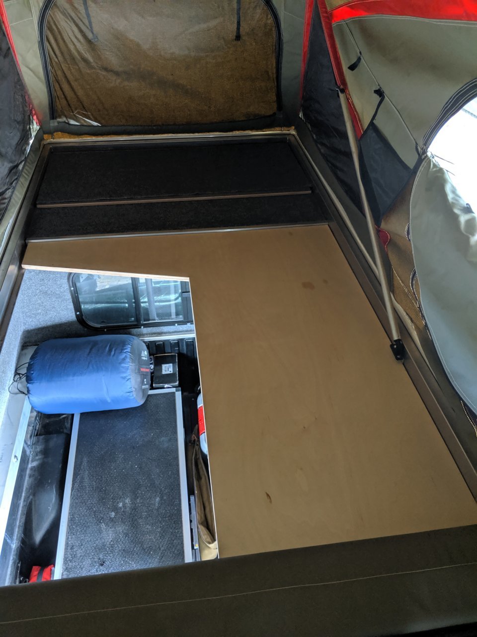

    Finally making a fill panel. Took some inspiration from @tacofort
    Planning to carpet the top and I have some l-track that I can mount on the underside.

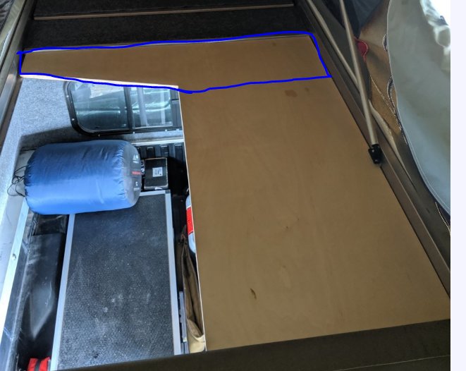

    That looks great. What thickness on your plywood? I have the rectangle panel that came with the Habitat and want to make a plywood piece that will fill the gap (pretty much the section outlined in blue below), that has a lip under it to rest the standard panel edge on. That way I can use it in the normal position, take both pieces out, or use the whole thing as a table. Mine would be the flipped version of yours, as my fridge makes a perfect bench on the passenger side.

    I used 5/8" birch, could probably do 3/4" though, but the 5/8" feels solid enough for me. I'm going to add extra reinforcement anyway which should eliminate bending.
    I don't trust myself enough to make something like your talking about with a lip for support.
