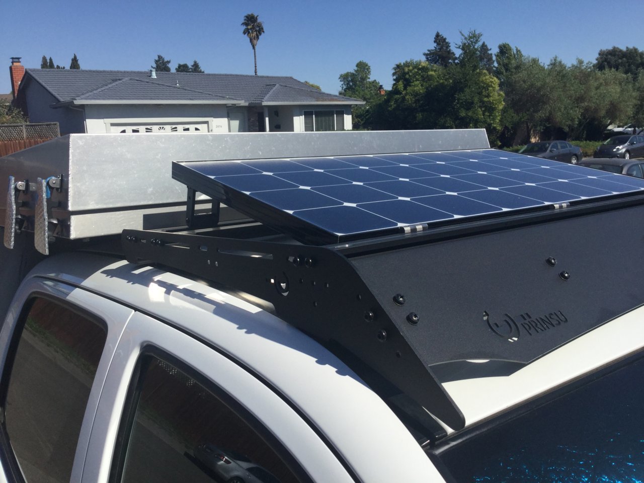

    got the PV hard mounted finally, waited a month and a week for a few 8020 parts. one panel on the Prinsu rack. i reinforced internally all four corners. has five points of mechanical connection to the rack, three of which are hinges. decided to mount in fixed position rather than adjustable tilt.

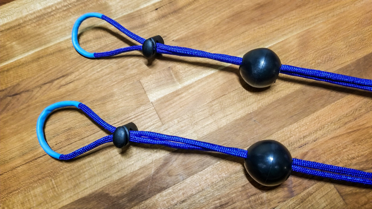

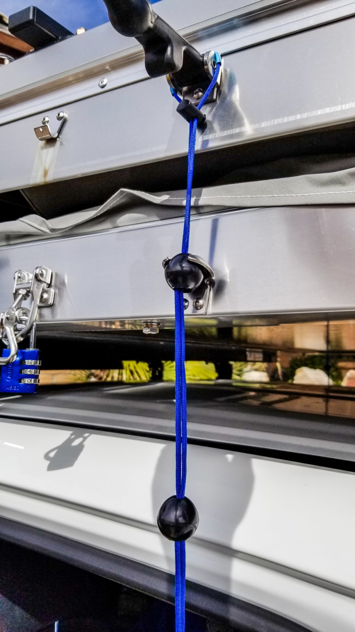

    In Feb the day after I picked up my habitat, I made the paracord closer with the hard balls from the bungees. Just bought a pack of several ball bungees on Amazon and 6 ft of paracord. This is by far the easiest way to close the habitat. I put a barrel lock at the end of the loop so I can tighten it to the habitat before I flip it over.
    Try the hard ball and paracord method and you will never go back to a clamp.
