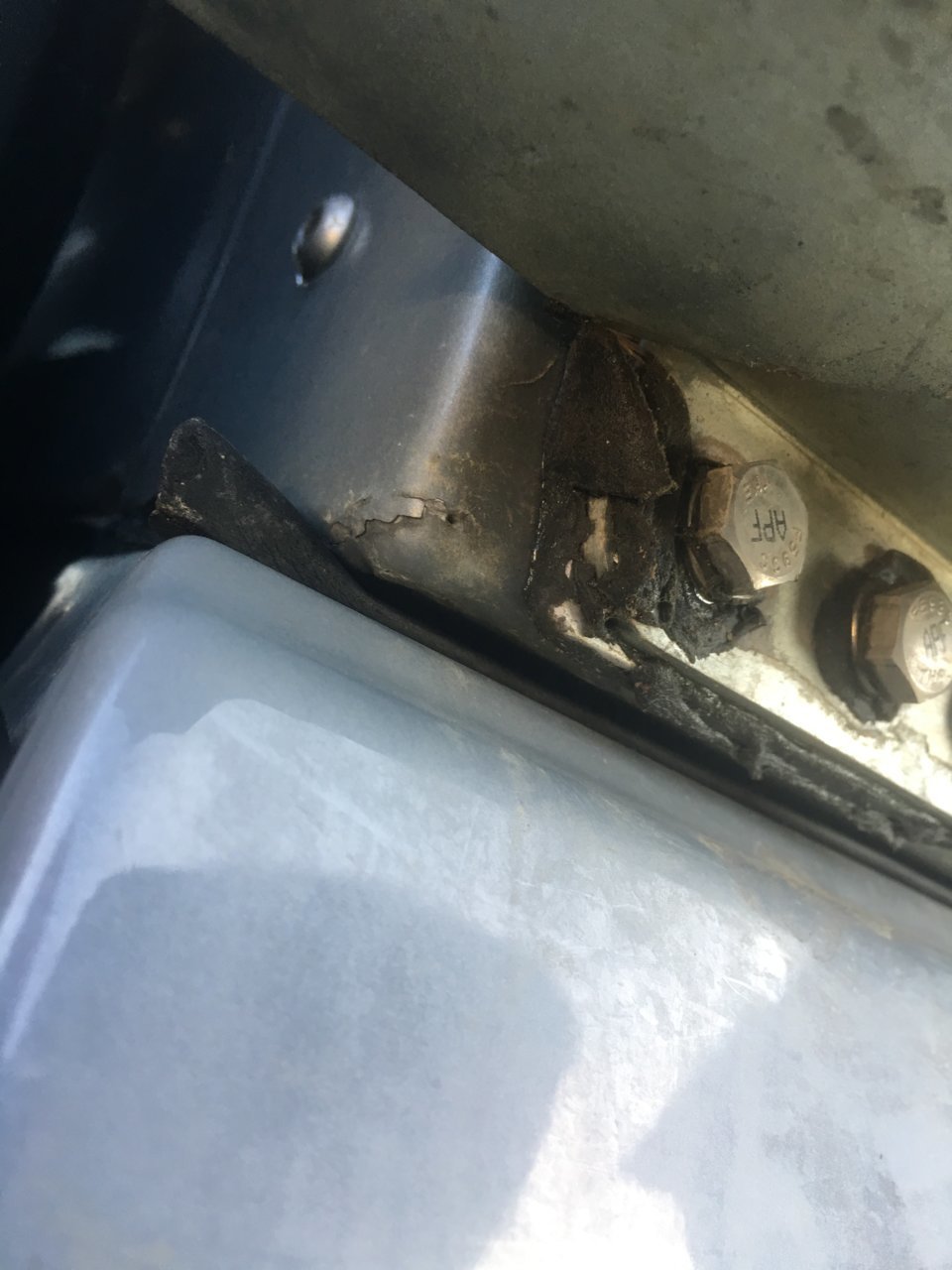

    Finally remembered

    ...so what is your 'take' on this?

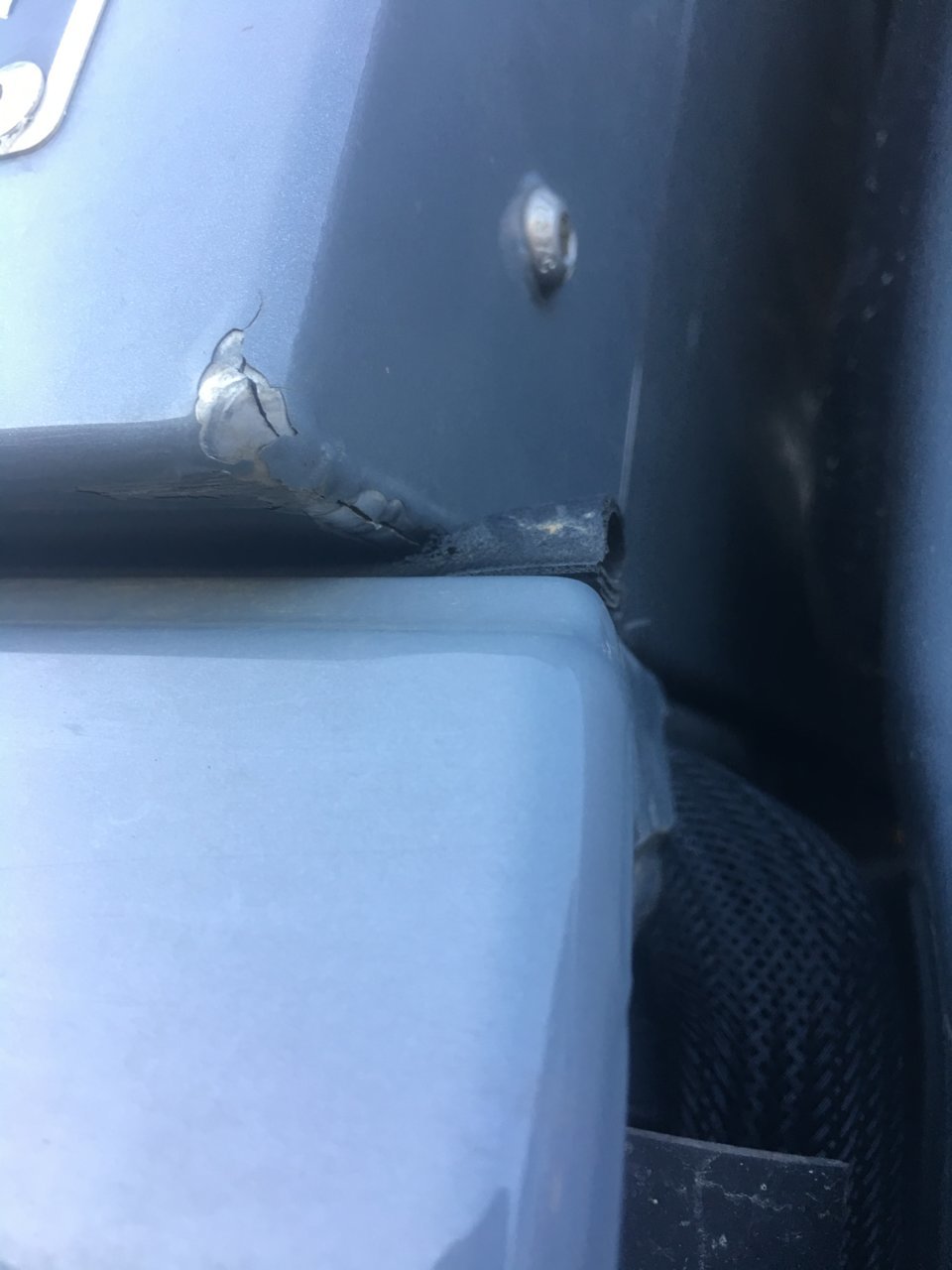

    Thanks, Looks very similar to mine on passenger side
    Have you asked AT about it? I have been meaning to send them an email just to see what they say.

    my thought is with a bunch of swaying flexing occurring to that corner, we are seeing fatigue cracks on the front corners. The rear are radiused and have much more stiffness to deal with the door and pivot point. Likely, I'll add a reinforcement to the corners and bolt them down.

    ..been thinking vertical force from leverage applied by open shell.
    so your thought of sway/flex while vehicle in motion?...twisting of frame, bed, Habitat..

    looks like fatigue cracking and flex to me, however it is caused, lol.

    Yes that indeed is caused by fatigue which is a direct result of constant flexing. Drilling out the ends of the crack is the 100% correct thing to do to stop the spread. We use .090 thick 5052 aluminum that handles flexing and bending well. The welds however will be a harder material which due to the hardness are more brittle. We have seen this once before. With over 300 Habitats in the field and the abuse that XOverland has dished out on theirs without issue, I wouldn't say we have epidemic problem but rather an isolated issue.
    We know that the Tacoma has a very flexy bed and I am wondering that since both of you have experiencing the crack at the welds have 5' units, it may be a result of the increased fulcrum of the longer cabover. We do advise bed stiffeners now specifically for Tacomas using Summit toppers because of the increased cabover on that model. We may need to do the same for all Tacomas. I'm going to spend some time this week to work on gusset fix for your units that you can easily install to reduce the flexing you are experiencing.

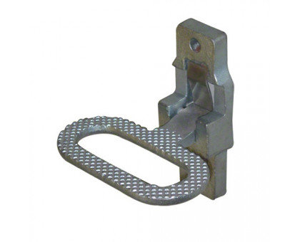

    The idea is to make it available as a retro fit. We have fitted steps like that at the rear corners bolted through the corner stiffener that is behind the electrical raceway.
