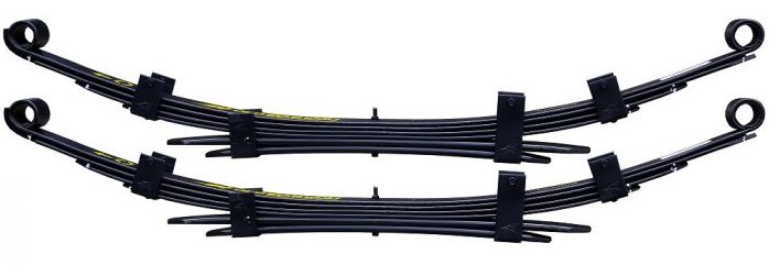

    Anyone run Dakar HD EL096R with D29XL and Air Bags?
    UPDATE on my thought process...
    I dont understand the double overload. It seems like the smaller bottom overload is acting more of a block. So I would rather remove the smaller bottom overload and add the D29XL leaf to give more arch. Trade-off that provide a softer right and theoretically, more support.

    You shouldn't get a softer ride by removing the overload spring/springs unless you are constantly riding on the overloads. In normal use you should not be using the overload, meaning they would not stiffen up your ride. If you are riding on the overloads all the time, you need beefier springs. I'm assuming the pic below is correct, with the two overloads. Even these have space between, so you'd engage the longer one first, when maxing out the above leaf springs, then engaging the final bottom leaf when maxing out the above overload. Does this make sense?

    exactly! thus, the bottom overload is basically acting as a block that provides lift. I would rather add the D29XL and get that lift from the arch than the bottom overload. The softer ride is a potential byproduct.

    I guess that makes sense as long as you know you'll NEVER need the overload? I'd kinda think of it as an emergency backup for the one time you needed to pull a trailer or completely max out your rig for some reason.
