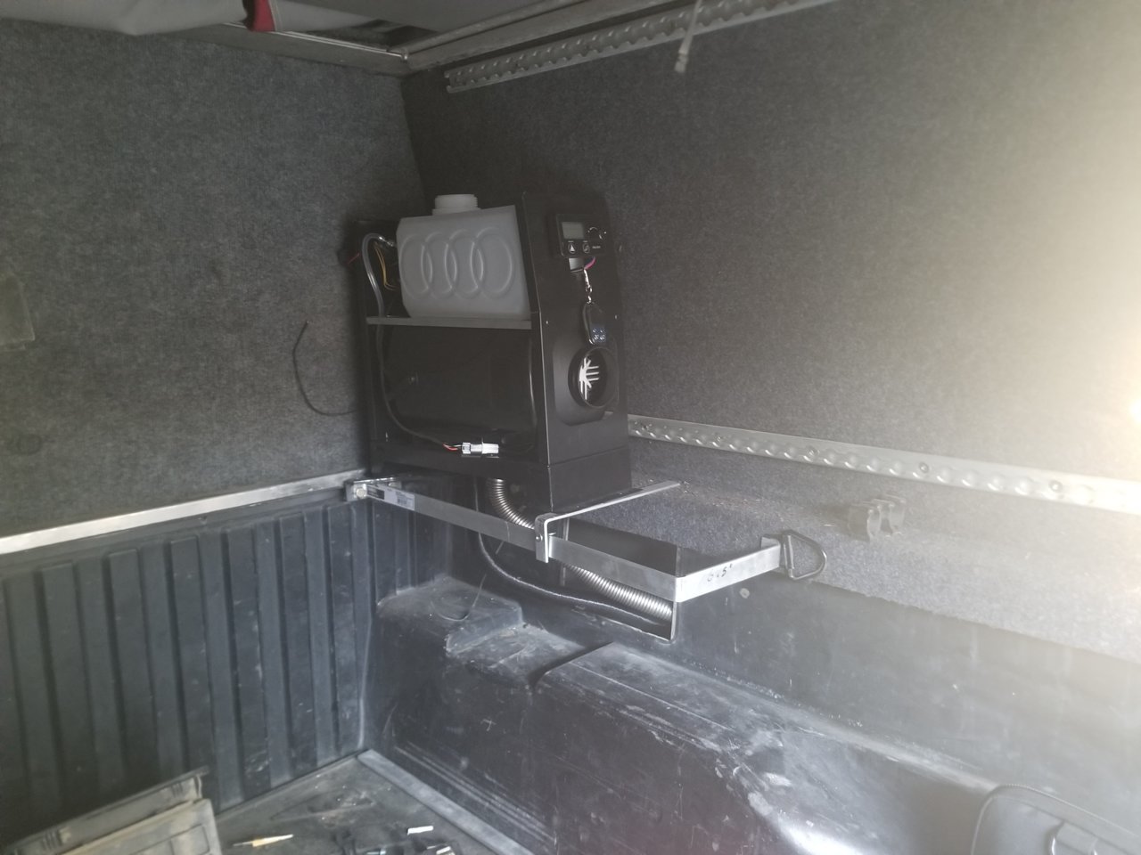

    Should be installing today... my plan in my head is too vent using the removable cubbies in the bedside. Don't see why I can't make that work although I haven't seen anyone else do it so I'm not positive.
    Didn't want to run the fan and pump for the heater off my starter battery so I also got a renogy 100w wanderer solar kit to install, and will be putting a deep cycle battery somewhere in the bed as well. The designated heater turned out to be a slippery slope I guess, as now that I have solar and dual battery I will likely be putting a fridge back there.

    The removable cubby up over the fenderwell is where I drilled to run my heavy wiring in for my battery system. Only place I drilled so far. My only suggestion/warning would be to make sure the exhaust can't get trapped under the truck and/or bed and seep back into the Habitat.

    Just a note, I believe starting in 2013, those cubbies were removed. The only reason they were there to begin with was because the tooling for the bed picker robots needed a place to pull them out and place them onto beds for fitment on the assembly line.
    They upgraded the tooling so they wouldn't be there.
    Another note, I personally think it's a better idea to just put holes in the bottom of the bed. The exhausts need to always be tilted downward so condensation can't build up, if you're parking on sideways incline, unless you build it with a lot of angle it might have problems. You should also make a consideration on how to protect the exhaust and intake piping in case you drive through mud. Maybe install a push rod to clear it out in case it gets covered.

    I have a 2006 so it has the cubbies and I never use the ones above the wheel wells which is my initial idea. I also will never be running heater on an incline as the only time i will be running it is when the habitat is popped and we always level truck for that. Im leaving early A.M. tomorrow and the thing hasn't showed up in the mail yet so Im hoping it gets here soon and my install today will likely be a rough one to make sure everything works ok. I will have to look into exhaust routing requirements but I don't think the angles should be a problem with how Im planning to mount it. Again this is all just in my head at the moment and things always seem to change when it comes to actually installing stuff like this for me, I appreciate the thoughts and will definitely keep an eye on the mud situation. I had an idea to tie in the exhaust to my trucks exhaust pre-muffler to keep some noise down but was kind of worried about the movement in the system creating problems.

    If you can weld or have a friend who can, I'd do something like this:
    The exhaust hose would go in from the diagonally attached one. The top would have a screw on endcap with a plunger on a spring loaded rod through the end cap. Then I just need to push on it to clear mud before I startup the heater.

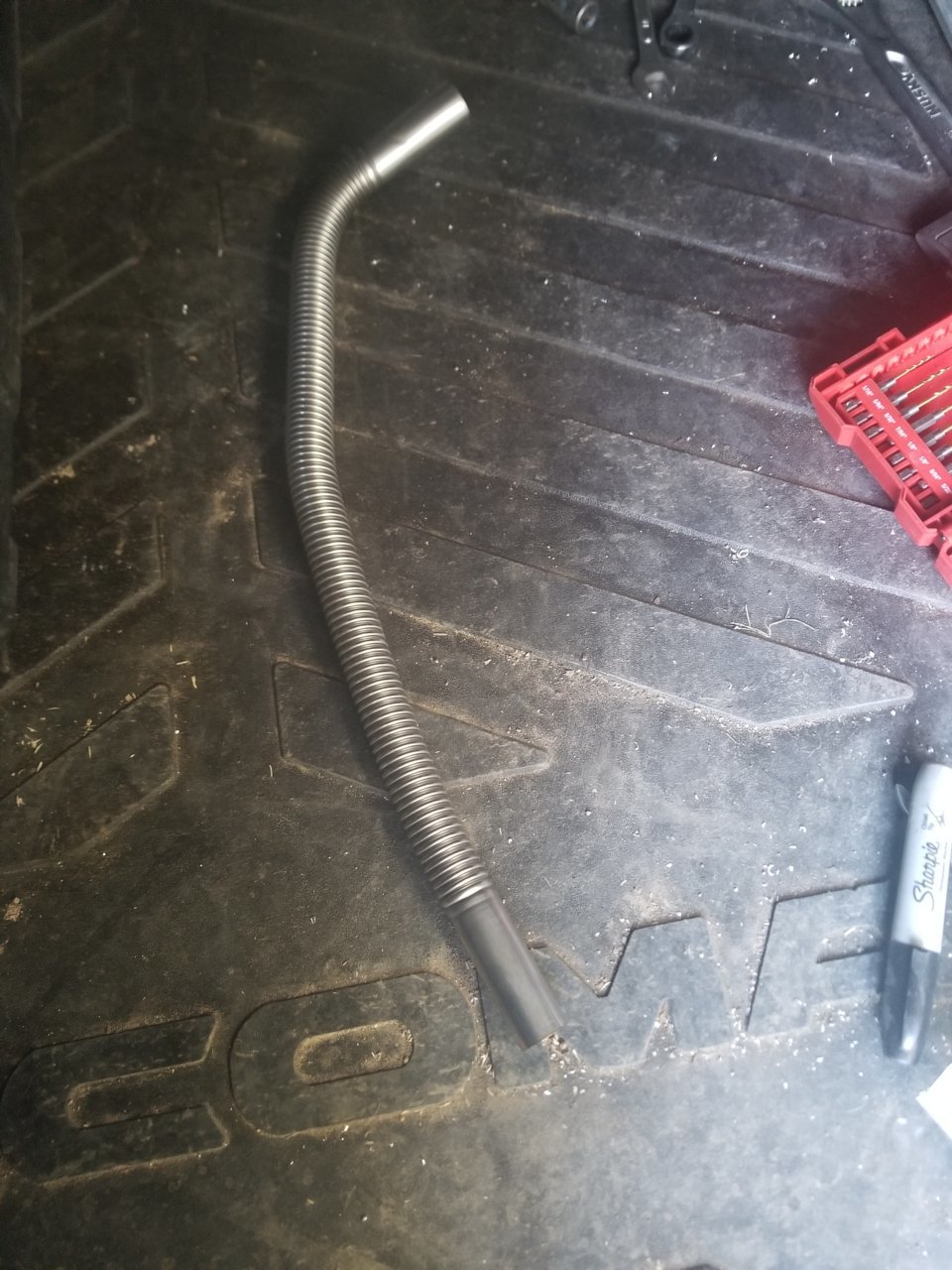

    Going smoothly so far.... working on installing battery underneath, more bracing, need to make fill plate for cubby hole, and I'm going to need a longer exhaust hose it looks to be about 7/8 ID any one know where I can pick something like that up?

    Santa Clara County
    '12 TRD Off-Road 4x4 AC V6 6MT
    Adventure Trailers Atlas, Demello Sliders, BAMF Skids, PelfreyBilt Bumpers, SCS Ray 10
    https://www.aliexpress.com/item/4000571196469.html?
    give this a shot.
    otherwise there's the Amazon one from eberspacher.
    https://www.amazon.com/Eberspacher-Webasto-Exhaust-36061296-90394a/dp/B07S84LB7Y/
